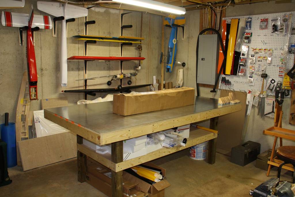

I'm going to do something I thought I'd never do...post pictures of my shop. I'm sorry to say that I have this trendency to not want to put everything away, resulting in a real mess over time. Lately it seems I spend 1/4 of my shop time looking for whatever I need at the moment. Enough is enough. Now you can almost eat dinner down there.
I finally decided to clean the shop, (with the help of my dear wife-Penny). We spent five hours down there not only cleaning, but installing new shelving etc etc. The reason I decided to clean the shop, (other than it needed to be done), was that it is a kind-of tradition when I start a new project...in this case a very special project.
Let me point out a few features visible in the pictures. Kevin Clark, (Pettern flyer 76) built me a building table identical to the one he used for the King Altair build thread. Things are held into place with magnets that attach to the 4X8 piece of sheet metal on top...really neat. Hanging on the wall behind the table is the original thick wing designed for the Taurus II, (it looks even thicker because of the photo angle). Above the T-2 original wing is Ed's last airplane...the attempt he made to get back into the hobby in his 80s. It was a metal plane with a modern proportional radio. The plane is totally ready to go, but was never flown. I bid for it as part of Ed's estate from Chuck Noble.
To the left of the wing and metal fuselage is the "unfinished" Taurus fuselage built , (presumably ) by Ed, and part of his estate. It is extraordinary workmanship, and light as a feather. The elevator surfaces were sewn in. The stab is the same stab as the Taurus 2, but the fin is thick. I believe it was an additional attempt by Ed to increase drag, that he abandoned in favor of the T-2 with the traditional fin. The wing intended for this fuselage is for a Bosch airfoil, so I believe that in spite of the sewn surfaces, this was a new fuse than the T-2. I have primed the fuse, and done the sketch for the classic color scheme.
By the way..on the table is a box from Jeff at Home and Hobby Solutions. The box contains the parts for the SIMLA PROTOTYPE. The plane built by Ed back in 1965 without plans now has been re-created as a laser-cut kit. After a lot of care and work by several of you from around the world, (you know who you are), this kit prototype is the tangible result of our labors, and we believe it is as accurate to the original as can be humanly possible after 45 years and lacking any plans or written documentation.

I've already had a few nice comments about the building table. Kevin Clark has one, and I was able to talk him and his father into building me one, (for a price and some goodies). Let me answer some of the specific questions received thus far.
The table...(see the attachment below) A nice feature of the table is that the top can be lifted off and transported, and the rest of the table disassembled and reassembled elsewhere should it be necessary. The table is build of plywood. It is covered with a 4X8 piece of sheetmetal. Due to the fact it's not marine plywood, there is a small amout of natural "bowing" in places, so you need to go all over the structure with a level. Small shims are required here and there under the metal to get the building surface itself as absolutely level as possible, but once it's done, you're ready to go.
The ply upright pieces were made by Kevin in different heights. They are held in place on the sheetmetal by four magnets bolted to the plywood...very nice, and works great. They will not go anywhere unless you lift them off.
The magnets were obtained at http://www.magnetsource.com/airfieldmodels/ They are easy to chip, and are protected by the metal sandwich. They are also fun to play with if you're bored.
The wing tube is indeed a 1 inch tube, (outside diameter). I don't have the source, but I will find out and post. Maybe Kevin will answer that one.
