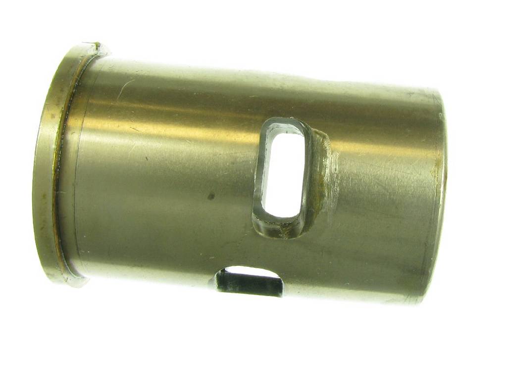

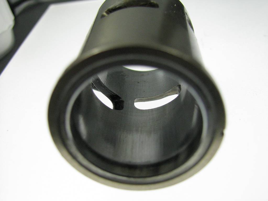

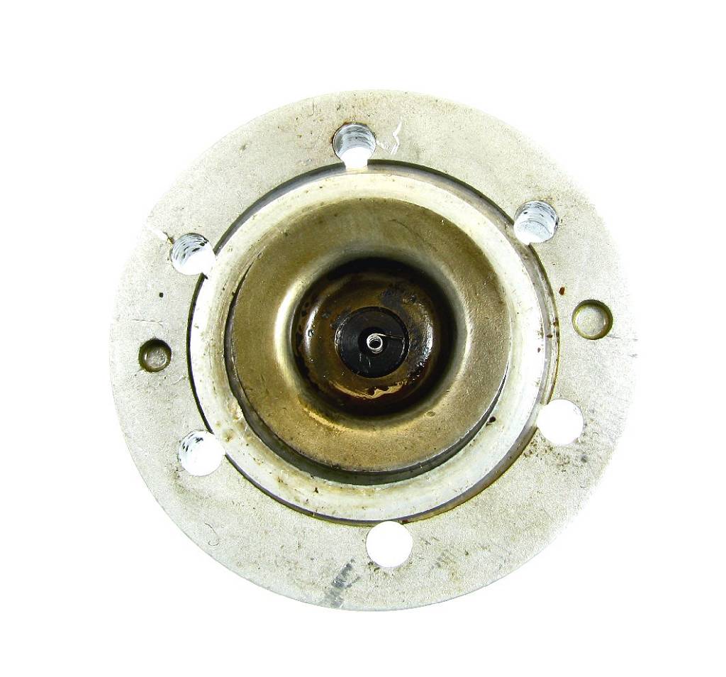

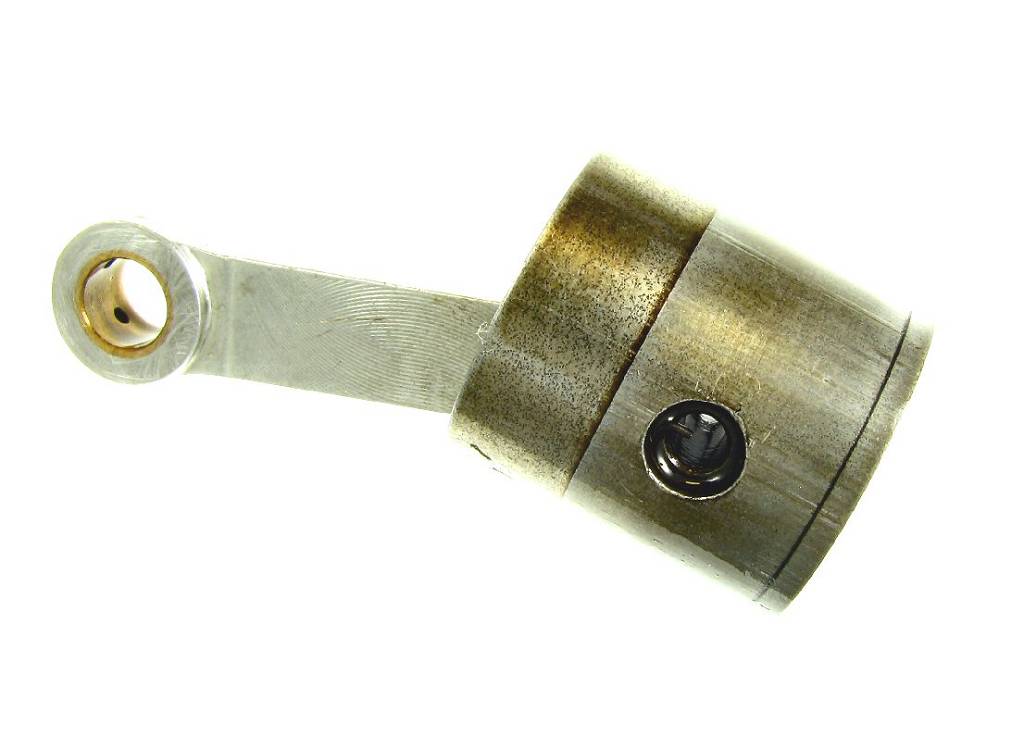

I had the plane on a stand inverted so the engine was up-right, full tank of PowerMaster 10% 22%oil, new K&B 1L, APC 12x9, full length header and some carbon fiber tuned pipe.
Once the engine was primed, it took forever to start (as it did with the original pump and carb), spraying a lot of fuel out of the carb. Once it finally lit, I went to full throttle to set the high end needle. I didn't tach it because I could not get a consistant rpm. I could adjust the needle and set it a bit below peek (about 1 turn out), but after 10-15 seconds it would start surging and sometimes just quit. Low end was a mixed bag of just quitting - couldn't tell if it was loading up or leaning out.
I noticed the carbon pipe was comming apart at the "muffled" section so I removed it and installed a Macs muffled pipe off my SunFli. Same odd running condition. I even ran it without the pipe and header. Wow was that loud and messy! Still running odd...and inconsistant.
I decided to pull the engine and take it apart.
Looks like the previous owner did some grinding on the intake and transfer ports. Can someone take a look at this work and tell me if these "modifications" have ruined the liner?
Also should the knotch in the piston face front or back?

Old 08-24-2011 | 05:40 AM
Joined: Apr 2006
Posts: 1,698
From: Carrollton
Default RE: OS .61RF-P Help!
ORIGINAL: AllTheGoodNamesAreTaken
If all else fails, I'm pulling it and installing a brand new YS .61 AR.
Hey Jeff,
I think it's about time you put that OS asside for a paper weight and do what you said in your original post. Put your YS in the Summit and go fly the crap out of it..........
David
Jeff, to the front, opens the intake port.

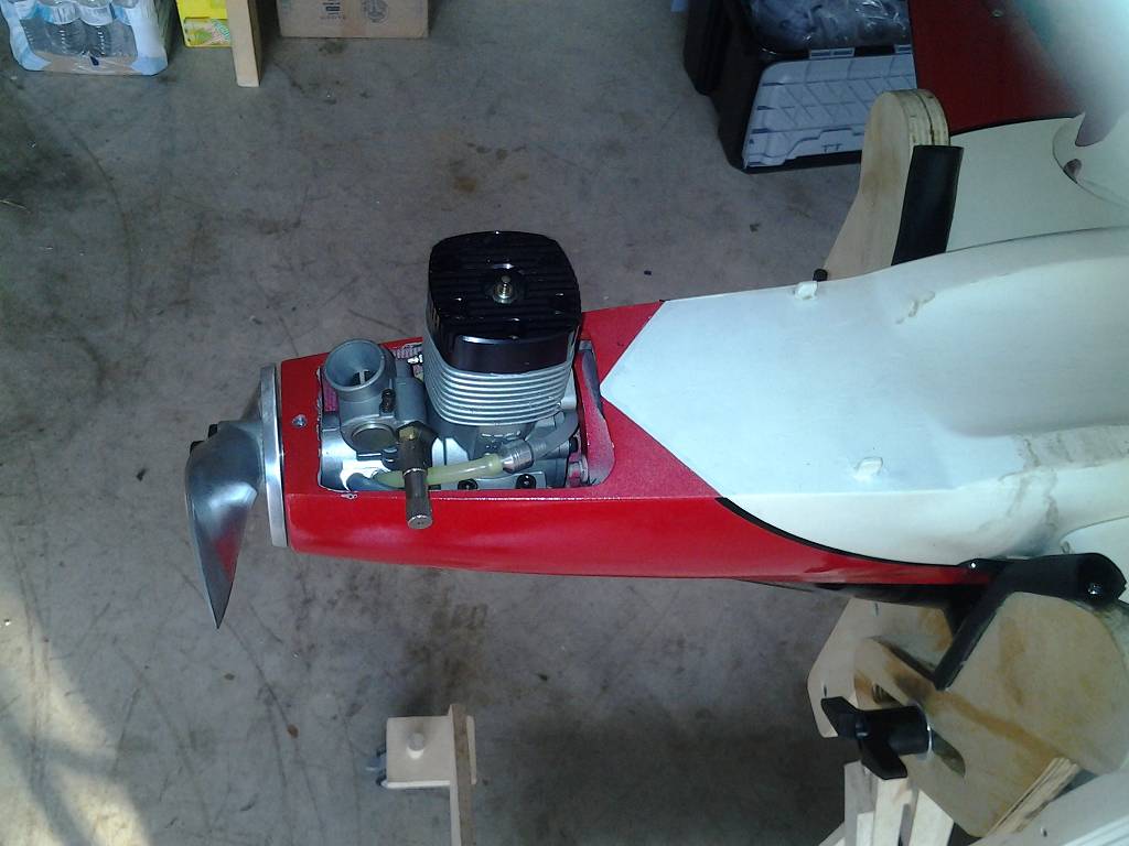

ORIGINAL: hrrcflyer
Hey Jeff,
David
David, It's already installed... Just waiting on a header and prop adapter.
That's what I thought. At least that was correct. What about the "Modifications"??? [&:]
There's also a 0.0150" / .38mm head shim installed.
Old 08-24-2011 | 06:07 AM
pitstop000's Avatar
My Feedback: (26)
Joined: Jul 2008
Posts: 1,019
They were trying to do some port flow work, crude though.
Old 08-24-2011 | 06:33 AM
My Feedback: (121)
Posts: 2,313
Received 40 Likes on 39 Posts
From: glen allen, VA,
Hi Jeff, good decision to go with the YS!!!!
Your OS seems pretty 'F' ed-up to me []. If you want to keep playing with the OS, I would try running it with a stock 7L (non-pump carb) to determine if the performance modifications are working or just ruined the engine. If the engine won't run reliably/consistently with the non-pump carb then it has become a paperweight [:@] - sorry. If the engine runs well on the 7L carb then you need to replace the pump or pump and carb. I've never been a big fan of the 4-nipple pump/2-nipple carb - too much plumbing and I don't think that much fuel gets returned anyway. The Hanno pump/carb works great if you can find one. The OS pump assemblies will last for a very long time if kept clean and no 'adjustments' are performed. There can be wear in the carburetor, though most commonly it is the needle that wears.
Have fun with the Summit!!

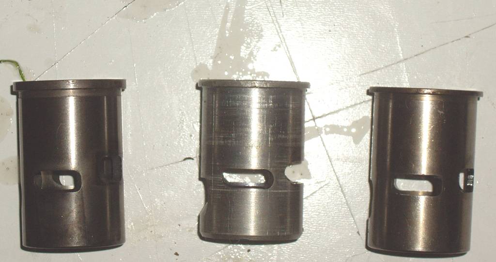

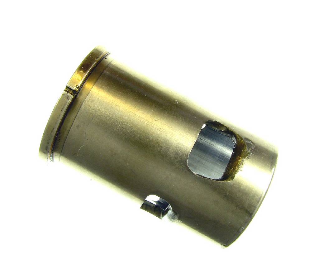

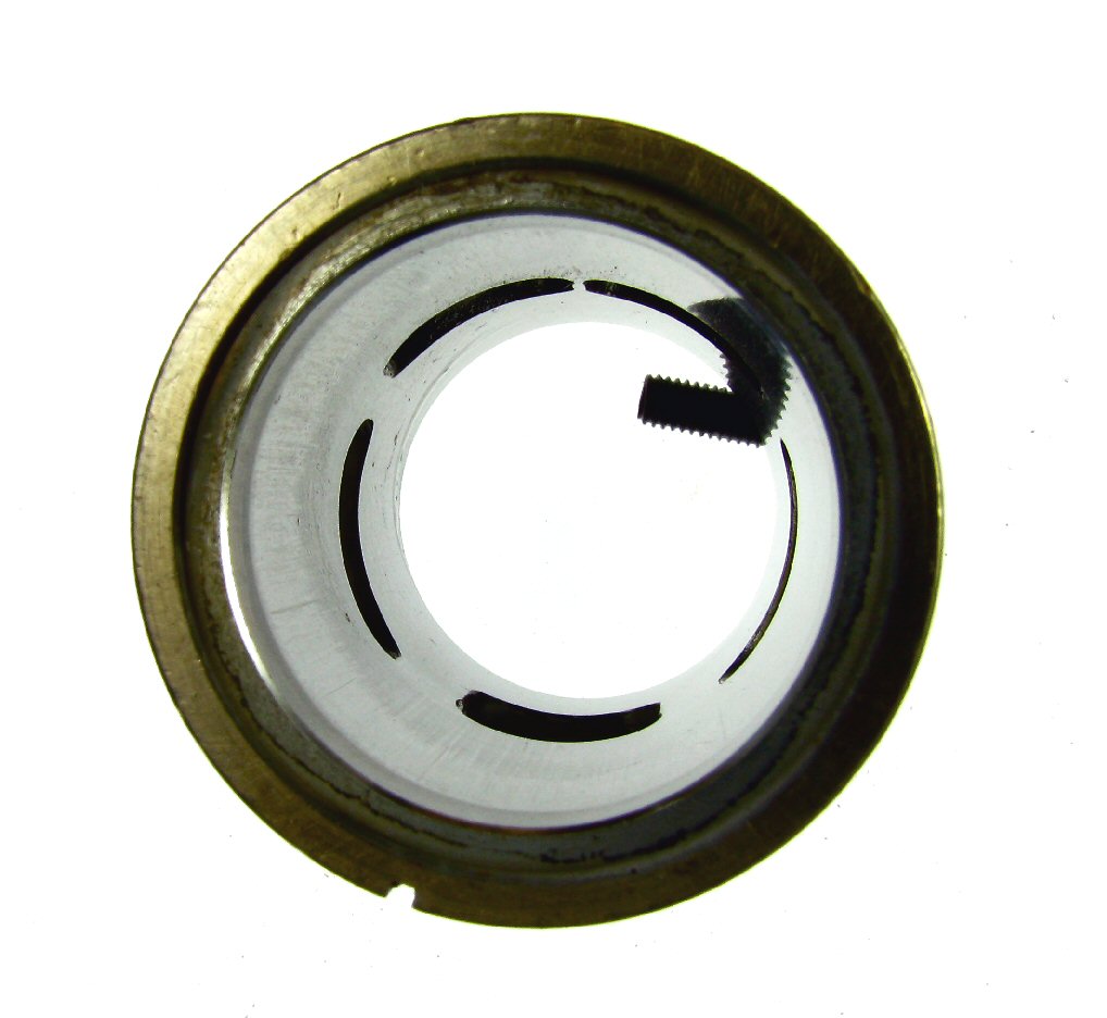

Looks like someone has messed with the porting [&o]
I took these photos some time ago
Left SF Ring Side engine
Mid V Rear Nelson Liner (Modified porting)
Right Standard OS V RE
I think the best bet also is to Run it on a standard 7D, or 7F carb no pump and see if it does runs stable.
If not sell it as a parts engine.

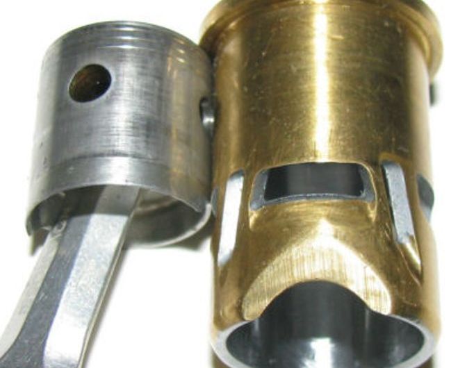

ORIGINAL: pitstop000
Here is modding done right,
except for the liner work see the groves made on the piston,
helps to keep a little oil against the cyl wall especially at TDC.
