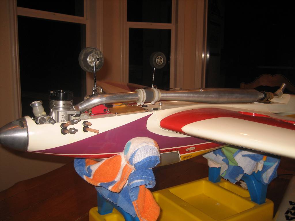

Iwould caution against e-flght electrics for the following reasons:
1.) it is a very tight fit for the header to get past the nose retract on an Atlanta. (See pcitures) not sure the E-Flight will work
2.) Tony F has them in his P7 and commented that he is not sure they were designed for nitro planes. He has had problems that he attributes to vibration from his engine.
I set mine up to work on one servo and they have been fine. Resently had a problem with my nose gear but the problem was not related to the retracts but to the steering that had set up. By the way, use a separate servo in for nose steering on channel 7 and slave it to channel 4. Works great and give you an easy way to separate the nose gear and rudder steering. (Kevin's idea)
Good Luck and congrats on getting an Atlanta.

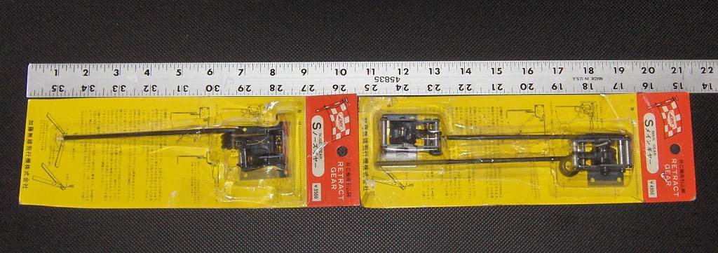

The MK gear you show in the links look too small to me. After seeing the links I went digging in my old pattern support parts supply and found some well used MK retracts. The MKs I used were black not red. really hard to tell the scale of the red ones but the strut and frames just look small.

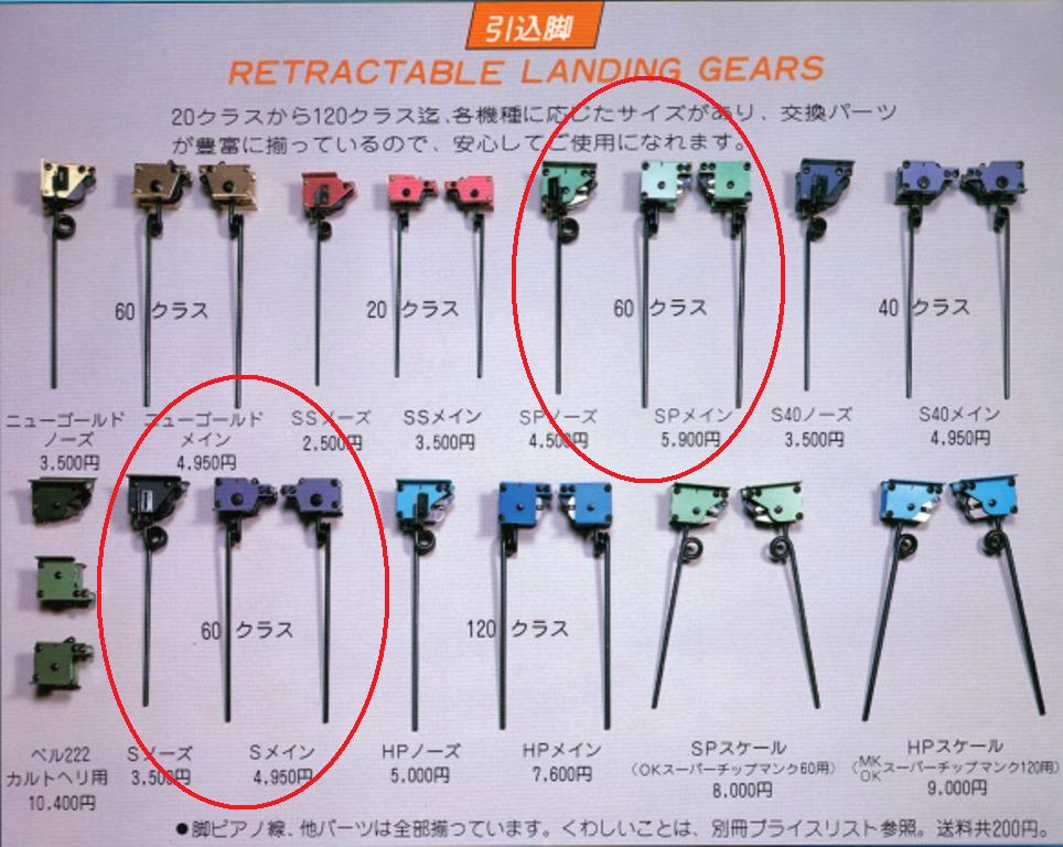

Erik here’s an MK retract chart, SS is 20 size.
Atlanta PDF’s version 1 and 2
http://www.rcgroups.com/forums/showp...02&postcount=9
call for
MK S or MK SP retracts; the MK S’s are Lightweight

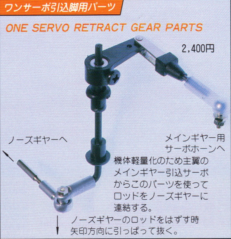

One other thing, well really 2 more things that you should start thinking about if using mechanicals is linkage.
This little assembly that MK made, easy to duplicate will get you from the retract servo in the wing to the belly mount going thru the wing for a single servo setup. This setup works for other planes (Aurora/Beetle etc) that are configured like the Atlanta.
Another assembly that MK makes that simplifies installation connections between the retract servo and the retract’s is their “Linkage for Gear†also something that could be fabricated.

Got an email back from Singapore hobbies and they only have the MK Sp mains no nose gear anymore .

We will be stocking the MK SP gear (mains and nose part #0703S and 0704S)) with the first shipment due next week. They are not posted on our web site yet but should be in the next day or two. The "One servo Retract Part" #0670 will be here next week also and we have the "Linkage for Gear" part # 0814 in stock now.

One more thing do not use the E-flite retracts in the Atlanta, the header and pipe are to close to the nose gear and you will damage the wiring from the heat!!!!! Pete
