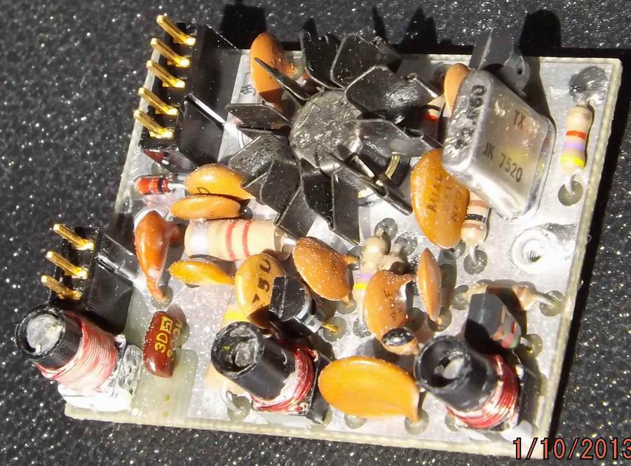

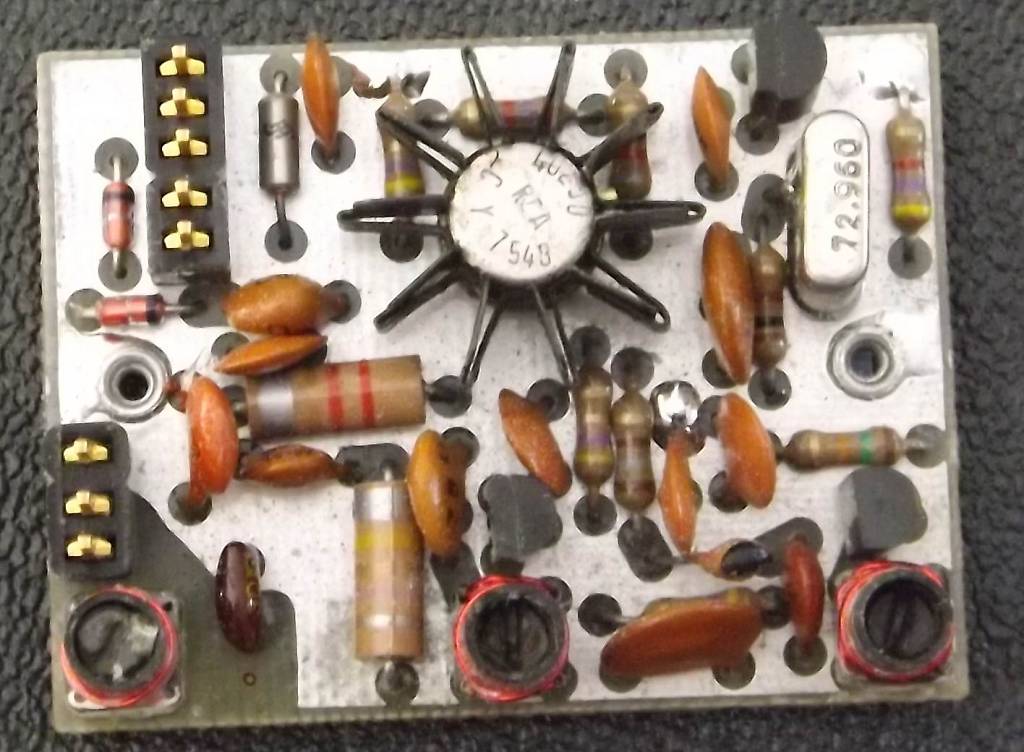

Anybody with a schematic of the RF board of a single stick Proline competition?Or in case someone has the radio to tell me the value of the resistor directly in front of the xtal? Mine is broken and a 3/4 of it is missing.The rf board is mounted inverted on the top case part next to the rf meter.
Thank you in advance

Hi,
I do not have a single stick Pro Line, but I do have a two stick. I'm assuming the RF board is the same. The value of the reistor is 4,700 ohm (4.7K) - Yellow, Purple, Red, Gold
I'm attaching a couple of pictures that may help.
Let me know if this helps.

Thank you very much Wayne indeed it is the same rf board and I fixed it already. I will post some pictures after I complete the renovation. The tx came in a filthy box with a lot of dirt ,I hope during the weekend to finish it.
