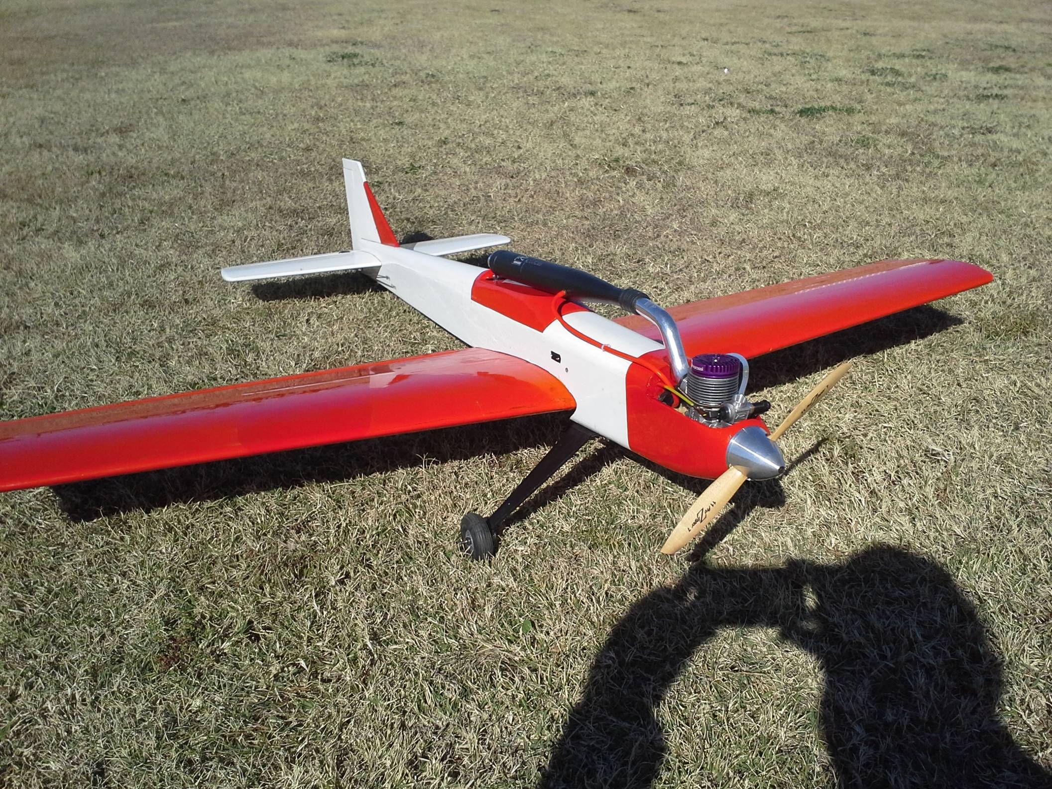

I decided to test my new NovaRossi R61 Speed 13 on a retired plane. Guess which model this started as.
This engine has in-flight mixture control. I have it set up and working but I'm not really sure I'm doing it right. Any pointers?
Center your trim lever or knob. Put a little "L" for lean and a "R" rich on your control. Set up your carb's inflight control so you have bind free, equal travel in both directions. Tune your carb like normal (Novarossi uses a small flat blade screwdriver for the needles). Once you have your base settings set (little rich) get it in the air.
My personal experience with the inflight mixture control is it is great for plane designs that will not allow an "ideal" tank setup. This usually means that you half to richen the mixture as the fuel level goes down in the tank. It can also be used as a fine tuning tool while flying to get everything out of the engine..... but I never trusted myself for that kind of "lean" adjustment while the plane flies by a full throttle....
Hope this is what you are looking for.

Yep, that's pretty much what I'm doing. I have it on the flap channel that has three positions and I adjust it on the ground in the center position so I can go either leaner or richer. I've played with it but I haven't really needed it because this engine/pipe combo is so tolerant of mixture variations.
Mitch,
good to see you around the forums again. You're going to love that engine if you haven't flown it yet. Very elastic, amazing high end brute power and not critical on the carburetor. I've been able to get it to idle, factory settings, at under 2K rpm on a pretty light Rev-Up 11x7-3/4". Snap the throttle open and it will hit 15K almost instantaneous. Props do make a big difference on how it behaves so try a few out. I've liked the Falcon wood props that are similar in design to the APC's. Xoar's are good too but heavier and better if you want to turn a larger 12" prop in which case the Speed drops down to a more typical long stroke. The high timing of the engine is what makes it remarkable since it is also a long stroke. Top end rpm on small props (11x7, 11x8) but excellent lugging power on large props (12x8, 12x10). All in all a very flexible, well natured, easy to start RE engine.
You'll notice that the mixture control is not very senstitive which is where it should be at. The threads on the mixture needles is typically very coarse so that a small movement of the servo will cause the needle to turn the equivalent of 1/4 - 1/2 a turn. In the case of the Speed, I think it is closer to 1/4 turn and the engine is not very "peaky" so it is just right for adjusting the needle depending on the fuel level in your tank.
BTW, the standard NR fuse top header has a 1-1/8" rise (C-to-C) which might be a better fit for that particular model. You can still angle the pipe up slightly if needed by bending at the coupler.
Keep us posted on your flights!
David
P.S. What is that bird?

I stepped away from this thread and a lot has been said. Forgive me if I don't address each issue individually, I'll just describe my experience with this plane:
I just drilled and tapped that pipe. I used a #29 drill and an 8-32 tap. I didn't tighten the nipple very much. It is working fine.
The engine runs fantastically. After breaking it in rich, I gradually leaned it after each flight. It is now "on the pipe" and putting out almost too much power for this plane. I made a mistake and left the throttle open in a dive and ran into flutter. I immediately shut the engine down and got the plane back but with one of the ailerons pulled away from the spar.
I now know not to do that.
The testbed airplane in the photo is a ModelTech Calypso modified to take this engine in the upright position. It had been previously modified for fixed gear. I know it's ugly but it's just a test of the engine. I am working to find a suitable build project for my new NovaRossi.
I'll probably buy the lower-rise header soon.

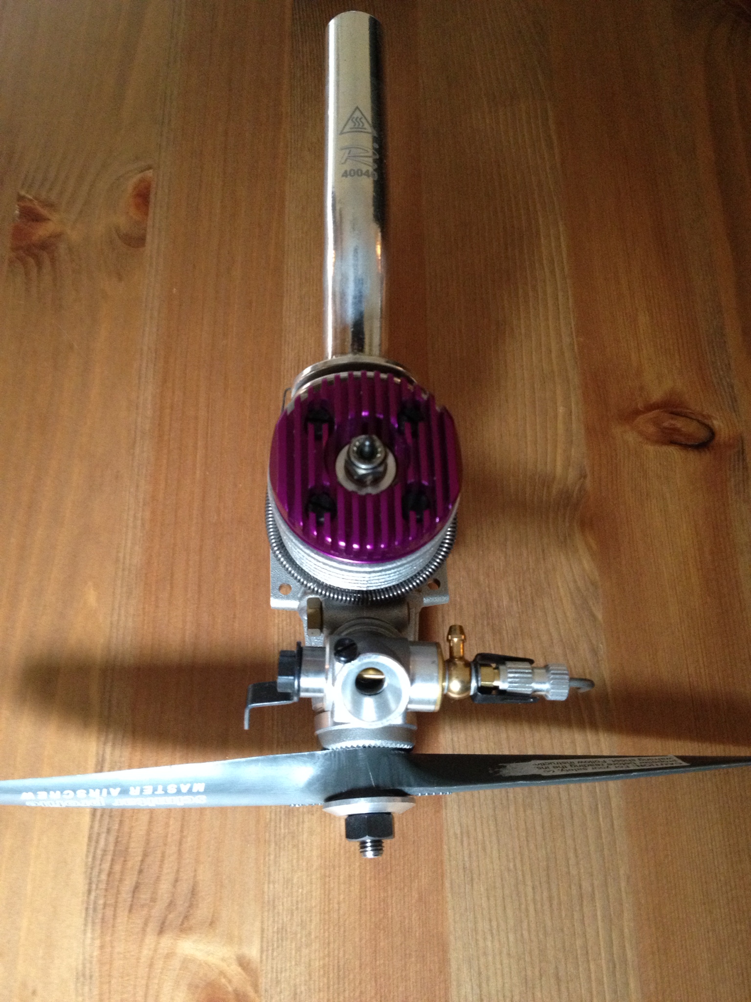

The engine is on the table as it is being used in stages of model design development. This engine is designed to put out power at high rpm so expect to turn smallish 8" props to get there. I'm interested in seeing how it performs on 9x5, 9x6 props as the engine will go into a pattern design. I have the standard NR 40040 fuse top header and muffled 50041 pipe for it. There is an 85 mm (~3.4") longer, 10 g heavier, quiet pipe as well (50042) if your model can accommodate it.
One thing I've noticed with most all NR engines is that they are optimized for power with short crankcases and shafts (among other things). As a result, the high speed needle on the the R528 has 1.5 mm clearance from the blade of an 8x6 prop when turned with the "L" facing forward. This is naturally too close for comfort so plan on using a spinner no matter what, There are 3/16" left of thread on the prop shaft simply with the prop bolted on - just enough for a spinner backplate. The prop nut is 5 mm thick and if slightly more thread is needed with a thicker backplate, a 3 mm nut (giving another 1/16" of thread) can probably be sourced. Alternatively, A Tru-Turn prop extension adapter can be used in conjunction with their spinners. Once the spinner backplate is on, the prop should be sufficiently forward for adjustment comfort. It would be intersting to know whether the 15 and 21 present the same situation.
I took a couple of snaps of it below. Maybe I should add one with the pipe as well.

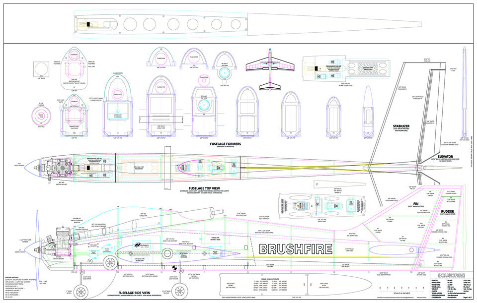

My Feedback: (121)
Hi David,
Really nice CAD work on your updated Brushfire plans. Don will be producing a glass/foam version sometime soon, too. The original Brushfire plans resulted in a somewhat overbuilt (heavy) fuselage. I would guess an easy 6-8 ounces weight saving in your fuselage construction. I'd love to get a set of your plans as I have a Jett 120 rear exhaust which would be perfect for a slightly larger version.
regards,
will
regards,
will
