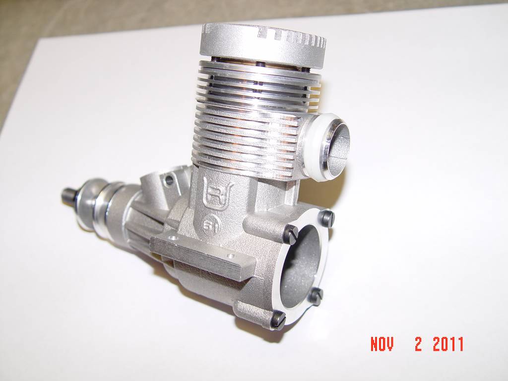

The 3+2 version is the one pictured above and is the same as what I have if I'm not mistaken. The blackhead .61 I had was a two peice case design and only had 3 intake ports. The 3+2 also seems to have a longer stroke.
Danny, I was not familiar with any of the 10mm carb issues. I'm at a loss as to why I have not experienced anything more then thinking the carb was a little tougher to set up then others. I'm wondering if the exhaust is the key? On my .45 I am using an ultra thrust and on the .61 it's a Mac's muffled pipe and a 5" header. I'm thinking the header is too short and have a new one I am going to try at full length in an effort to get it to swing more prop. I've had so much success with the 10MM that I will leaver an open offer to anyone who would like to trade one for an 8MM.
