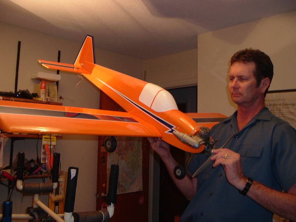

I built one in 2005, as did Beppe Fascione. Beppe and I are good friends, yet independently built this model by coincidence at nearly the same time.
It flys well, but not any better than a good sport plane of today's standards IMHO.
I had aileron flutter with it and resorted to dual servos and counterbalancing. It was a fun plane with an Enya 60III and Gold Metal radio.
One day I decided to use it to run-in a YS60. Big mistake. After climbing at a sixty degree angle to 400', I leveled it off and both ailerons separated from the wing.
Be careful of the RCME plans as there is a spacing error in the wing ribs. I also had to deviate slightly in the turdledeck as the bulkheads were not quite right. Use good modeling sense and enjoy the build!
-Ron

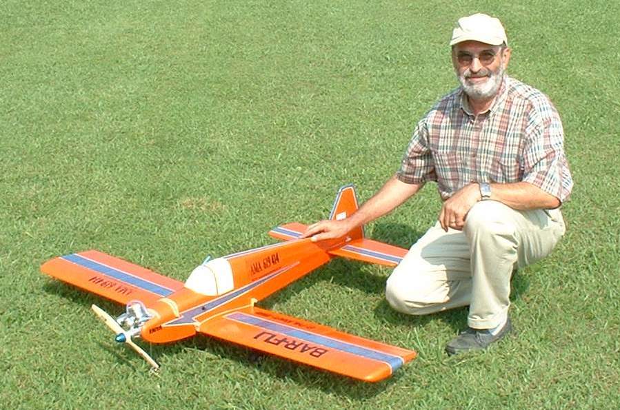

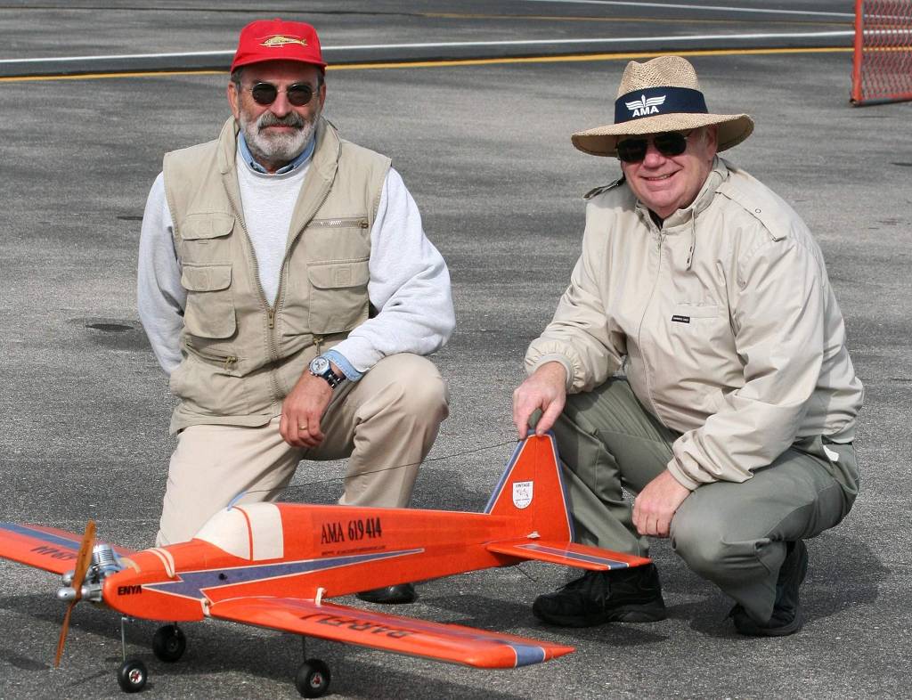

this is my Bar-Fli, that has been flown many times at the VR/Cs reunions. It has an ENYA 60 III for powerplant, turning an 11x7 3/4 around 11.500rpm with 15% Nitro and 23% oil. I use my Kraft Signature radio with KPS-23 servos. Unlimited vertical!
Ciao
Beppe

I've seen these photos in my web searches - nice to have a name to go with them!
It's also nice to see an antique model done with an older engine, radio and even rubber bands!
Martin
