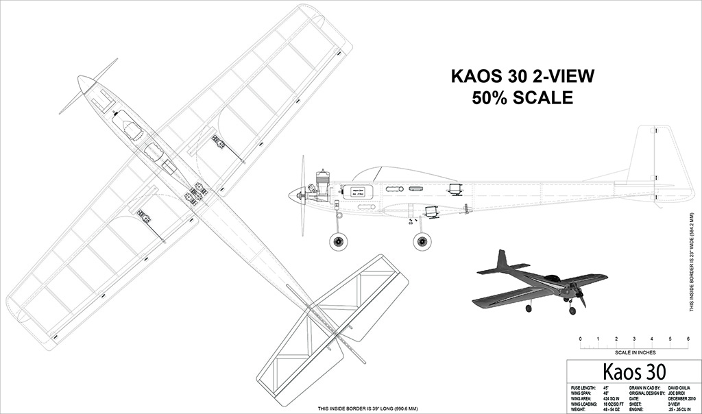

I would just buy the Blue jay kit if it was availible and build a 30cc but it has been out of stock for sometime. I do want to build light but Im not getting obessed with it. I dont want this to be a floater. I need a good reccomendation of rib thickness so I can get started. Im thinking of a combination of lite ply andbalsa. I was thinking of the fiberglass tubes because they are 53" and would make a great jig for building the ribs. Im going to work on enlarging the ribs and placing the holes for the tubes on a tempate and go from there.
If the tubes are longer than each panel you could use them as the main structural spar. Then for ease of building I would add a top and bottom 3/8 square spar on to which you would glue shear webs in between each rib pair. I'd place the glass tubes right behind the D-tube section. The nice thing about the Kaos is that having a flat top wing you can join the panels with a straight inner section as you propose.
I would use 1/8 medium balsa for the ribs with the LG carrying ribs doubled with 1/8 aircraft ply - unless you plan to go with fuse mounted conventional gear...
Use a stiff (perhaps basswood) TE spar, a stiff sheet sub-LE and a softer LE. 3/32" sheet balsa for the wing sheeting.

The wing will actually be a two piece wing. I would join the wings with the fiberglass tubes and bolt them to the bottom of the fuse.The wings would actually bolt to each other then to the plane. Since I would not have the larger gap between the wings like a edge or extra I was hoping I could use dual small tubes. My idea was to also use the tubes as part of a jig. I could also use a ply mount that attaches to both of the tubes for the landing gear mount. Just some ideas

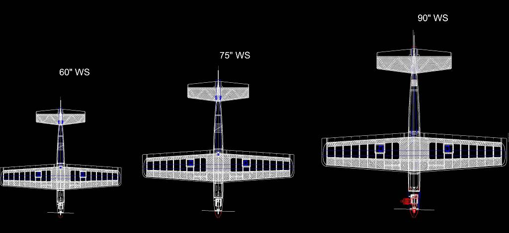

I looked at this a few years ago after I built a 180 FS powered S. Kaos (75" WS).
As I recall the original SK wing thickness was 19% at the root and 17% at the tip.
I drew up a set of CAD plans using the artical in M.A.N. as a guide. I used their material call outs and ended up with an overweight, though immensly strong plane. I could easily build another that would weigh 2 pounds less.
Built as a tail dragger, the wing will have to take a lot of load. For built up I would go with 3/32 or 1/8" lite ply ribs (lots of lightening holes), built-up spruce/fir spars, a 1/8" basa sub leading edge, 1/8" balsa sheeting and cap strips.
At 90" WS/1500 sq. in the fuselage cross section is only about 6.25 " square. You'll need to keep it stiff without a lot of weight. I would go with 3/32" light ply for the fuselage sides (lots of lightening holes), 1/8" hard ply doublers for the forward fuselage a 3/16" balsa top deck. I would add 2 extra fuselage formers to the aft section as well as using some spruce/fir longerons( maybe 3/32" thick x 3/8" to 7/16" deep)
You could certainly use balsa for the sides. but you will be gluing up a lot of sheets to get your blanks. With the cost of balsa, the ply may well be more economical.
The attached picture gives an idea of relative sizes.

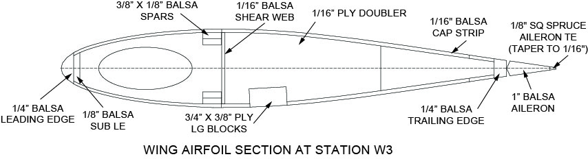

This is number 10 rib have been working on. I will run the fiberglass tubes alll the way to the end of the wing and only glue the first four ribs. the tubes wll be cut and removed fromt he last six ribs after the wing has been built. This will work as part of the jig. Im thinking of using a balsa spar and milling a slot in it and gluing a .25 carbon fiber tube in it. I was thinking of making ribs 1 through 4 with 1/8 lite ply and cutting some lightning holes in them. Just wanted some suggestions before I rework all 10 ribs.</p>

Carbon tubing will make exceptional spar stock. I'd suggest that you forego the balsa and use the carbon tube only. You could use 1/4" x 1/32" for the main spars and 1/8" x .015" for the rear spars. Since you are drawing the ribs in CAD, you could have a laser cutter cut the ribs exactly to spec. Don't forget to roughen to carbon spars such that super glue has good bite. The only ribs that should be lite ply are the center and the gear ribs. I assume that you will use retracts on this bird.
A simple technique if you use retracts is to lengthen the struts using carbon tubing. I use .280" x 1/16" which fits a 5/32" shank just right. The steel shank only needs to be about 1" long; epoxied in place. I also install a 1/2" long length of aluminum tubing around the carbon tube at the epoxy area, to keep the carbon from splitting
If you don't plan to use retracts, don't bother with ply ribs either.

Matt's ideas for the spars strike me as good ones. The balsa becomes redundant if using CF. Another option would be to use hollow rectangular or square sections of CF. It strikes me as it would make a massively strong wing. In the much smaller wing I drew up, I went with spar doublers in typical Japanese MK style. The spars are thin but they are doubled for about half the panel span. The joint makes them very resistant to bending as the grain is locked in place by the glue so they can't slip with respect to each other.
Another very cool wing building design concept is to use interlocking shear webs (see last picture). The webs lock the ribs and spars together practically without glue. The webs also produce the dihedral required by design. With a flat top wing, only the bottom of the webs would be tapered while the top two corners would be at 90 degrees. I think the easiest way to build a Kaos wing is to build it inverted flat on the table with the rib center lines parallel to the surface.
David.
David,
Nice drawings. I agree on the reduced thickness. Didn't realize you had CAD capability. Can you draw up a wing to my design specs (pricing? PM me please)? I would want to have a couple sets of ribs laser cut. That's to prove a point between foam/balsa versus built up ribs.
Be careful of the interlocking but glueless shear webs. I really like the interlocking feature but I would glue them to the spars and ribs. I don't think you want shear webs to float against the spars and ribs. Vibration will wear the contact points out fairly quickly

Well I guess I have enough info to start my drawings. I have decied to use a 3/8 balsa spar laced with a .25 carbon shaft. And one .25 carbon shaft in the rear without balsa. It will have a balsa trailing edge for the hinges to attach. This is not a high tech build. I am on a budget for this one. I will keep it as light as possible and may usea limited amount of CF in the rest of the build.The landing gear will be wing mouned and I will machine a oleo type strut. I dont want something intrusive here. Front will be the same. I just want typical Khoas performance not looking for unlimited vertical. I will post some pics of drawings before I order anything. thanks all for your help.
