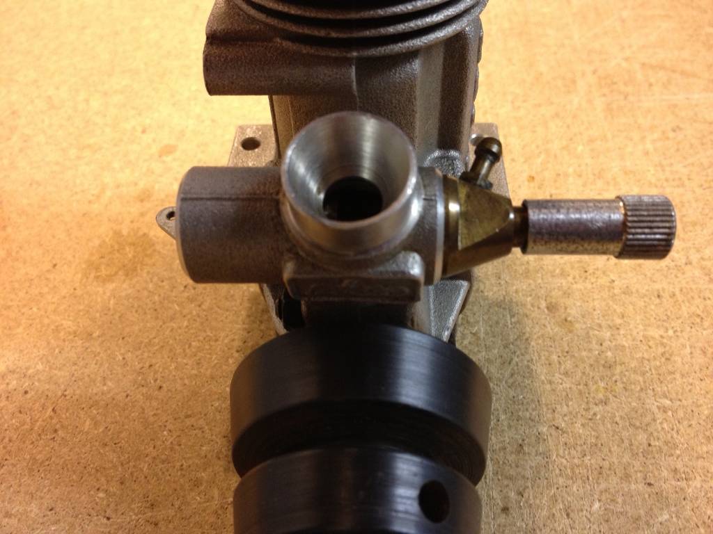

I removed my carb today to mount Jim's carb. While I had both carbs out I decided to compare them to see if there was any differences or obvious problems with mine. To my surprise the carbs are not identical even though they are both for the OPS 60 FIRE Redhead. Most of the differences will not affect the performance of the engine. However, there are a couple differences that may affect the performance. I'll list the differences starting with the ones that may affect performance.
1. Direction of spray bar notch. My is the one with the notch straight down. Attachment 1 & 2.
2. Diameter of fuel inlet fitting hole. Mine is just slightly smaller. Can't tell by looking at it but a small drill bit will go in Jim's and not in mine.
3. Taper of throat in bottom of carb. Mine appears to be opened up more. It can be seen in Attachment #1.
4. The angle of the fuel inlets are different. Probably would not affect performance. Attachment #3
5. Notice that the control bellcrank pivots at a different location and the boss for the pivot mount is larger. Attachment #3.
6. Bellcrank screw hole goes through on my carb body but not on Jim's. Attachment #4.
7. Metal needle valve body on Jim's, Plastic body on mine.

Before I list everything I have tried to get my OPS 60 FIRE Redhead to stop going lean in up-lines I thought I would talk about my latest development.
I have connected with a new friend from Deatsville AL, Jim Oliver. He is a Classic Pattern Flyer and owns serveral classic pattern engines including 4 OPS engines (2 Redheads and 2 Goldheads). I explained the problem I have been having with my OPS. He offered to loan me one of his Redhead carbs to try in my engine. I very much appreciated and accepted his offer. If my engine runs correctly with Jim's carb it will indicate that my carb is the problem.
I plan to get Jim's carb in tomorrow and will be flying the Saturn as soon as the weather permits. It's winter here.
Thank you very much Jim for letting me borrow your carb to make this test. I'll let you know any results ASAP.

Can't remember if I told you, the carb I sent to you came with the Redhead when I got the engine from someone on RCG, so I can't be "certain" if it was original to the engine.
The differences are interesting; it appears that yours has in flight mix control.
I suspect that the spraybar with the slot "on the side" is correct. The air moving through the venturi would shear off the fuel flow and possibably atomize better than with the slot on the bottom of the spraybar.

Ralph, Here is a picture of the OPS 60 red head with the carb open. It shows that the notch is visible like the one Jim sent you.
Mark

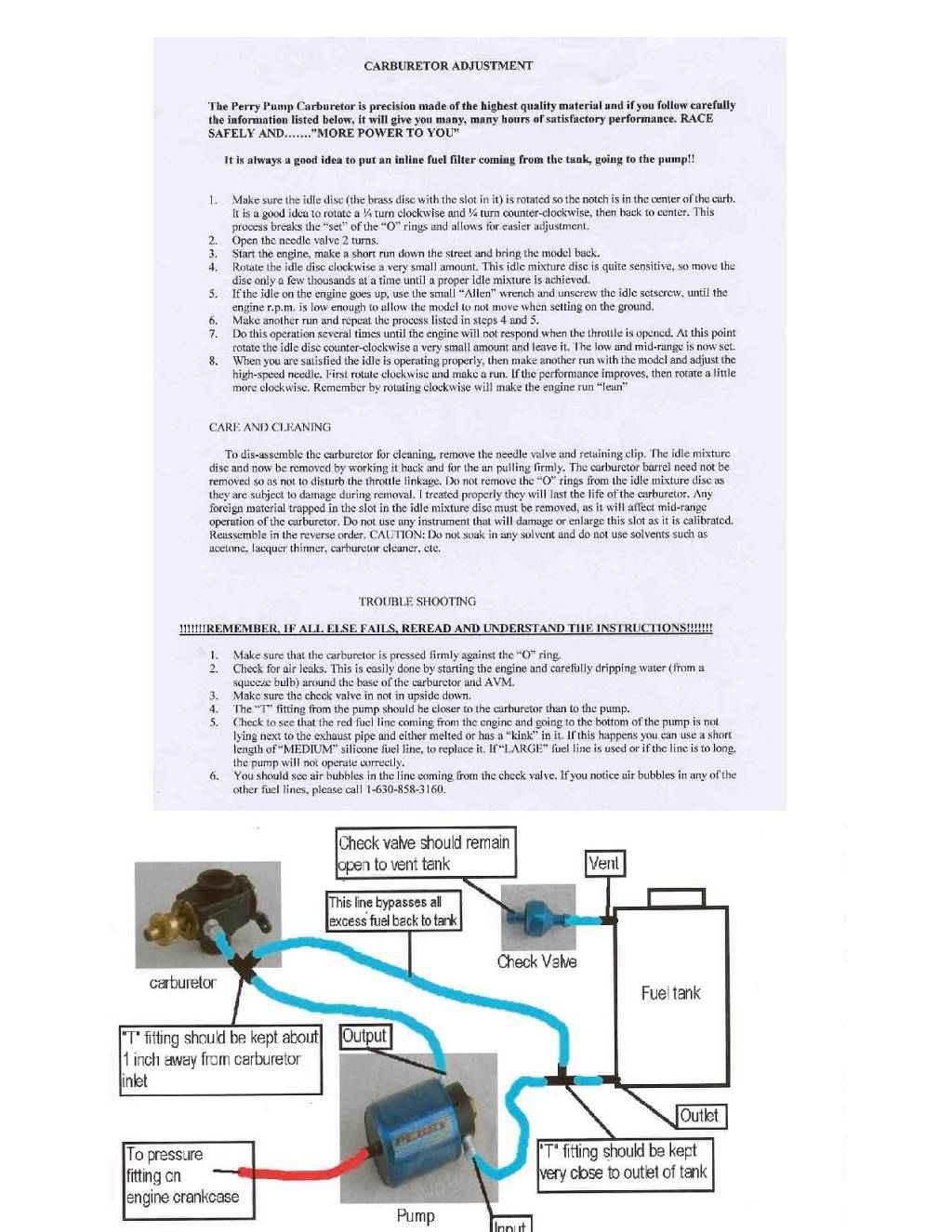

Ralph,
I'm using a Perry VP-30 (blue case) pump with a Tee fitting(see pic) right at the carb. The carb is the standard OS 5B carb designed for the OS Max 50 FSR, nothing special.
Since this is a vintage engine I decided not to try and run it with just muffler pressure as I didn't want to have to worry about a lean run at least from relying on the vacuum from the engine. I also add 4oz of castor to the glow fuel I'm using and also run it as rich as I can.
I'm not using the check valve on the tank vent and it is vented to the air, no muffler pressure.
I have positive fuel pressure to the carb during all manuvers and only had one deadstick so far due to a small piece of what appeared to be aluminum that got wedged in the glow plug. over 50 flights on the Utter Chaos now and it's turning 14400 rich, very nice vapor trail behind the plane while flying.

Ralph,
I hope you don't me posting this here but I thought I might get some good suggestions from yourself, Jim and others on how to proceed.
Below are some pics of the OPS 60 RH I picked up recently. As Jim mentioned, these are the three port red heads. It came with a Perry carb (of equivalent vintage) which was a little wonky. I took the engine apart to check on its internals and it looks to be in excellent shape - hardly run if at all. I happened to have a Picco carb that fit just fine and judging from the OPS carbs, the Picco and OPS are very similar which makes sense considering the "P" in OPS refers to Mr. Picco. I'm thinking that a Perry pump and carb combo might be the way to go in the absence of the Picco carb. Perhaps a little better power output.
As can be seen though it came with the attached flywheel and lacking the proper tools, I was unable to remove it. All the bolts were pretty much seized up but I was able to work them out eventually. The flywheel requires a special caliper to grasp on to it so that it can be locked in place while the front end is unscrewed - I believe. Anyone with boating experience know how to go about this with regular tools?
I assume that I'll also need some parts for the front end - a drive washer as well as a prop washer and retainer nut - well, the nut will probably be replaced with a spinner retainer nut. Otherwise, I assume that the crankshaft front end is standard with threads under the flywheel that can't be seen.
Ralph, I'll be interested to know what performance you get out of your red head with the APC 11x7. Mine is a SE rather than the RE so performance might be a little lower. Anyone know what the required header is for this SE? Is there an engine with equivalent bolt spacing on the exhaust?
David.
David.
