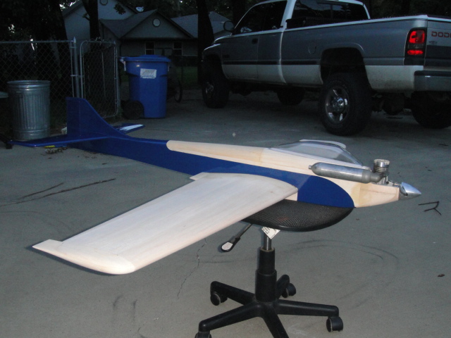

Default RE: Compensator Build
Didn't get as far as I wanted last night. Was out till 5:30 AM!!! Did some more this afternoon, and am about to head back out. Here's a pic!

Definitely a 5:30 AM pic!
Red or white on top? Wings?
Looking good!
David
Going with orange with white accent. Thanks!!
