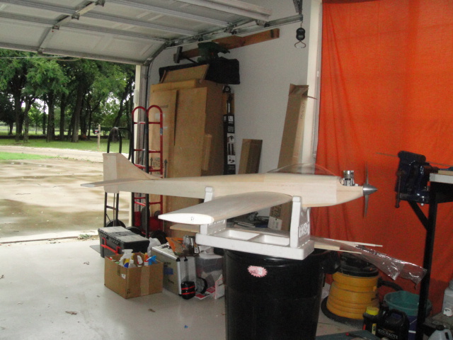

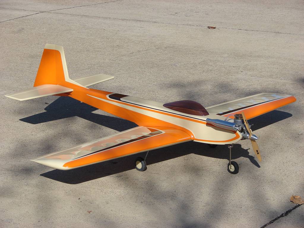

Hey guys, my Kaos broke at the Glue Dobber's Dan Quinten Memorial contest in Tulsa, and I am working on building a Compensator from Eureka for the next contest.... which is June 16 at Thunderbird field in Fort Worth. That is not much time I know, but I think it is possible. As far as the Kaos... most of you have seen pics of it, but I'll attach another for those of you who have not. My desire was to retire that airframe and build something else, but up until now I have kept going back to it. Thankfully I noticed the failed vertical stab glue joint and lower hinge, and did not lose the plane. As far as reason for retiring the plane... First, there is an incredible sentimental value to it. Second, I have moved into expert and believe there must be better airframes for the more demanding sequences.
I have not done a build thread, nor read or followed one, so bare with me. I feel I can build a nice plane, and hope to share some of the experience with y'all.

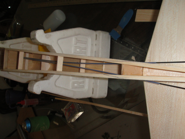

Worked on the plane most of the day, and am feeling good about it. Thank you David for the guidelines to look for on weights, the wings seem inline at 260 grams each with leading and trailing edges bonded and sanded. Of coarse the rails and gear blocks were installed in the cores before I sheeted them. The horizontal stab is 70grams with le and te installed and halves joined. The vertical with rudder is 33. I should be able to join the wing and start building the fuse in the morning. I already prepared the fuse sides, though I plan on redesigning the upper for 1/16 sheeting instead of carved blocks...
Anyone played around with dihedral? Plans state 1" under each tip, which is essentially a flat upper surface... Let me know if it needs tweaking!!

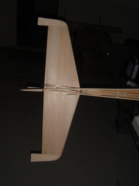

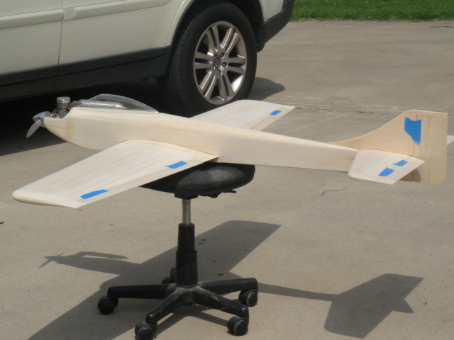

Here are some of the pics I took last night, maybe today I will take some that look more like an airplane!!! Also here are a couple pics of the canopy!!!

I have built 2 and flown one more Compensator and 1 inch under each tip is good dihedral yes pull a string across top and its flat. Compensator maybe the most honest airplane SPA legal only mod to consider is maybe strech fuse a bit from wing saddle to tail 1.5 inches or so. Did you purchase the streched version of kit from Eureka? Please do post more pictures so we can enjoy the build.

Thank you for the input Tim. It is the stretched version from Eureka. I considered returning it to plan, but remembered adding a good bit of lead to the tail of the Kaos... A fellow competitor won it in Tulsa a couple years ago and gave it to me!! I will post more pic in a bit, it's coming together well.

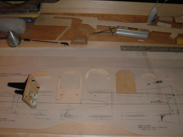

If you will go to the Trenton rc flyers website and look at the Gator Flea article it shows formers and 1/8 sheet planking top round deck which should be great for the Compensator, sometimes little brother "Gator Flea" may have a better idea. After sanding to shape you will have between 1/16 and 3/32 which should hold up to everyday handling of the model around flight line. You could design a foam deck and sheet but the planking idea maybe easier. Did the kit come with orginal diamond stab or a symmetrical one like Zimpro did when Dennis had Compensators available?

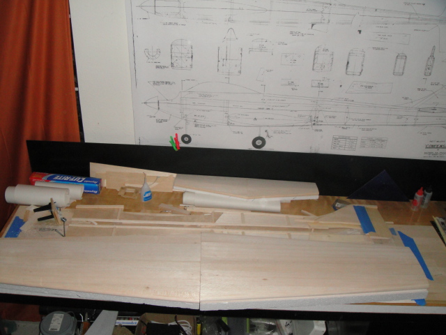

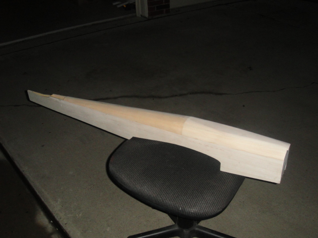

I built some formers, and sheeted. The planking would have looked better. I'll post some more pics tomorrow morning. It has the diamond stab.

Well, it doesn't look much more like a plane today... lol, but I have a fuse now! Back to the shop!

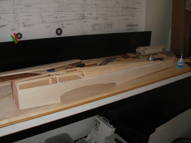

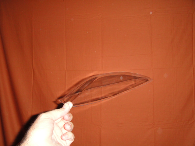

Thank you Tim! It looks better in the pics though. If I were to redo I would use more srtingers, and wet the sheeting before applying it...
I decided to do the cowl and bottom block while the fuse is still easy to handle, and it took a bit more time than I expected. I used Sig's yellow glue, hoping it will fill some small voids and sand well. I also joined the wing halves. I didn't remember to take a pic yet, but when I made the formers I cut the inside of the third one, which is near the cg, to cradle the Jett bubble less tank. The tank is right inline with the carb, so maybe that will all prove to work well. If not, I have a new OS SF-p I can put in it, and went ahead and cut holes in the firewall for the fuel lines to the pump.

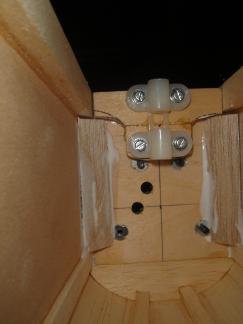

Have you installed the retract plates in wing or did you decide to go with fixed gear? The plan if memory serves me correct shows the tricycle gear rear mount at 1 inch behind cg, the plane will tip front to back on landing. Move the gear back about 1/16 of an inch. This will help keep the plane from having the rocking horse like effect of tipping on the tail skid after fuel is burned out of tank on landing. That usually happened when the landing was complete and plane stopped rolling.

Tim, thanks for the tip, but I installed the blocks before I sheeted the wing. IIRC I moved it back about 0.125", I hope that is enough. I usually like an aft CG location. The tank is on the CG, so at least it will not be a factor. If I need to , I can bend the gear to place the wheels further back... I am working on it now, and hope to start Monokoting tomorrow.
