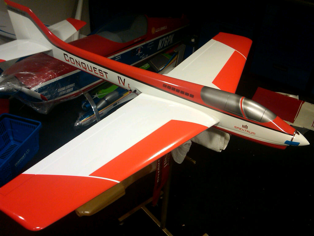

Old 06-08-2012 | 10:26 AM
EscapeFlyer's Avatar
Joined: Aug 2003
Posts: 2,396
From: Brooklyn Center, MN
Default RE: Conquest VI
ORIGINAL: 80sPattern
We need pictures!!!
+1 Please!
Brian

Old 06-11-2012 | 09:01 AM
Joined: Apr 2011
Posts: 104
From: Rancho Santa Margarita, CA
ORIGINAL: frequent flyer
We need pictures!!!
Don,
Pretty funny Iask for pictures and send me pictures of myself. Fatherof4 was taken on RCUso Iam 80'sPattern on the RCU.
Robin,
We want to see pictures of your plane!
Doug

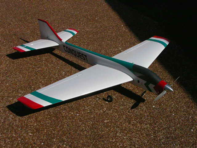

Old 06-13-2012 | 04:39 AM
Joined: Apr 2012
Posts: 4
From: williamsport, PA
I've uploaded the only photo I have of my Conquest VI, taken before I bought it.
