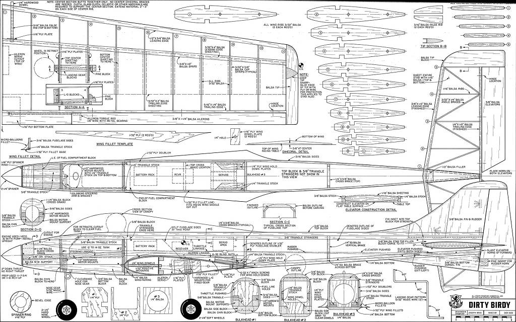

What is the dihedral of the wing on the DirtyBirdy?? ...dead straight down the center line, flat across the top, or some value greater??

Poor dihedral angle causes roll coupling with top rudder application.
If the wing has less dihedral than necessary, (flatter than necessary),you will get adverse roll couple which means the wing will roll in the direction opposite applied rudder-ie- left rudder produces right roll couple
If the wing has more dihedral angle than necessary you will get proverse roll couple. Means the wing will roll in the direction of applied rudder-ie- right rudder, right roll, sorta like a top wing trainer that rolls with rudder to make a smooth turn.
The plans don't show the dihedral but the instructions state "turn the wing panels upside down and move the root ribs of both panels together. With the spar at the tip rib down on the building board, block the center of each wing panel up 3/8" of an inch."
Yes, it says 3/8" of an inch.

I checked my RCM plans and the dihedral is shown (per the instructions above you posted) just above the center of the fuse top view (see attached). Are you referring to Blue Jay plans that don't show the dihedral?
MTK, I thought you were right with 1/4" as best as I could recall until I pulled the plans and looked it up. But what's 1/8" between friends?

Edit: Yup, the plans often show more than we see. Doxilia is right, the Blue Jay plans show exactly what he pointed out in exactly the spot he pointed out. Did I say their plans were straight from Bridi? I did a quick once over and didn't spot the dihedral but I knew where the instructions were and went for that. Doxilia got it right, same number but yes, it's on the plans. And the Blue Jay plans are identical.

To answer the original question.. I think I'll make the wing flat on top but build it with a 3/8 thick W-1 so I can saw it in half if necessary. I really wanted wing tubes but the first wing will have to be one piece so it can be easily reworked. then I can build a 2 piece wing. Transportation is not a problem as I have a 1 ton dually with an 8 ft bed and a 34 ft Goose Neck trailer if necessary.
