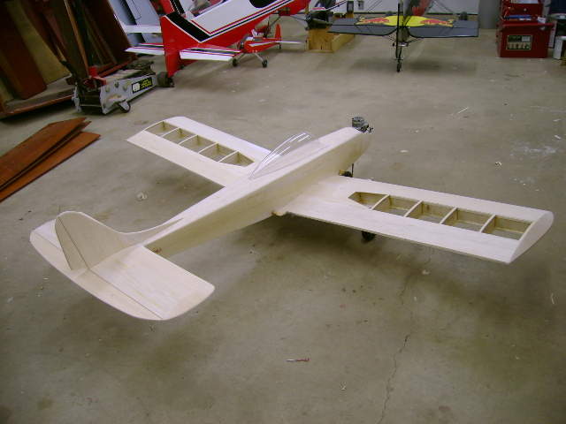

The wing is built except for installing the landing gear blocks, the bottom sheeting, and wing tip sheeting. Ailerons still have to be made. It is amazing how rigid this structure is considering starting with flimsey 1/16" sheet and 1/4" sticks. But that is the results of D tube constsruction. Next will be the stab. Ribs are cut so that shouldn't take too long to complete. The fuselage will take the most time having to fit and install all of the equipment.
It feels good to know that I will have a Viscount again and that this time it will be a flyer.
I hope you are enjoying seeing the progress.

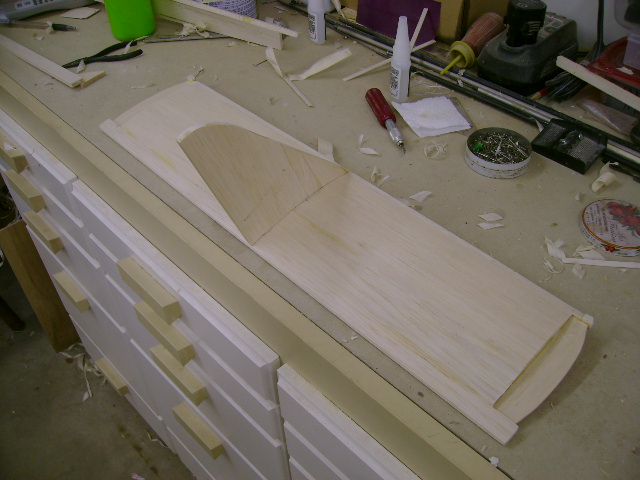

The week has flown by but I did get some more done on the Viscount. The main landing gear showed up in a box of spare landing gears from airplanes that have met their demise. The length was perfect although the vertical leg that goes onto the wing had to be repositioned through cutting and bending. It now fits perfectly in the landing gear blocks.
The stab is now finished except for the sheeting on the tips. I'll take care of that for the stab and the wing when glue is drying on the fuselage during that part of the build.
The rudder and fin have also been cut to size. In this day of barndoor size rudders, this rudder almost looks like a trim tab. But, I am staying true to the original, so the rudder size is what it is.
I am looking forward to building the fuselage. It is simple slab side construction but has a nice shape due to the rounded top.
This build is bringing back good memories of my first Viscount 48 years ago. I have to say I don't remember that much about the building of it, but I do of taxiing it around the driveway on the farm yard yearning for a smooth runway and open space to fly it. That time will come again hopefully later this summer when the Viscount is finished.
Now it is on to the fuselage build. This is a simple airplane to build and it is fun to see results come quickly. Can't wait to get at it.

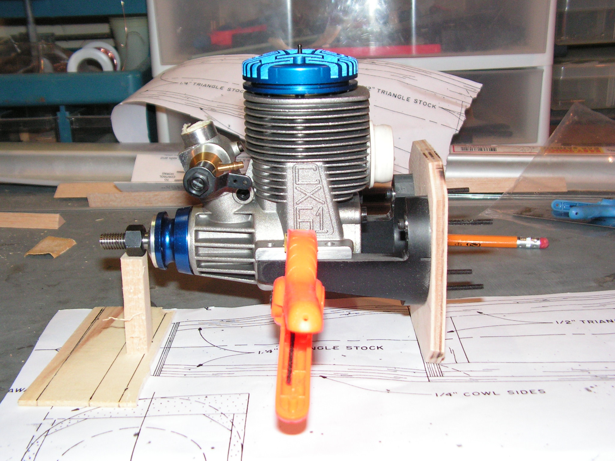

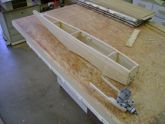

Building time has been scarce lately but found some time this weekend to make some progress.
Attached are pictures of the slab sides for the fuselage and the motor mount assembly and formers.
The motor mounts according the the plans are 1/2" square maple that extend from the nose to the first former after the firewall. Mounted on top of them is an 8 oz deBolt round metal tank. Not having one, (but who would?) I had to substitute an 8 oz Dubro square tank. Since there is no room on top of the motor bearers for the plastic tank to fit inside the fuse, so I had to design new motor bearers to extend from the nose to the first former as on the plans and around the tank. The bearers are "u" shaped and wrap around the tank and are glued to the sides of the fuselage. Under the bearers, a tank floor will be glued in allowing the tank to be at the right height relative to the carburetor needle valve. The tank will slide in from inside the fuselage. The fuselage sides have a 1/32" plywood doubler which extends about 1 1/2" past the former at the trailing edge of the wing. This adds a great deal of strength to the forward fuselage. The location for servo rails has been marked and rail brackets have to be installed. Also, a balsa doubler at the stab location needs to be glued in and then the sides can be glued to the firewall and formers.
The sticks and sheets of balsa and plywood are beginning to look more like an airplane.
Stay tuned. There is more to come.

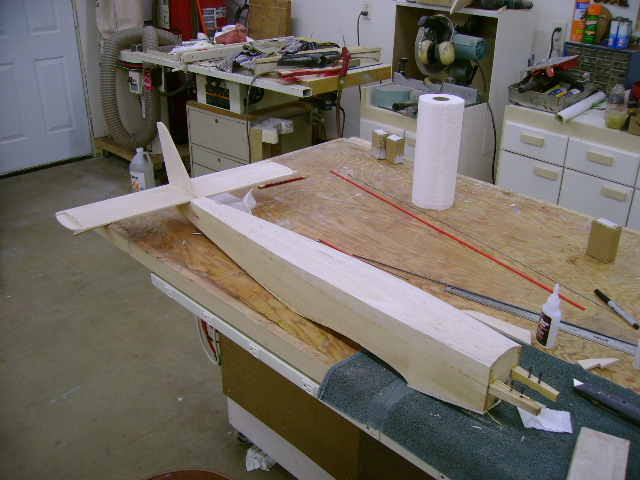

The fuselage sides and formers are now one. To prepare for that, I made sure all of the doublers and servo rail brackets were glued in place, and the positions for the formers and firewall were accurately marked. During the gluing process, I made sure all of the centerlines of the formers were all in line and clamps and braces were put in place to assure it would stay that way while the glue dried. Next, the engine beams will be glued in place, a fuel tank floor will be installed and fuel line holes will be drilled through the firewall, followed by the sheeting for the top of the fuselage. Radio installation will be next including pushrods for the elevator and rudder, throttle and steering cable, and the brake cable before sheeting the bottom of the fuse. I fly from a relatively short asphalt runway and I'm tired of running off the end of it after a landing. I have a Rocket City spring brake that I pulled from an old Sig Kougar nose gear from many years back. It worked well and is easy to install.
It is starting to look like my Viscount I remember from 1965 and am anxious to fly it.

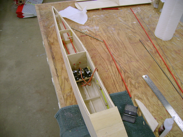

There is progress on the deBolt Viscount! The servos are installed temporarily, the steering, throttle, and brake cables are in. The rudder and elevator pushrod guide tubing is in and the motor mounts are glued in place. Next will be the gluing on of the bottom sheeting on the fuse behind the wing. Still have to trim the wing and stab saddle to set the correct incidence and install blocks around the motor mounts and shape the nose and then finish up a few putsy items on the wing. It is really becoming an airplane fast now and will be ready for covering soon. This airplane builds quickly and it has been a lot of fun so far. I am looking forward to putting on the original color scheme to bring the memory back of how it looked at flying fields over 50 years ago.

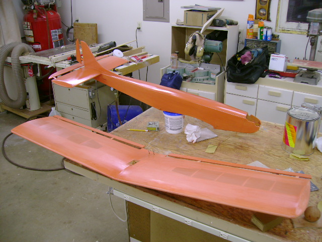

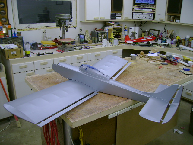

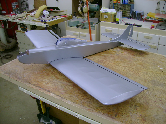

I am coming to the final stages of this build with the covering completed with Koverall and a few coats of Stits Poly Brush applied. The shine is coming up on the Stits now so it is close to color time. The color will be Stits Poly tone.
This is the second airplane I have done with this system and am getting a little higher on the learning curve. I have learned that sanding is not necessary during the first few coats of Poly Brush. Just keep spraying it on until it shines. What is important is to have a well sanded base prior to covering for a nice smooth surface. Carefully block sand the wood before covering to kill the high spots and identify the low spots, circling them with a pencil and fill them with vinyl spackle. Then sand some more. Take the airplane out into the sun shine and you will be surprised of all of the defects that show up in the surface that need attention to create a fair surface. I learned a neat trick while covering regarding trimming off the excess material to avoid frayed edges. Wherever it is to be trimmed, first apply a thin coat of Balsarite and let it dry for a couple of minutes. That will bond the fibers together for a nice clean cut. After cutting off the excess, gently iron down the cut edge with a low heat iron. Also, use a new stainless steel Xacto blade. Koverall is hard on blades, dulling them quickly.
I can't say that this project will come out perfectly but it will certainly look above average. I look at my finished models and tell myself that I could have done a little more to make it look even better. But where does one stop? It's just a model airplane and it will eventually - well, you know. Another one can always be built.
With a little luck I might get this thing in the air this month.

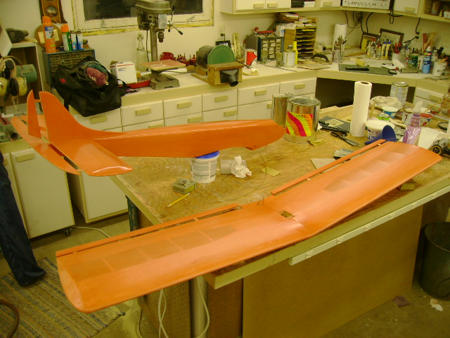

For such a simple airplane, it is certainly taking me a long time to get it done. Unfortunately there are other things in life besides models that require attention, most of them have priority. Anyway, progress is taking place. A few coats of Stits Poly Brush have been sprayed on and now Poly Spray has been applied. It appears to be ready for color. I am going with the red, white, and blue color sceme as shown on the plans. The white base might be sprayed on as soon this week-end. Then it is on to masking for blue and red color.

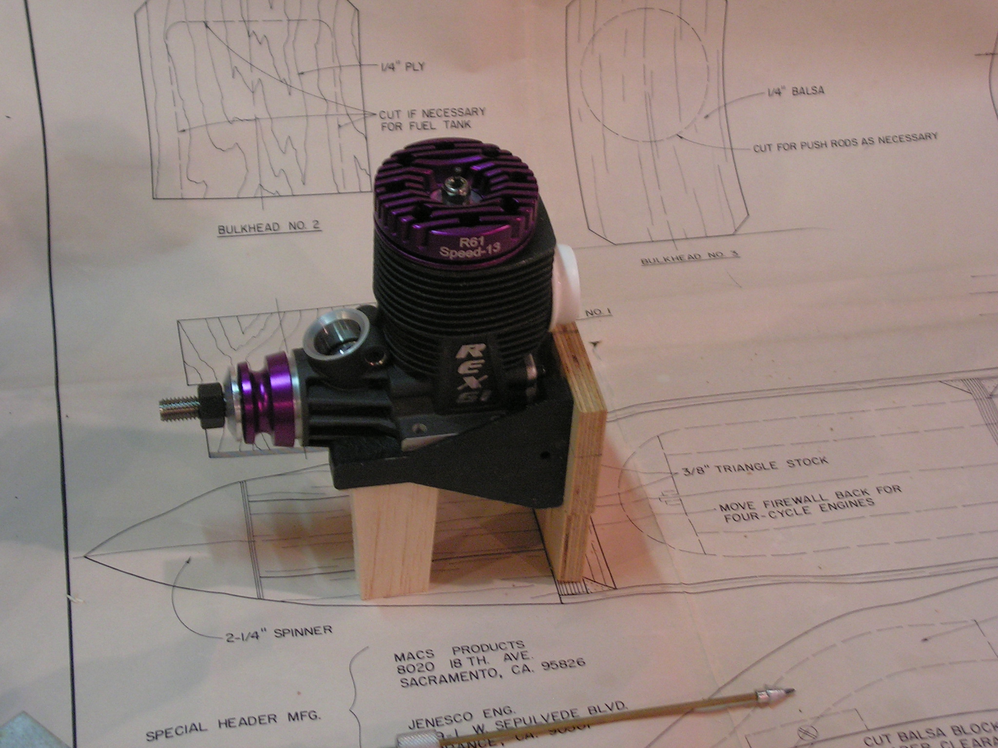

I was looking around for a good "ballistic" pattern of the 70's as either a scratch attempt or possibly a kit. I'm really
eyeballing one of the new YS .61FR Classics available. Little on the pricy side, but like the pressurized
system of a 2 stroke. Have an older YS .45FS and love it.
But, for a .60 size Pattern ship ( excluding GP's DB ARF) found out that http://www.bridiairplanes.com/ Aircraft will be
releasing kits of a few .60 size Pattern ships ... including the UFO and Great Escape.
Have also found the Curare is being offered by Eureka in a 2nd newer version that does not involve as much carving
as the original ( top turtle / tail empennage). a perfect candidate for the new YS .61 .

The Great Escape has been on the market for at least a month now. I have the UFO kit. I believe it is currently sold out.
GREAT kits!
Have you considered the NovaRossi Speed/13? No difference in power from the YS, but not pumped.... yet.
