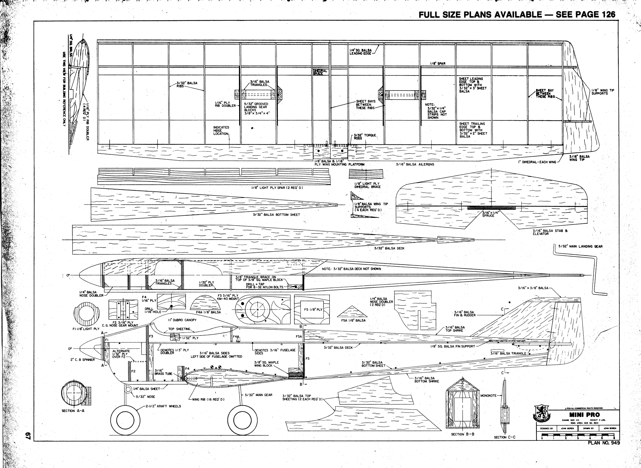

Found it.
It's called the Mini Pro
from the September 1985 RCM Magazine. Very cool looking IMO. The author designed it for a friend that wanted a plane to relace his Kadet
Perfect for you James if you are interested in building.
I'll finish scanning the complete article and post it later. It includes plans. Will be adding it to my long list of planes I'd like to build.

#31
Here's what the Mini Pro looks like in plan form.
I think my most favorite thing about this is the Kraft wheels shown on the plan.
Article+ included. ****Edit**** Not!!! Apparently RCM is not excepting pdf attachments.
If you want the RCM Mini Pro article PM me your email address and I'll send it along.
