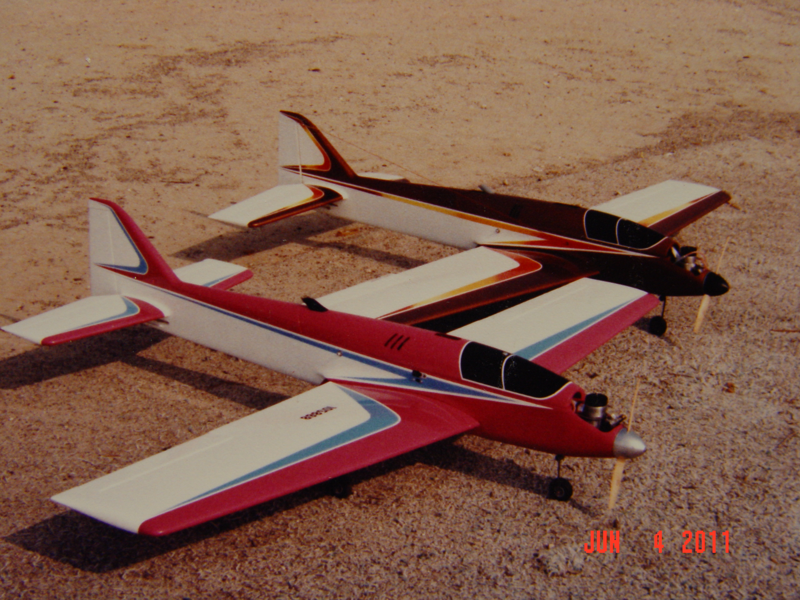

Here's my Rossi testbed......from 29 years ago.....kaff....kaff.
Super Scepter....kit by Craft-Air...Rossi RE with 9mm carb/in flight nv, Rohm retracts.
I got a lot of trophys with this airplane....I still have the trophies...and the airplane.
Don might be interested in making this kit...they fly really well.
It is an update of the Deception.
The problem back then as well as now is...to find a straight fuselage for Don.
The pink one is mine...the other one belonged to Richard Verano....note anhedral stab moved higher in the fuse...a big improvement.
Dave
Dave
