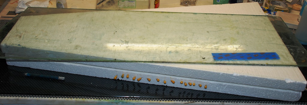

It started with a very accurately cut, perfectly symmetrical foam core. I had purchased 4 sets of cores from the guy who cut them to my specs back around 2000. The workmanship was exceptional, the best I ever saw. Two sets were built into wings for projects, I sold one and I still had one set remaining. I flew one of the wings in my Temptress for about 10 years. I loved the way the wing flew.
I honeycombed and sheeted the last set of cores a few years ago and just held on to the wing waiting for the right project. The wing was light enough at 10 ounces per panel (honeycombed cores, light wood, carbon veil inside) and super strong. But I've been thinking about getting panels even lighter from discussions with Dean Pappas and Bob Hunt. Bob especially has been talking about built up, 700 square inch wings that weigh in at 7 ounces. He also suggested the "lost foam" technique of building the wings. I tried the technique on a stab for my Delta last year and it worked well. If Bob could build a 700 square Control Line Stunt wing at 7 ounces, why couldn't I build a 500 square panel for Pattern at 6-7 ounces?
The idea of converting the last set of cores into tooling for built up panels was hatched. I proceeded to glass one panel with 2 ounce glass, which produced a good durable surface to sand against. I then cut the 15 stations at 2 1/4" width and sanded the balsa rib relief into each panel. I used a stiff bladed, 14 tooth per inch hack saw for the cutting and more teeth would have been better; the results were good.
If one decides to build tooling in similar fashion as me, he should use heavier foam 2-3 pound stock, and not necessarily sheet the foam. Simply glassing the foam with 2-3 ounce glass is all that's needed. In addition, it won't appreciably change the wing thickness. In my case, adding the extra 1/8" of balsa thickness increased the wing thickness from 11% to 11.5 % which is in the right direction for Pattern wings (I tried very thin, 9 1/2%, wings in my Delta and don't really care for them). Of course, overly thick wings make certain maneuvers more difficult to execute so for current F3A pattern, a thickness of around 11-12% is perfect.

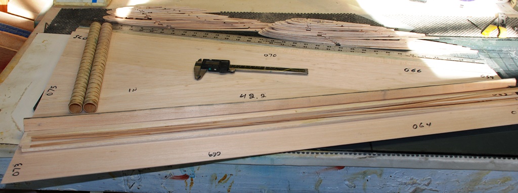

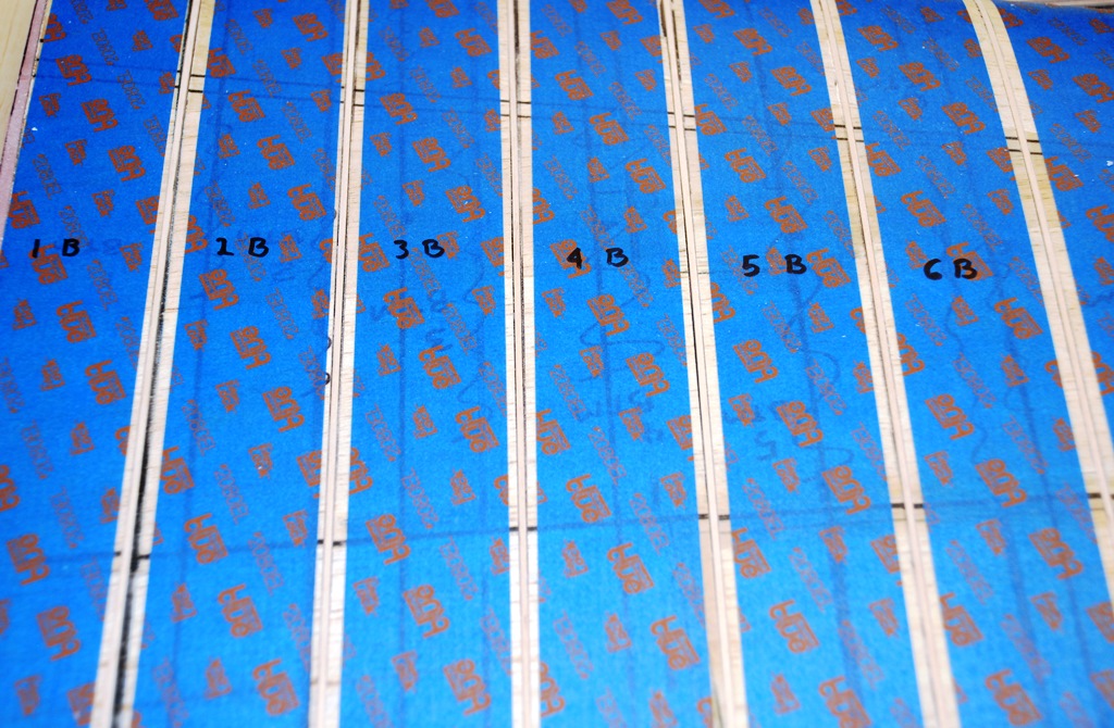

I have all wing parts ready for assembly. The skin weight is shown on the skin. The skins are first sealed using nitrate dope before assembly. This tends to eliminate skin buckle between the bays over time. The bays are 2 1/4" wide which also tends to reduce skin buckle.
The wing kit weighs just over 300 grams before assembly for both panels. Glue and sheer webbing will add maybe 20 more grams per panel.
Note the marked thicknesses along the skin: root is about 0.078", mid section is around 0.070" and tips are just under 0.060". Taper sanding the skins is straight forward with a few sanding blocks, each with different paper grades on. I start with 60 grit, then 120, then 180, then 320 and end with 400, making the surface ready for covering. It takes maybe 15 minutes per skin. It's messy but fast.
I first mark the surface with a Marks A Lot. The ink penetrates about 5 thou so when the ink is sanded off, I stop and measure. QED
This shows how the tooling stations are used. They space the ribs at the exact locations needed. The following ribs are just held against the station and tacked in place. The whole panel is assembled the same way. It goes very quickly since there's no guesswork and the alignment of each rib is better than the old way of building on a plan. At minimum, each rib is vertical
Once all ribs are in, thinned regular wood glue is applied. The top husk holds alignment as the glue dries. The socket is not glued in yet. The servo mount, aileron hard point and adjuster rib are added later.

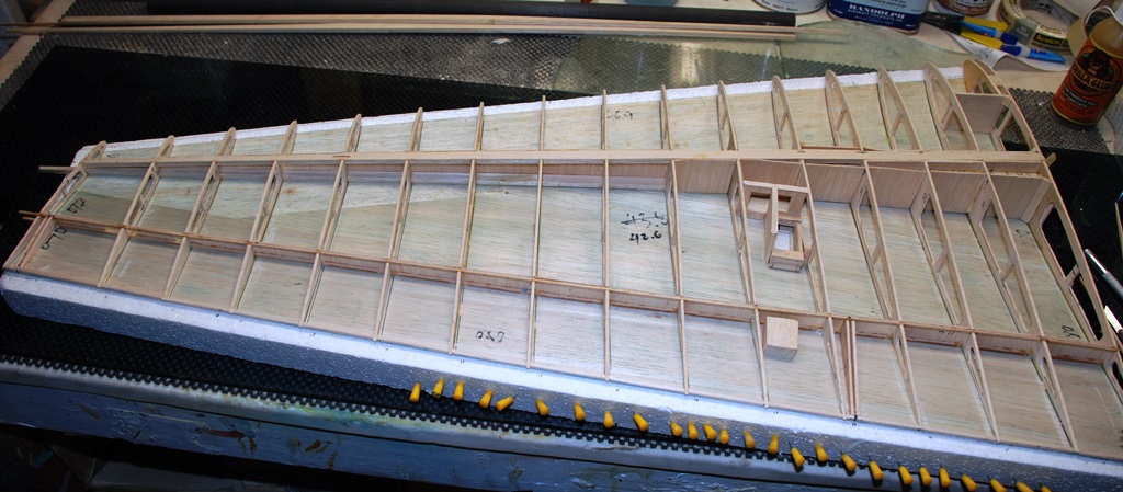

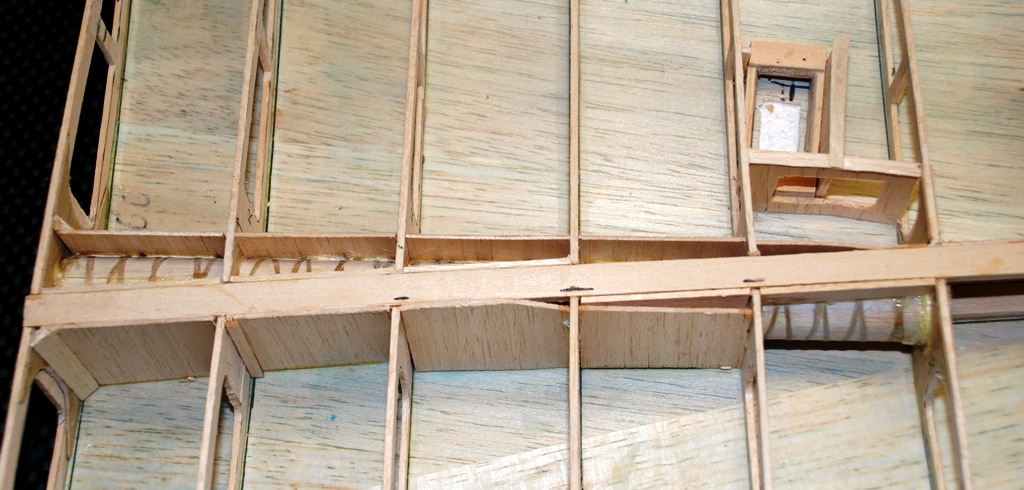

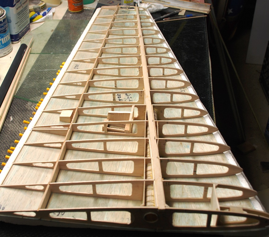

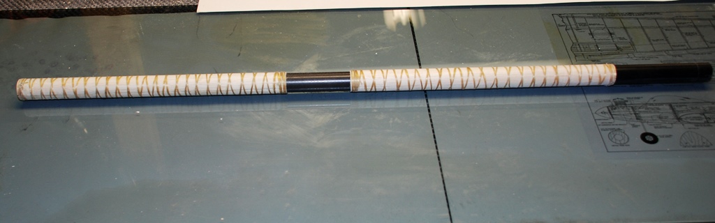

The tool provides the base on which the wing is constructed... Weight to this point is 130 grams.
Wing tube treatment. Shear webs on both sides to rib 6. Single Shear webs everywhere else
Thumbnails below show the ply rib for the adjuster and aileron servo and hard point

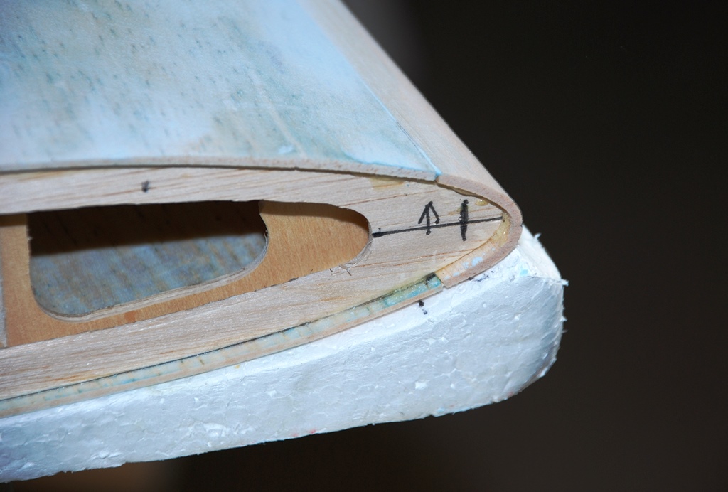

Here are a couple more snaps of the completed panel:
I've cut through most of the aileron but I leave it in until after the carbon tissue is on. It maintains aileron stability. I've decided to bed the carbon tissue first and follow it up with light weight Esaki Japanese tissue. The Esaki has a much finer, easier to fill surface. Both combined are lighter than 3/4 oz glass and epoxy.
Note how the molded LE was fitted. It's considerably lighter than working on a hunk of balsa. Plus it is easier to produce identical left and right LEs

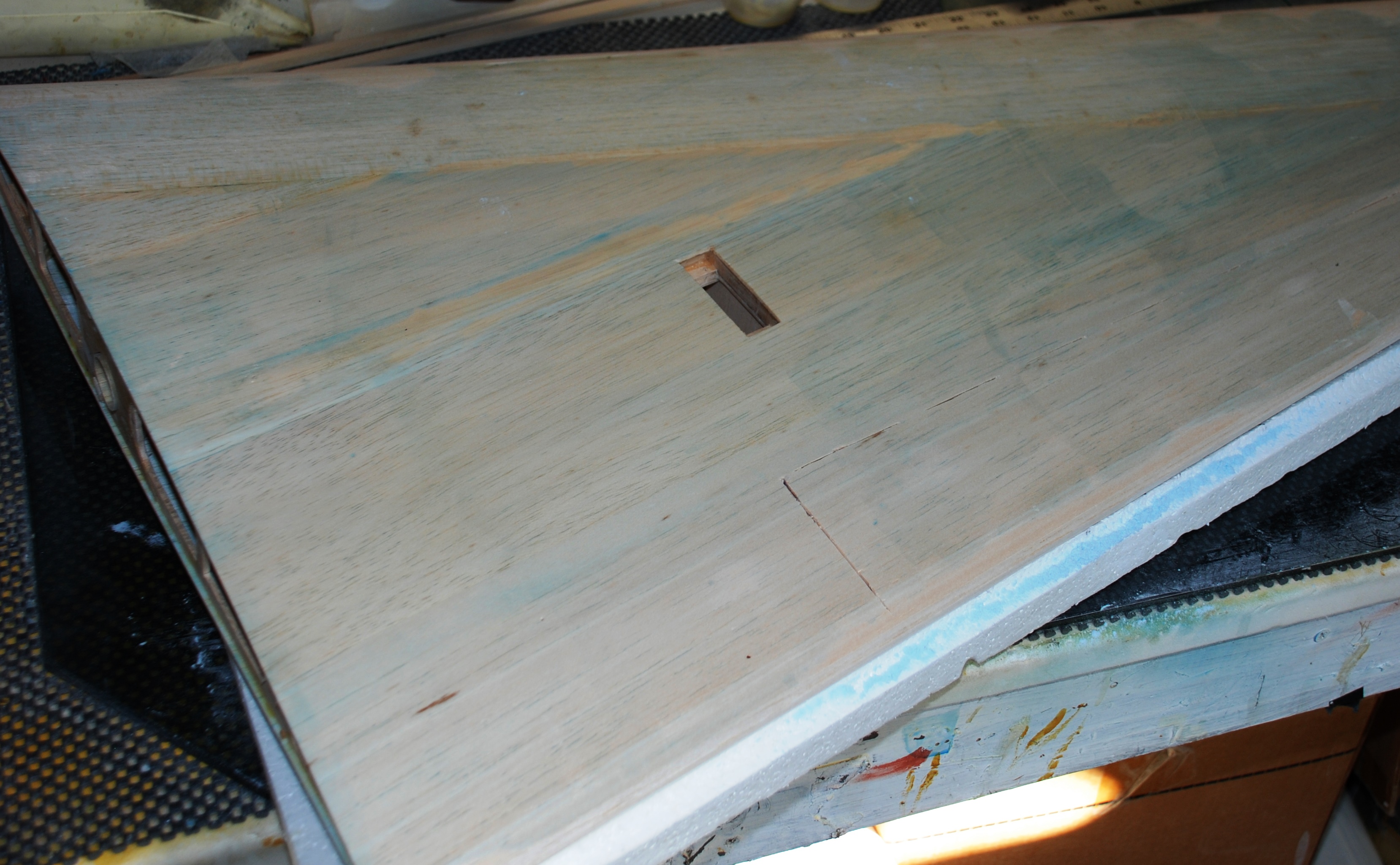

It took about 2 1/2 weeks but the carbon tissue and Esaki rice paper arrived today, yeay! I got the lightest carbon tissue (0.2 ounce) and all flavors of the Esaki available. Interestingly, the light and medium Esaki weigh the same at about 7 grams per 3/4 sq meter. The heavier grade weighs 13 grams. If you've never worked with Esaki, try it....
Sig carries it and calls it Plyspan (not Polyspan which is a nonwoven heat shrinkable plastic; great for open bays). BTW- for what it's worth, silkspan was slightly lighter grade for grade. But I've not been able to source silkspan anywhere. Regardless, Esaki from Sig is rather inexpensive at 2$ a sheet and is a little stronger than silkspan
I just completed bedding the carbon tissue using nitrate thinned about 75%. That's after prepping the wood with two coats of nitrate thinned 50%. I tried using blue tinted nitrate this time and I must confess that it was easier to see where I applied and where I had not. One can of tinted will always be in my shop from now on.
I also tried using the old credit card trick on the nitrate. We all have used this with glass and resin so it should be a familiar technique. It worked rather well, much better than I imagined. See, I had generally thought that nitrate just penetrates the wood and then flashes too fast. But my shop temp has been in the mid fifties so flashing was slowed enough to allow this age old technique. Doctor blading really saved a lot of brushing time and weight.
I actually doctor bladed the carbon tissue on too and that worked even better than any of my earlier trials on other projects. I'll post photos tomorrow. So far, after the tissue application, weight gain has been minimal. The panel weighs 210 grams or about 25 grams ahead of where I thought it would be.

Matt,
May have missed this but what do you do if your foam wing core has the flat leading edge? Can you still make a LE mold from this or do you have to make a mold before forming? I have a old EU1A kit that I was contemplating trying your built up method on.
maustin
Old 12-08-2015 | 08:07 AM
  #48
MTK
Joined: May 2004
Posts: 5,386
From: Whippany, NJ
Originally Posted by maustin
Matt,
maustin
Mike, there are a couple ways you can proceed. Assuming you have two identical cores, one core can be used to make the tool while the other can be used strictly for forming the LE. Both cores will need to have their LEs attached and formed as symmetrically as possible. I don't think you will be able to just form the appropriate LE when the back is flat.
I highly recommend that the foam be glassed with substantial glass and epoxy (2 ounce, but if you have 4 ounce on hand, fine; 3/4 ounce is likely too light to survive more than once or twice).
The ribs will need to have the LE contour cut when using each station, while the second intact panel will be used for LE molding.
BTW- LE molding that I did was done exactly this way. The first panel was cut into stations while the second was left intact and is used as the LE mold. To mold, I just wet the balsa sheet very well and carefully formed it around the panel LE. If you plan to use 3/32 balsa, use a medium 8 lb. stock and wet it for at least 30 minutes or it will crack. I hold the LE to shape using masking tape. 1/16" balsa forms easier than 3/32 as you would expect.
Or you may buy an LE forming tool for your specific wing from Bob Hunt. The tool Bob has created is a heavier grade foam block that has the precise LE shape cut out. He ends up with both the female cavity and the male plug. The male plug has been relieved of the balsa thickness.
The wet balsa is laid into the cavity and the male plug is fitted on top of the balsa. The whole thing is wrapped with an ACE bandage and allowed a couple days drying time. Cost is probably around 30$ give or take.
Yet another possibility, send the whole panel to Bob and have him cut you a complete foam tool from 2 lb foam. That is, the foam wing cut into as many stations as you want, each station relieved of the balsa rib thickness. You will also get the husks which will be the base onto which you will build the panels. Don't know what he might charge for this but at least tell him I sent you and he may cut you some slack.
EDIT: Mike something to think about is model speed and wing stress at that speed. 2 meter types fly at about 80 top speed since they are larger and power set up is for low rpm but high volume from the prop. They weigh 11 lbs tops so wing construction is designed to withstand that load.
Classics fly at around 110 top speed and weigh around 8 lbs give or take a lb. Wing loading is possibly a little greater for them. At minimum you want to cap the spars with 0.007 carbon strips or use larger spars than I used in mine (1/4 x 1/2" capped with 1/32 bass).

The panel with the carbon tissue applied. Two coats of 75% thinned nitrate down to this point. Esaki medium paper is next.
I am also starting the second panel build today. I am using a very thin coat of epoxy on inside of the skins to seal from moisture. I used only nitrate on the first panel but got a little bit of skin buckle between the bays (note the blue blotches under the carbon tissue; that's nitrate and microballoons mixed into a syrupy slurry and painted onto the wing to raise the surface slightly. Nitrate and microballoons has got to be the easiest sanding and feathering filler for larger areas I've even concocted; adds nearly no weight and feathers beautifully)
