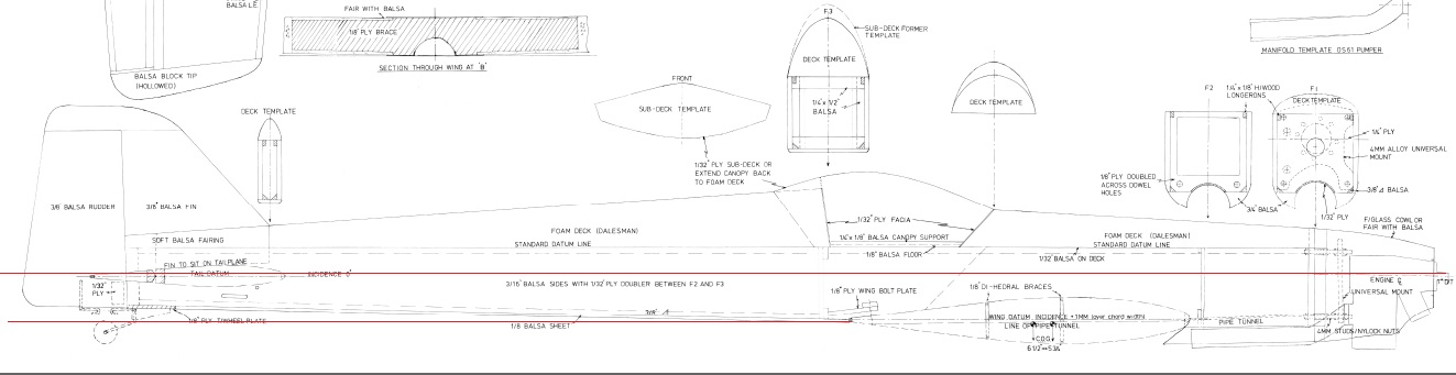

I recently found a plan which seems to be a good duplication of Hanno's Supra Star called "Dupli Star"
I read the plan carefully and found that there is just a little part of the rudder surface under the thrust line and most of its area is off centered
I'm thinking of modifying the plan to have more rudder area under the thrust line in order to have more axial slow rolls and knife edges
is this a good idea to add a ventral fin or widening the fuse side area as shown in the image below? or the original profile is ok?

Personally I wouldn't. I would hazard a guess and say you'd need more rudder to sustain KE as your centre of pressure will move back, as your area does.
Also, the dupli star isn't a supra fly, did you want to do a supra fly or a supra star?

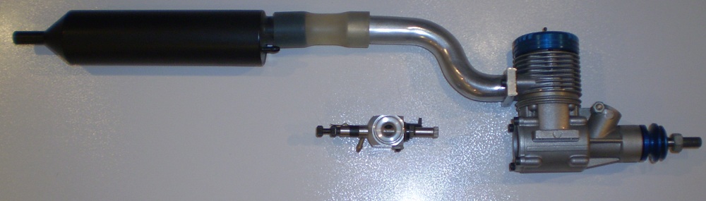

I'm thinking of a 145 cm (56.6 in) span SS powered with a rear exhaust MVVS .49
weight around 2400 gr (5.3 lbs)
Ehsan

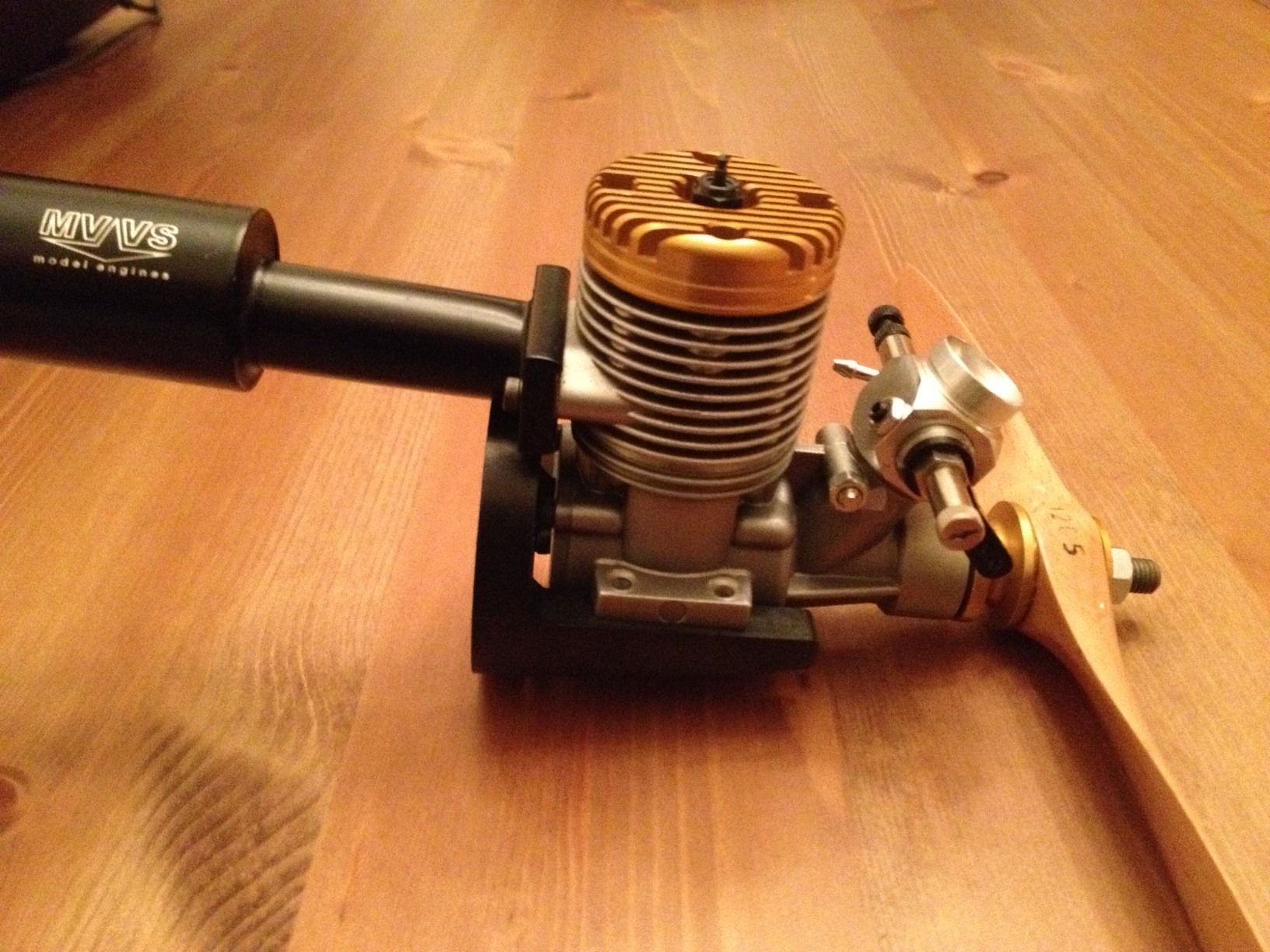

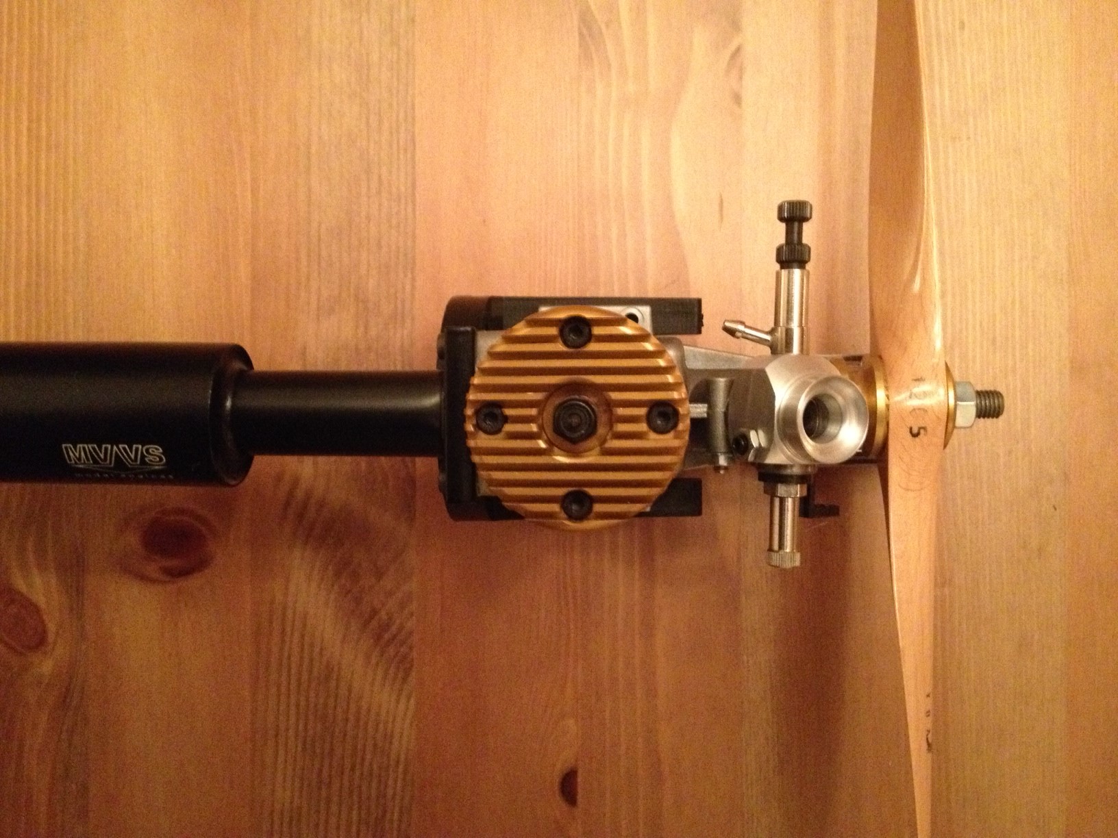

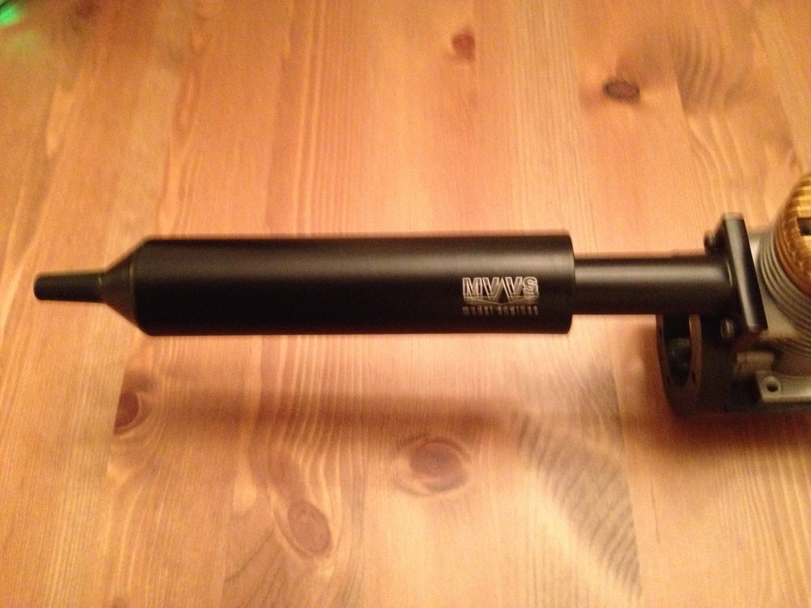

Right

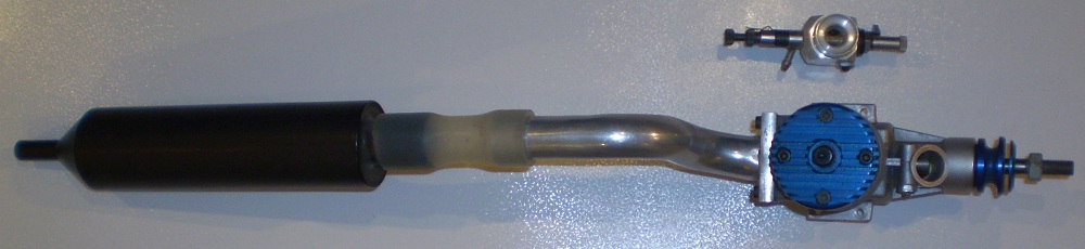

, This is my mvvs .49 beautiful colors...
Ehsan

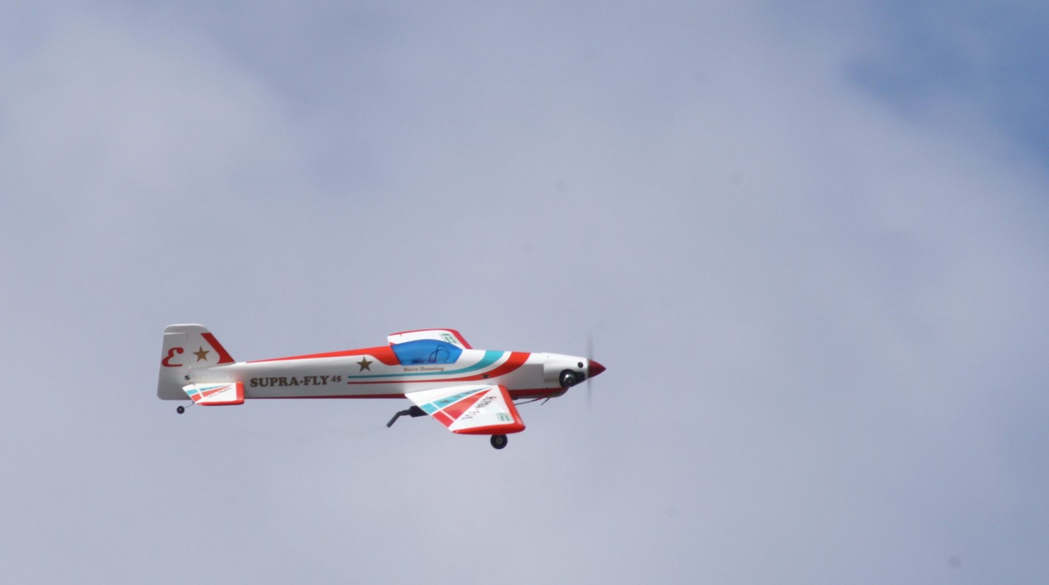

This is a Supra Fly 45 that I made after taking measurements from an un-built kit. Powered by an OS 45 FSR (brand new) and weighing in at 5.5lbs, the model has a fantastic performance. Highly recommended.

Your Supra Fly is one of the best of is type, fine finishing.
Shall I ask you a question?
would you mind telling me the wing span?
Is it equiped with retractable landing gears?
Ehsan

Hi all. Model specs are:
Wingspan 1475mm (58")
Length (incl spinner) 1425 (56")
Stab span 598mm (24")
Weight 5.5lb (2.5kg)
JR 591 on rudder, elevator, throttle
Spektrum 6200 Digi on ailerons
OS 45 FSR with Just Engines Purple Pipe
