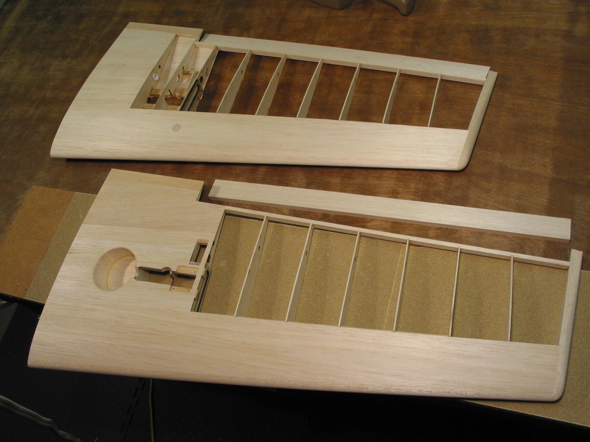

Thanks Yes the Arrow was a perfect E-power subject. I use iron-on-paint (MonoKote).
The data log is posting 61A full T early in the flight with 19V (1169 W). Late if the flight I'm seeing about 55A
I can no longer fly full T all the time and I have a 4 flight average of 26A (446 W). The longest of the four flights was10 min. I don't keep charge records and don't recall ever pulling a battery below about 3.6V / cell. The Arrow and a scale airplane get used 5S pattern packs or twin 3S (6S). I should also mention that in the re-design I thinned the wing also.
I don't have very many photos of this build. but here's one of the wings before covering.
Jim

Jim,
very nicely built! One can see how you saved a fair amount of weight.
Did you mount the motor on the original position firewall with standoffs or do you have a nose ring front mount setup with motor access through the top?
What kind of RPM is the Power-52 turning on the 12x12 and 5s? 6s? About 10.5K and 12.6K, respectively at full charge?
Is your wing foil down to about 14% thickness? Good penetration and speed through maneuvers now?
What kind of e-tracts are you using? Have they been reliable on the model?
I hope you don't mind the many questions - your model is quite unique among the few electric classics!
David

Dave,
The motor is rear mounted using the adaptor that comes with the motor. The firewall was located to accommodate the motor. Yes it installs from the rear through the top opening. This allowed a more open front for cooling air which comes in through a cut-off-nose Great Planes spinner (GMPQ 4772) which has a spoke aluminum back plate.
I haven't tacked it but the data log shows 9787 peak RPM with 5S (20.7V max)
Wing is about 13%, penetration and speed OK, but I've been spoiled flying large turnaround pattern airplanes (10S) with virtually unlimited performance.
E-Flite 25 - 46 Tri-Gear retracts have ben reliable using a separate receiver power source (2S Lipo & 10A Castle regulator. They were unreliable using the 75 A ESC-BEC, probably spiking the initial current draw beyond what is supplied, not locking in the electrical start signal on all three every time. I don't have the necessary test equipment to confirm the current surge when activated.
With 6S I probably would back off to a 12-10 prop. If I had ground clearance for a 13" prop I'd probably run one.
Here are a couple more photos. As you can see in the photo the retract quality is absolutely assume, a little pricy but I'll never setup mechanical retracts again.
Yes this is the seventh Arrow I've built, 6 glow powered in the 80's before we changed to turnaround style pattern.
Jim
