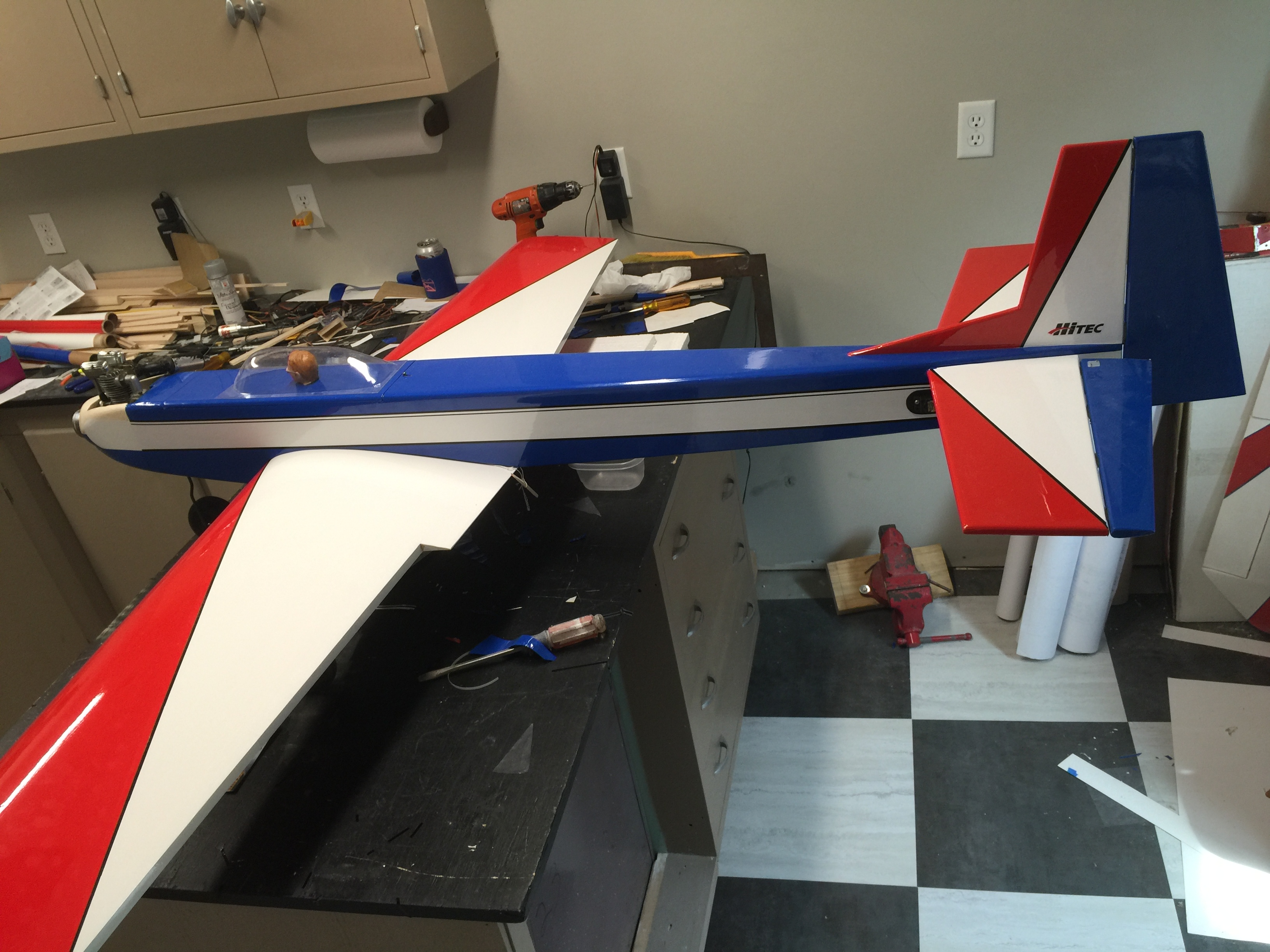

So here's a few photos of the progress so far. Everything mocked up, with the gear bolted in. I'm still adjusting the fit of the nose gear, but now have it just about right.

Yesterday I put all of the pieces roughly in place so I could get a sense of the CG. I was pleasantly surprised to see that it needed some tail weight. This allowed me to move the elevator servos from the wing saddle area back to the tail, and do away with the solid wire pushrods and tubes that I had in there. I have the rear servo mounts in place now, waiting for the glue to dry.
