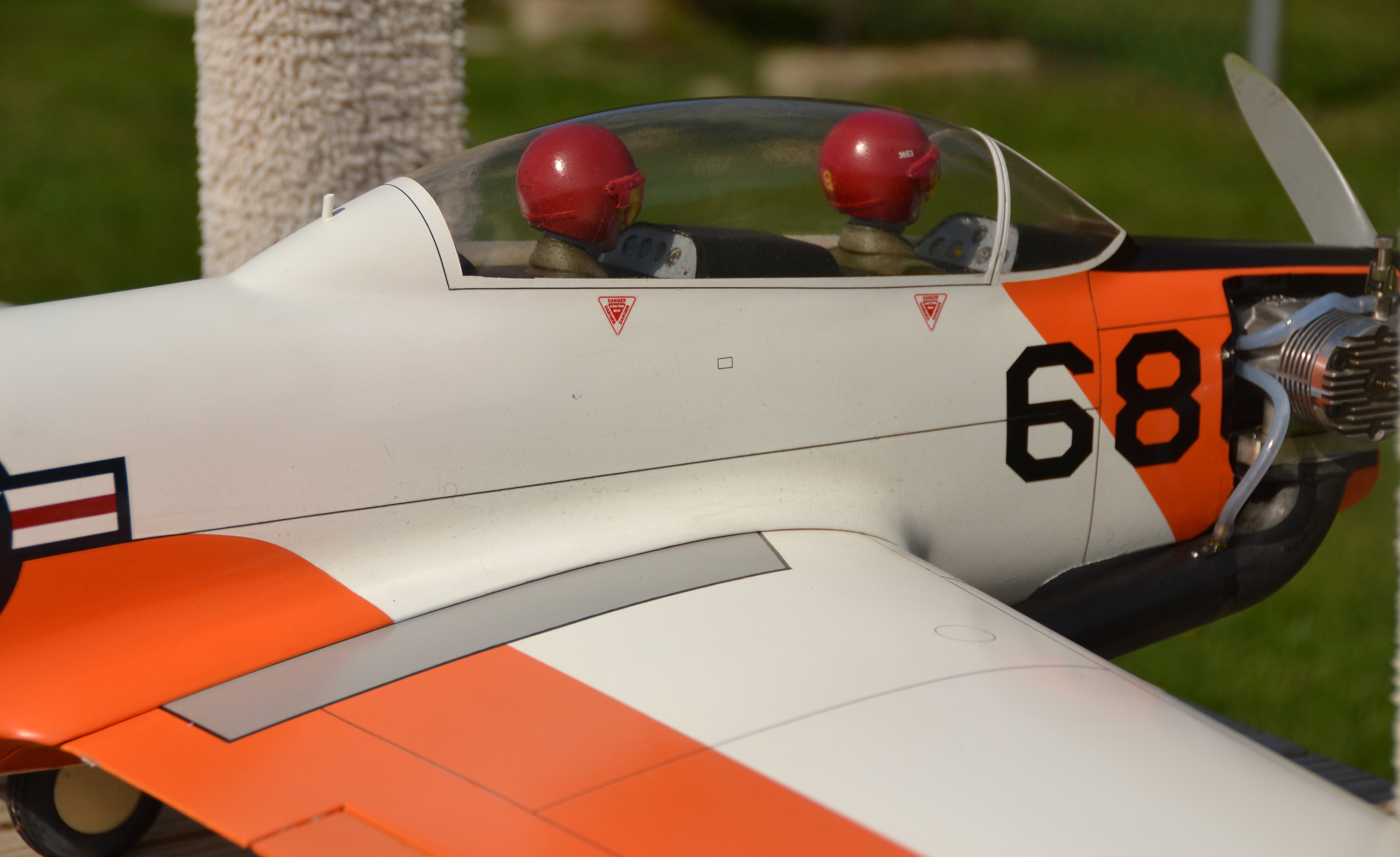

Enya .60 AAC Mk. IV w/ the Macs black pipe and adapter. A little bark but great improvement over a stock muffler.[ATTACH]2172052[/IMG]
