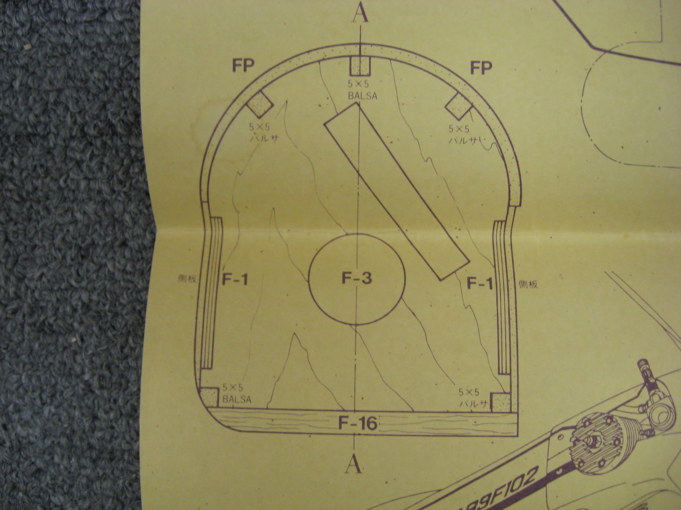

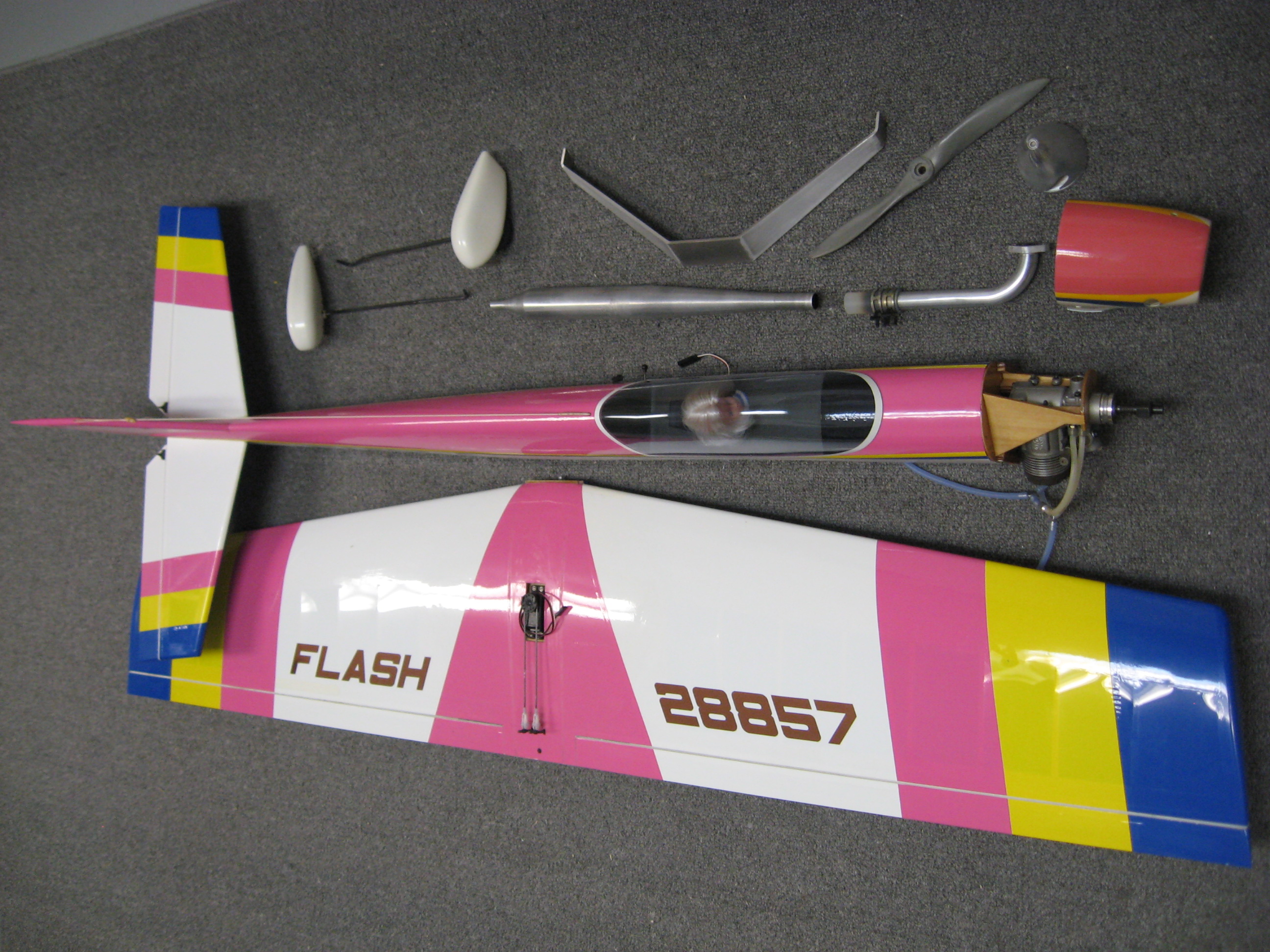

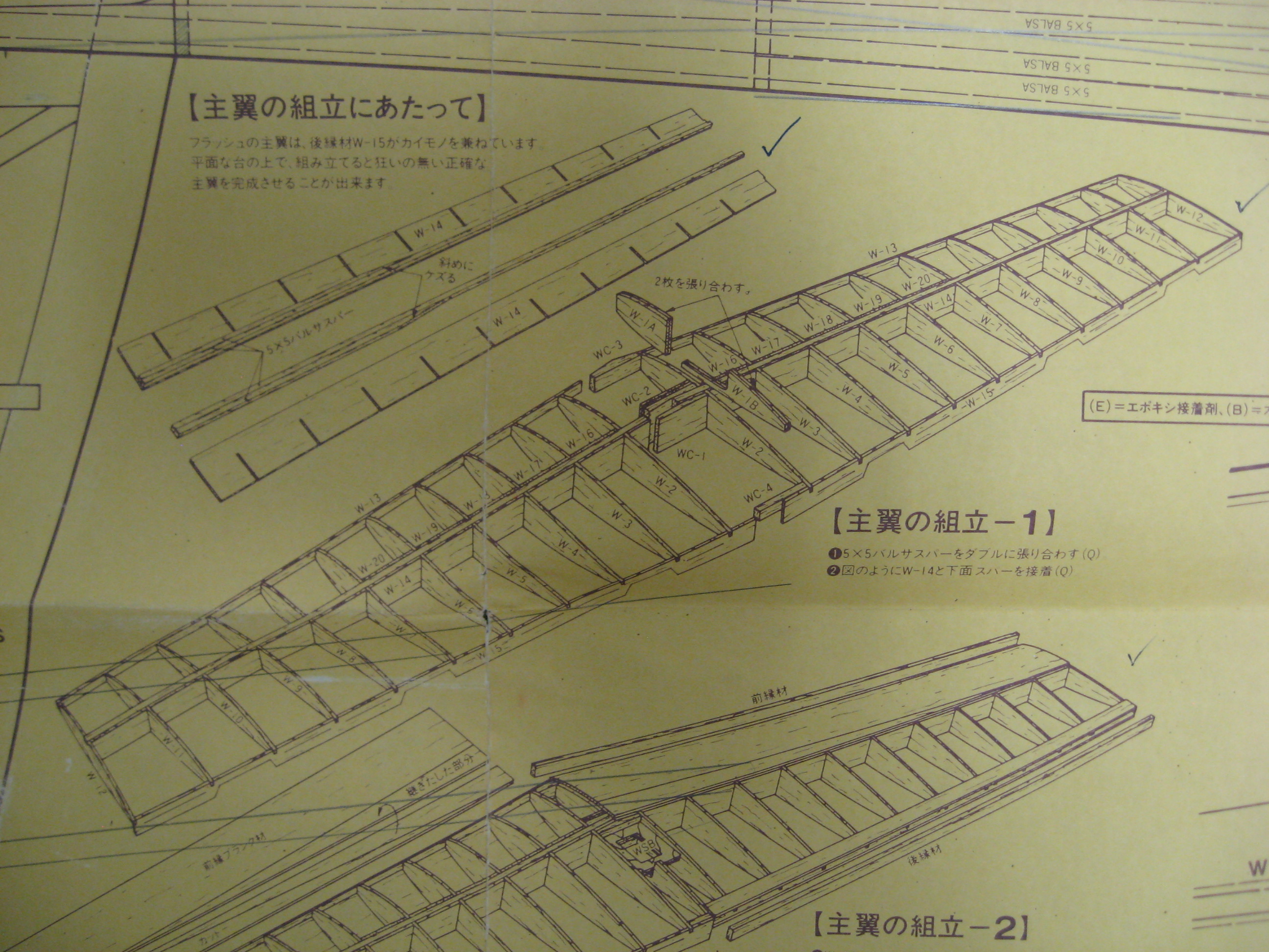

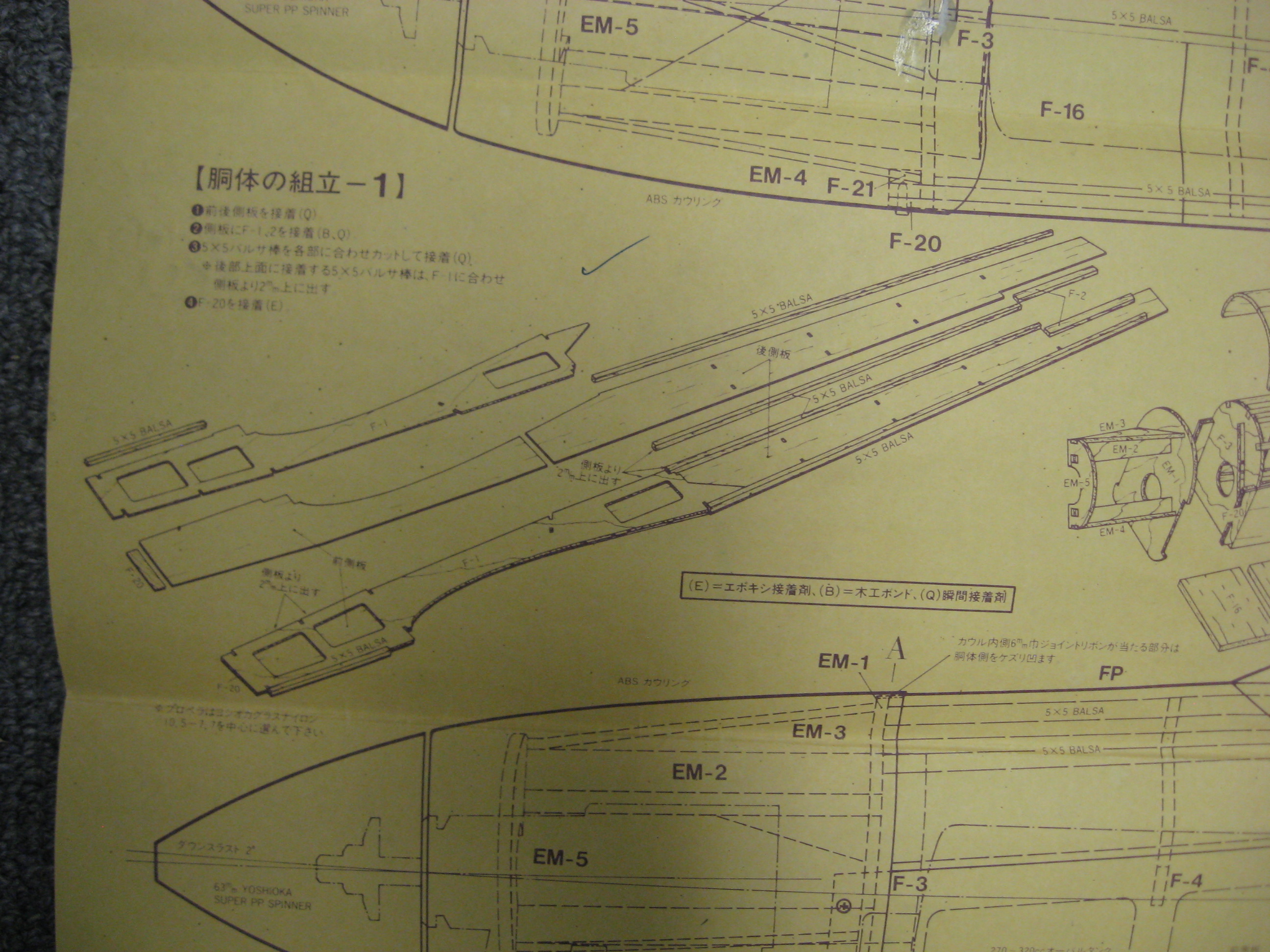

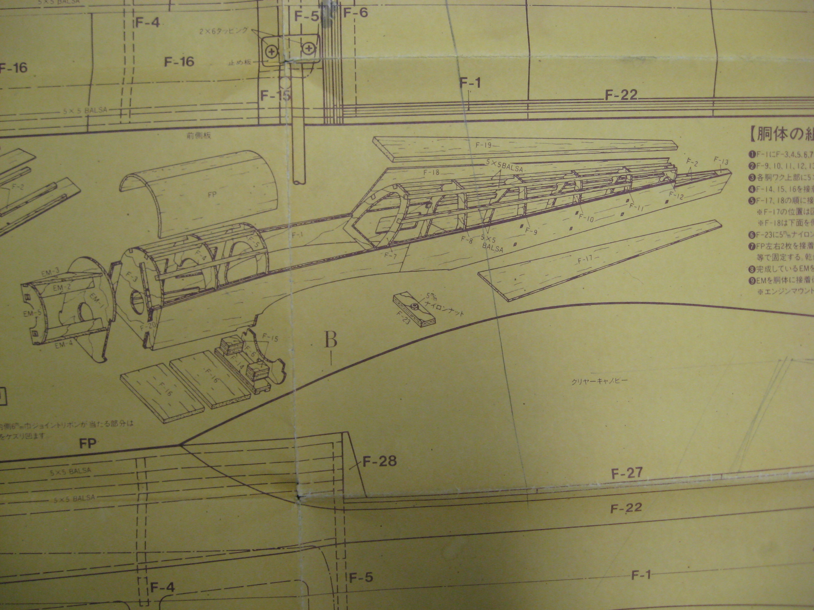

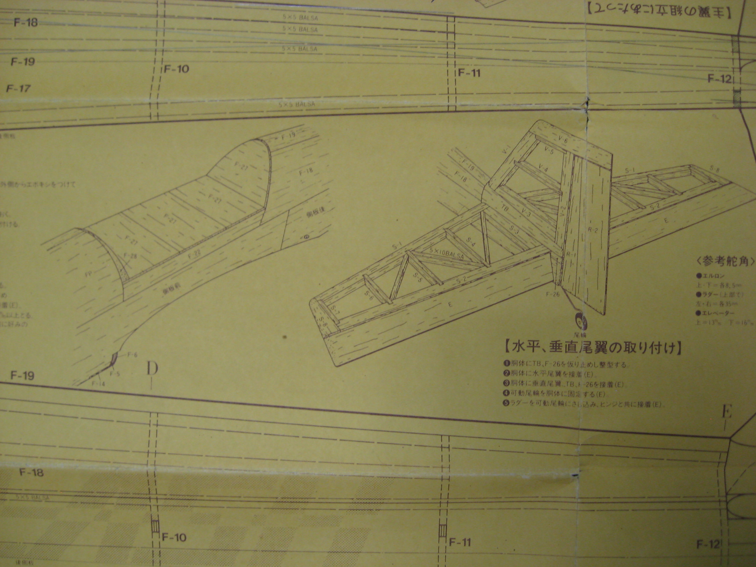

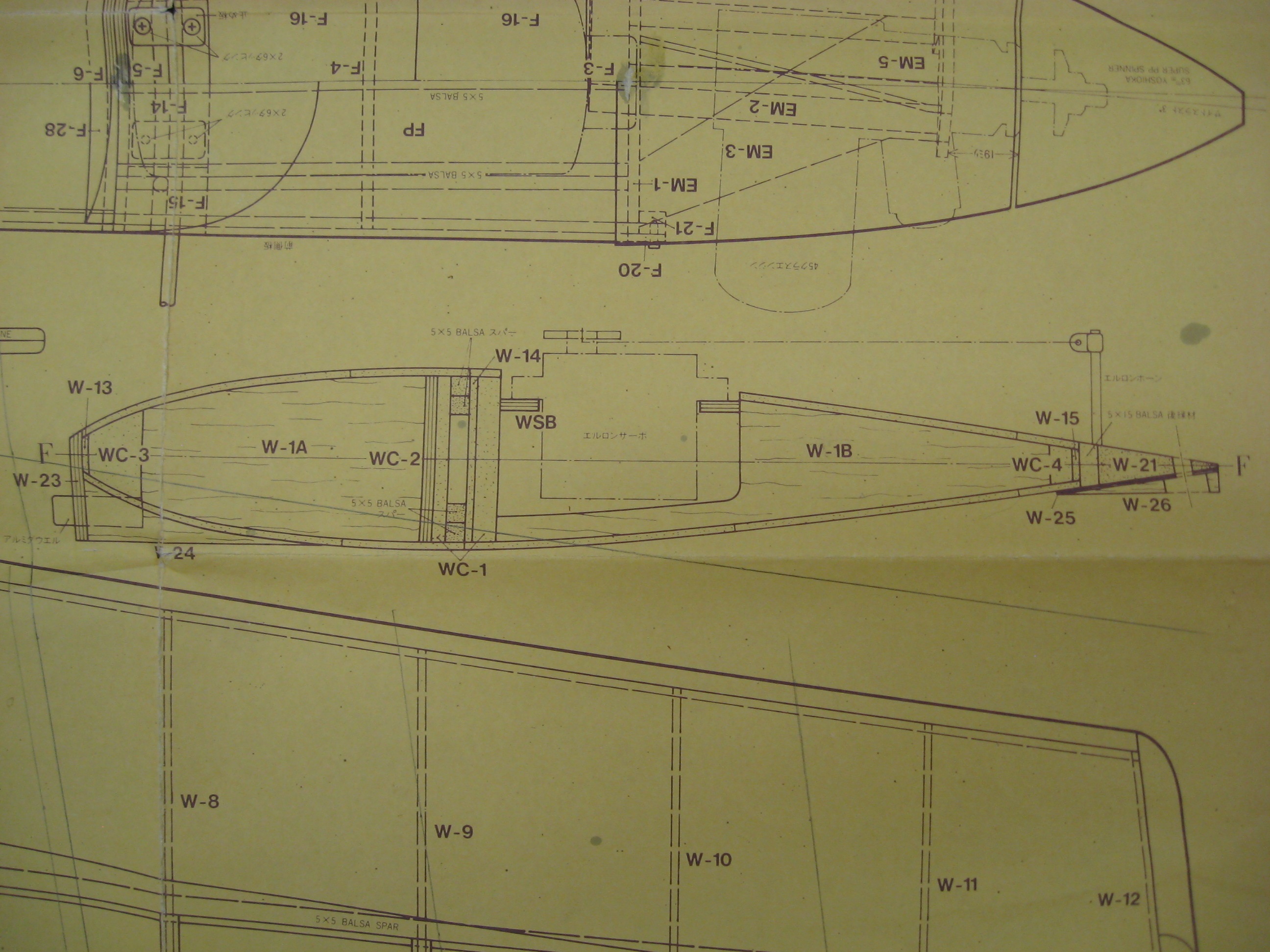

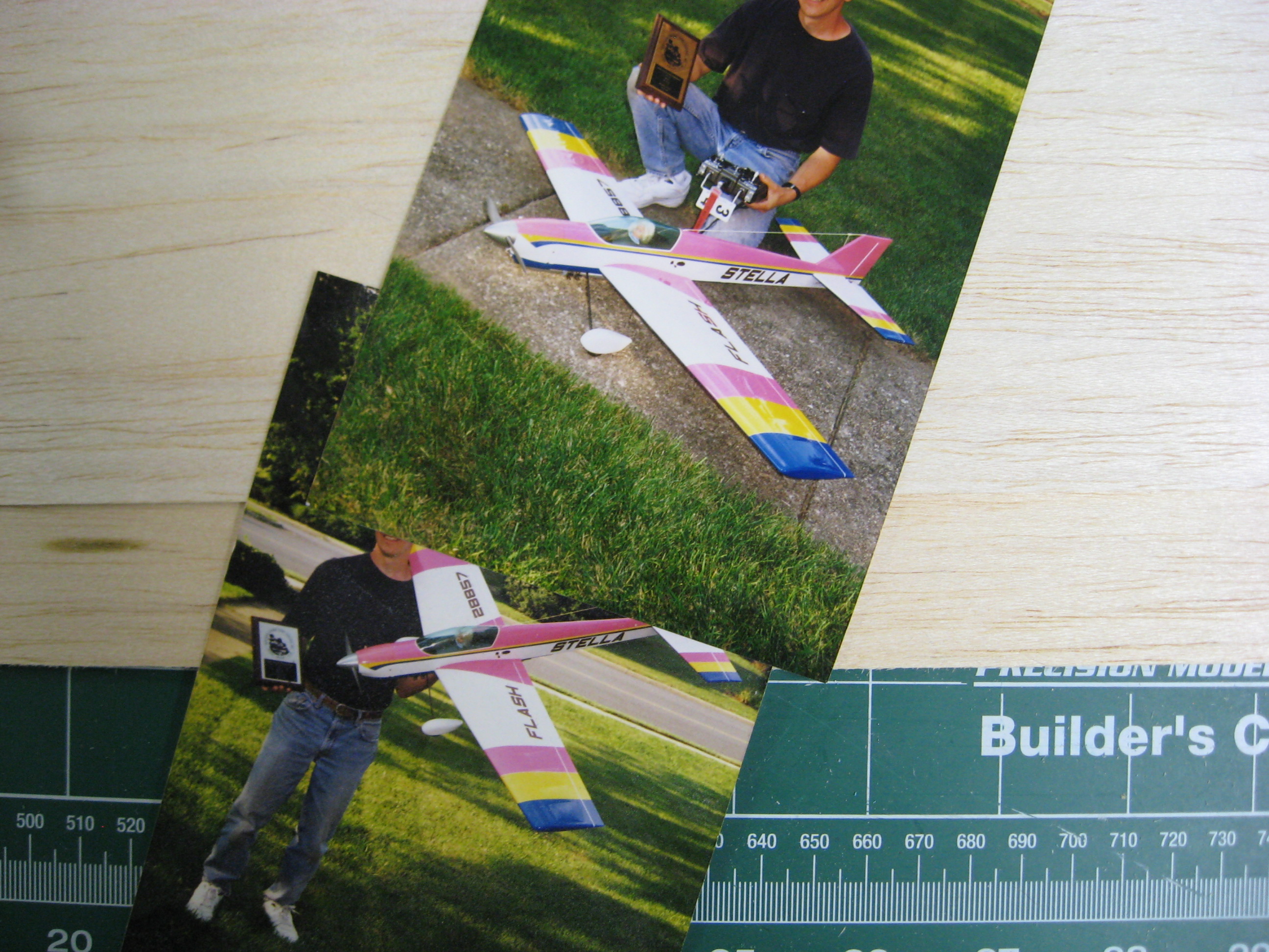

Pics of Flash used for local novice pattern entry - some might say: well, whup-dee-do - and another of the airplane in it's present state prior to planned resurrection with custom aluminum gear and perhaps dual, dedicated aileron servos...
Likewise - not the Flash S but the Flash (45-sized) built over 20 years ago. The plans are folded, not rolled, so they show significant wear after repeated folding/unfolding. All printed instructions are on the plans and in Japanese so unless you can read the language, build process is derived from studying the drawings on the plans and the interlocking feature as stated by flywilly.
Hoping these pics may help.

Hi H5606, thanks very much for your help with the pictures of your Flash plan. The pictures are of great help.

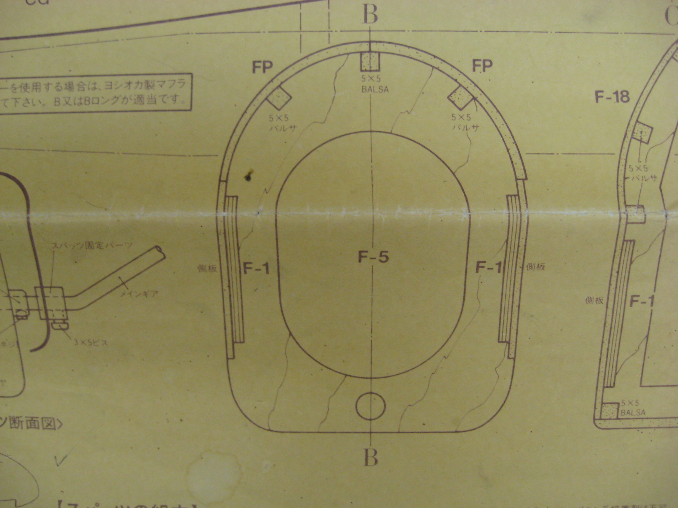

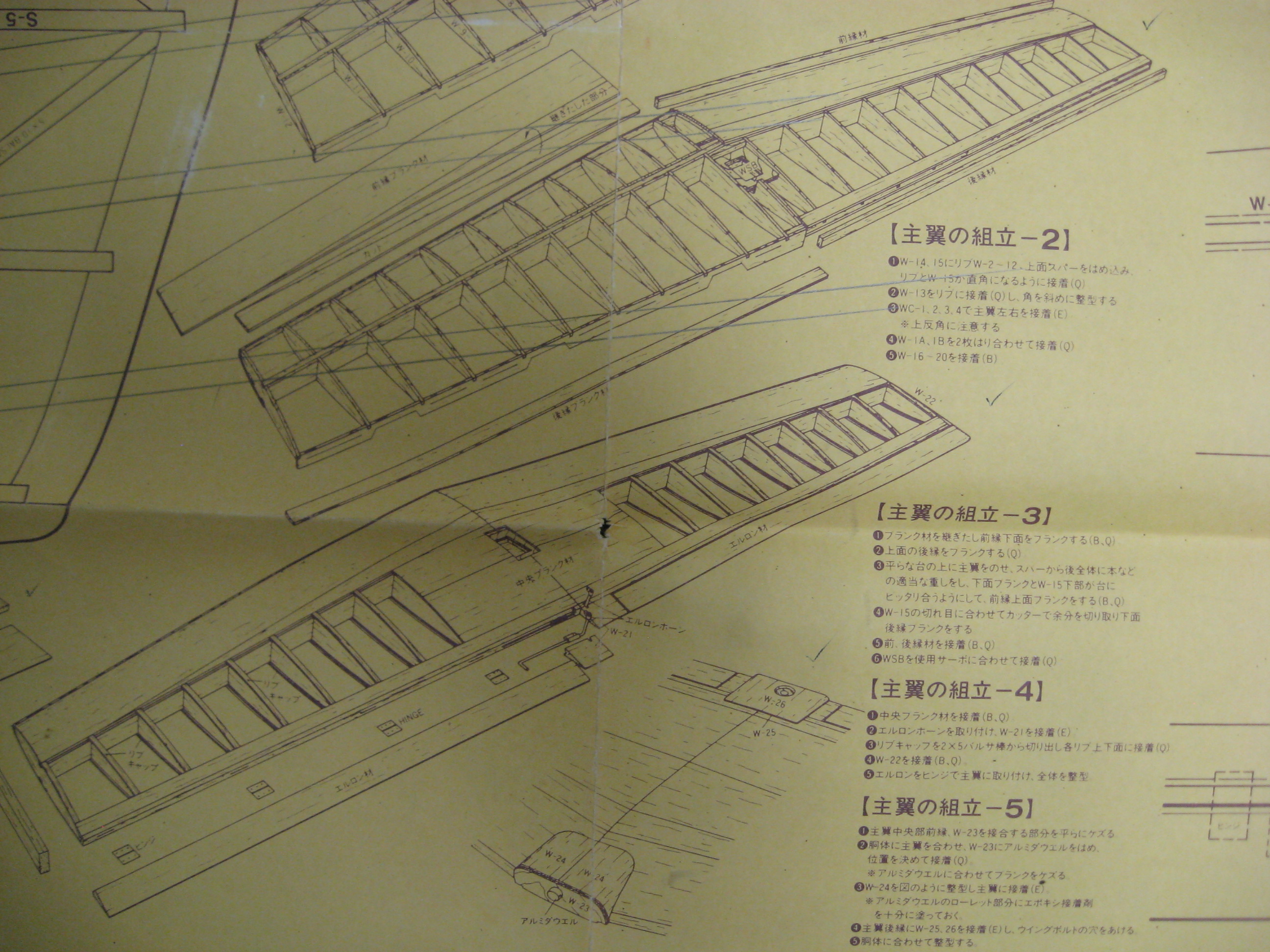

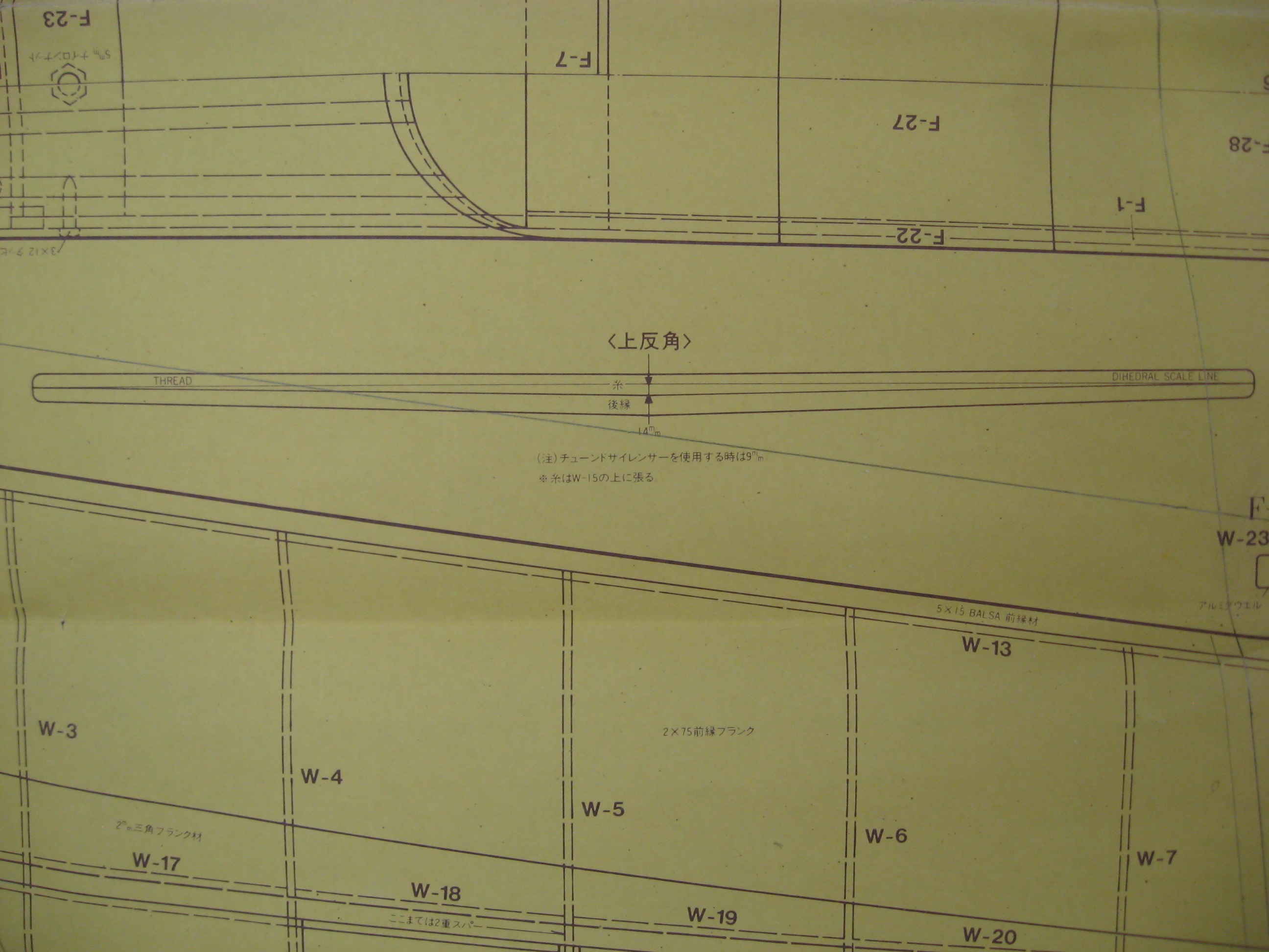

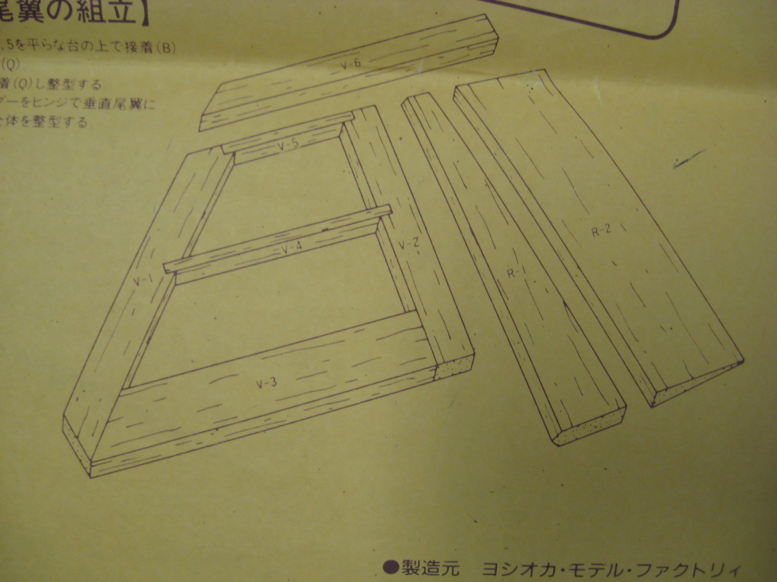

After some deliberation, decided more info may be beneficial: perhaps using 57" wingspan (28.5" each side) and the 14mm shown here can give some idea of appropriate dihedral angle... Including other info that may be of importance. Really happy to hear it helps; please don't hesitate to ask for other close-up detail shots.
Always felt that the landing gear (undercarriage) was too far forward making the model unstable during take-offs (wanting to ground-loop); eventually raked wire gear aft and fabricated the aluminum landing gear pictured in the second pic of my previous post with considerable rake aft to bring it back where it was thought the main wheels should be to try to alleviate this problem (wheels just under L.E. when viewed from above).
One side note about Yoshioka kits - they were so well engineered and packed that it seemed if you took a few too many pieces out of the kit box to examine, you would never get them back in the same orientation to be able to close the box lid entirely again...

Indeed.. Thanks H5606 for the additional pictures, plenty for me to see how the model assembles.
