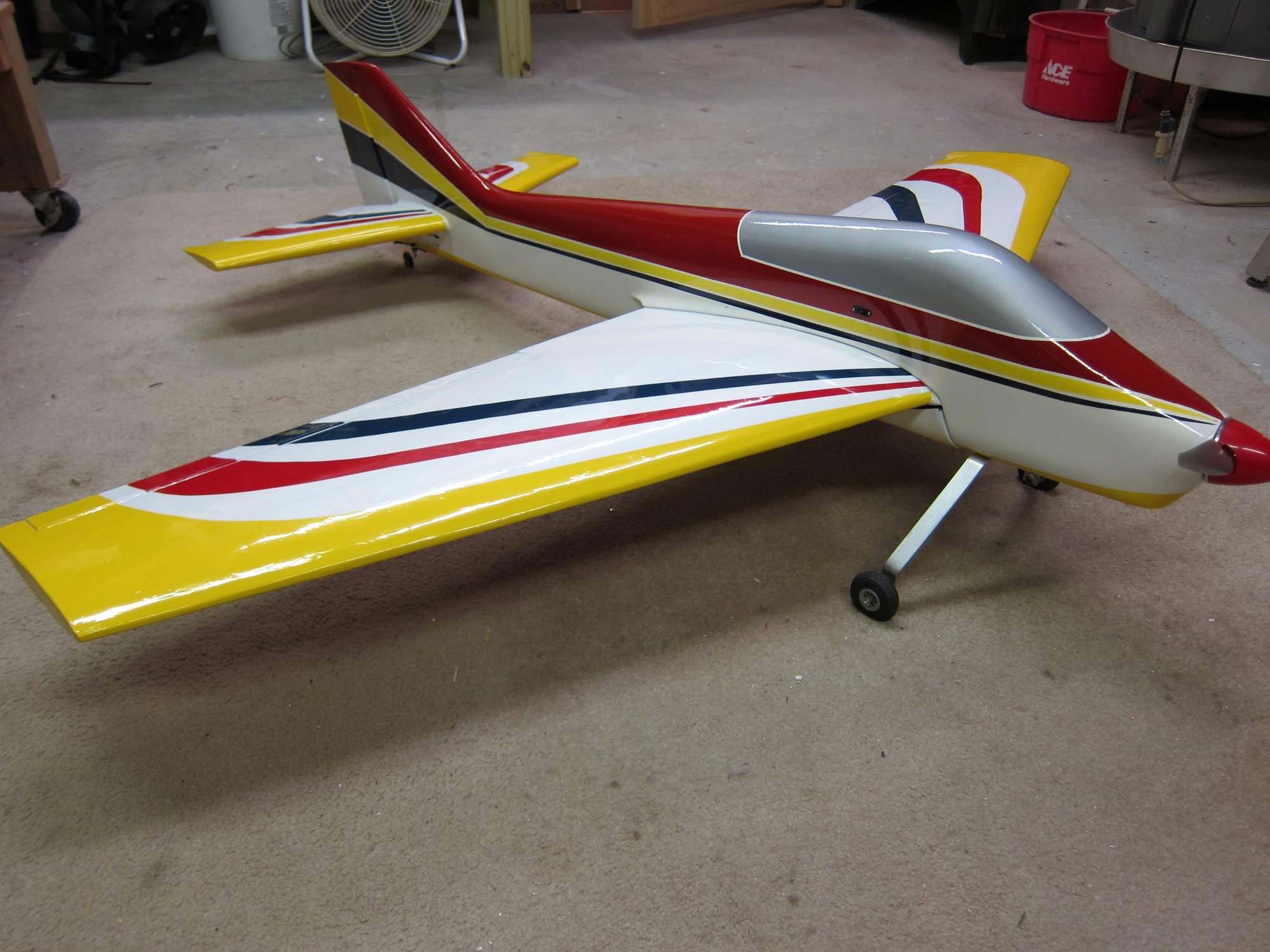

Some pictures of my newly completed electric Brushfire

Looks really nice, can I ask about your power system? I have an MK Arrow that I'm 99% decided to make electric and am having trouble finding what I think would be an appropriate motor. I was hoping to find something around 45mm diameter outrunner that is around 800KV. The goal is to spin an APC 11x10E in the 10K-12K range.

I used a 500KV motor with an 80AMP ESC spinning an APC 15x6. The battery is a 6S 5500 mAH. Flying weight is 8.1 lbs. (the battery alone weighs 1.3 lbs).
