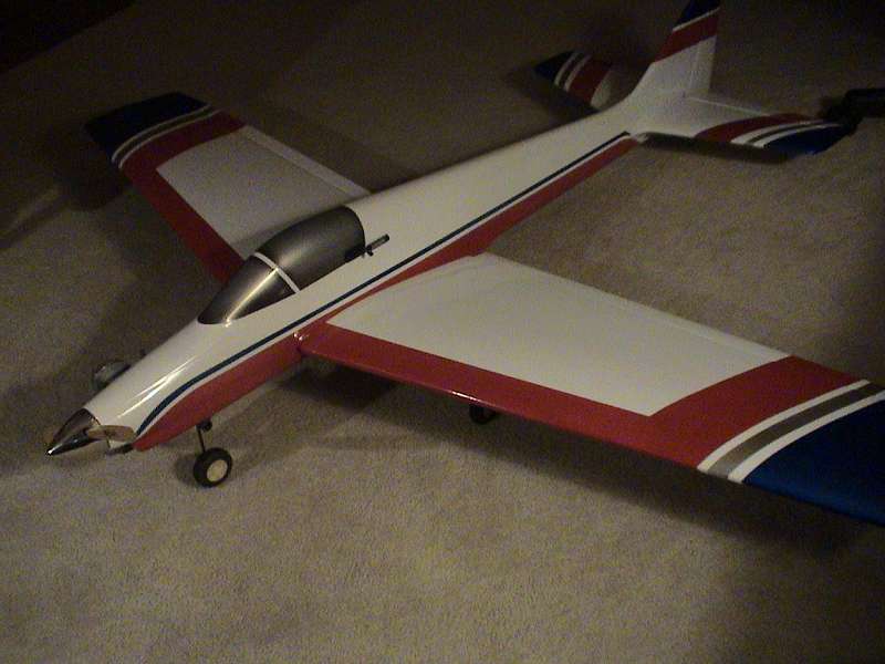

Default RE: Phoenix 8 trim problem
Tommy,
Tony and Kjeld are certainly right.. it's a Magic... matter of fact, I bought a hatori header for a YS 60 for one and never got the kit !!! Still have that puppy. It takes the R/E and puts it to the top of the fuse tunnel. At any rate, I'd certainly finish it...
Dan

Tommy,
Here is a pic of a completed one. I don't know who to give credit for the build to as it's just from my archieves. Pretty plane !!!
Dan

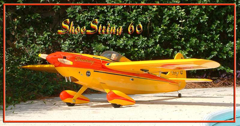

Dan,
Thanks for that information. I am trying to check that out here and will post an image with this reply.
Dan, think I've got it now. This is a picture of my Shoestring 1/4 scale and yours truly at the field for the second time in 22 years.
Thanks, Tommy

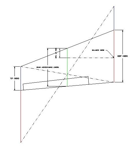

[img][/img]
A good place to start is to balance at 25% of the wing mean aerodynamic chord. Here is how to calculate that position graphically.
Draw the wing planform full size. Draw a line from one end of the tip chord to the opposite end of the root chord. Now measure the root chord and add it to the tip chord as per the sketch. Do the same with tip chord and add it to the root chord. Draw a line connecting the ends of these new lines as per the sketch. Where these lines cross is the Mean Aerodynamic Chord for the wing. Draw a line chordwise at this point. Measure back 25% along the M.A.C. Project this line onto the fuselage and this is where to balance the model.
This is a safe starting point which you can work back from.
Hope this helps
Malcolm

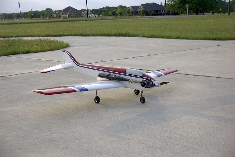

Here are the Atlanta pics...

ORIGINAL: big_G
Big G,
Your Atlanta is so highly modified that it looks just like a Curare. How did you do that?
Old 05-07-2005 | 07:14 PM
  #47
Joined: Feb 2005
Posts: 432
Received 25 Likes on 16 Posts
From: Hutto, TX
Not modified at all, build exactly as designed...although many pattern planes of that era looked similar....big_G
