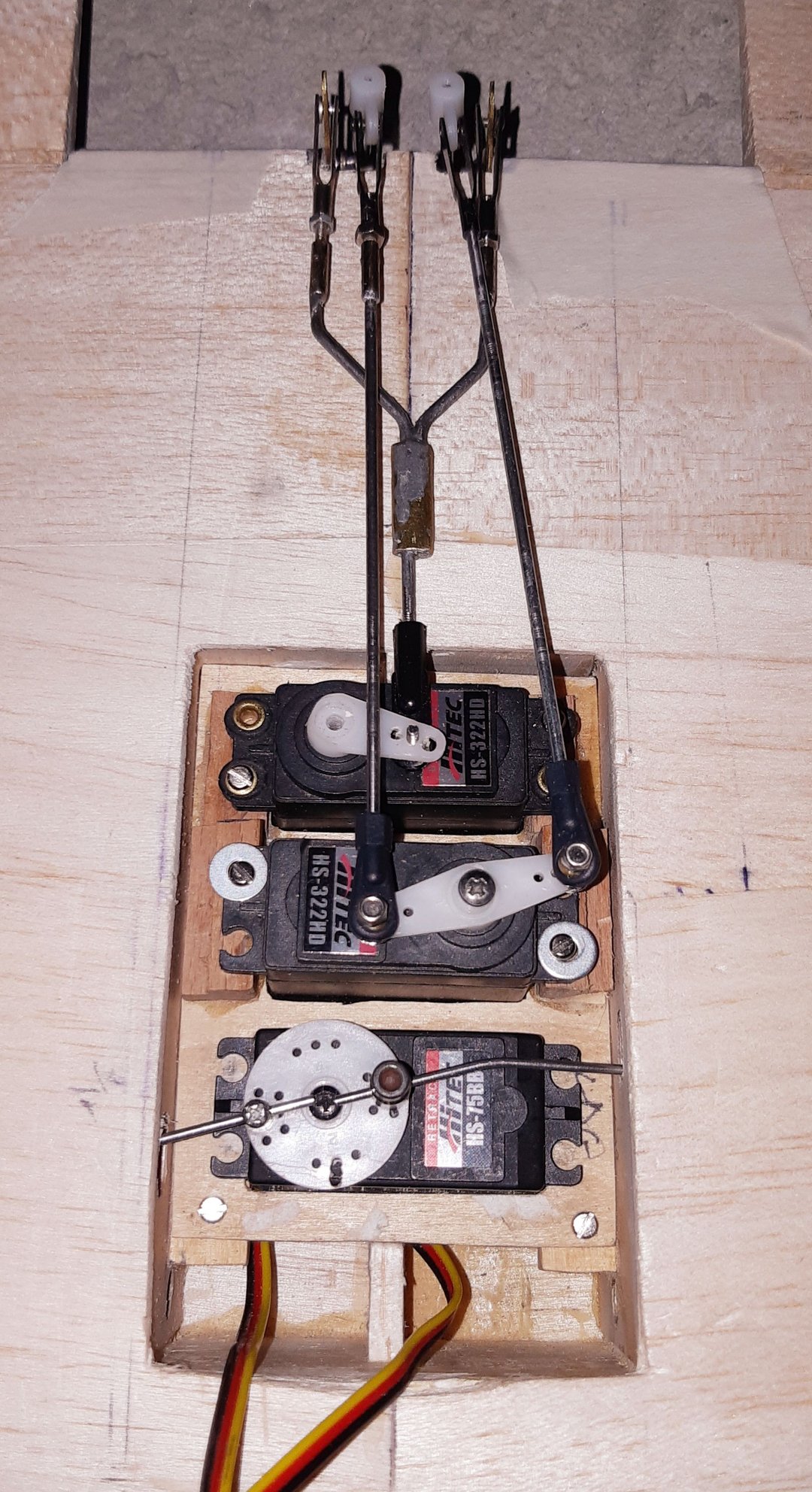

Default Wing retracts
Hello Everyone, I am building a Curare from MK plans. I have opted for a single wing servo for both main retracts as per MK plan. I am looking for help on solutions and would love to see pictures of something already done in particular installlation of servo and rods to mechanical retracts. Here is the link to my build
www.baronerosso.it/forum/aeromodellismo-volo-scoppio
/374508-curare-scratch-build-17.html
thank you in advance for your help.

Here is my setup. Planning for 1 servo center wing.
here is the link to my curare build.
https://www.baronerosso.it/forum/aer...ml#post5140219
https://www.baronerosso.it/forum/aeromodellismo-volo-scoppio/374508-curare-scratch-build-17.html#post5140219

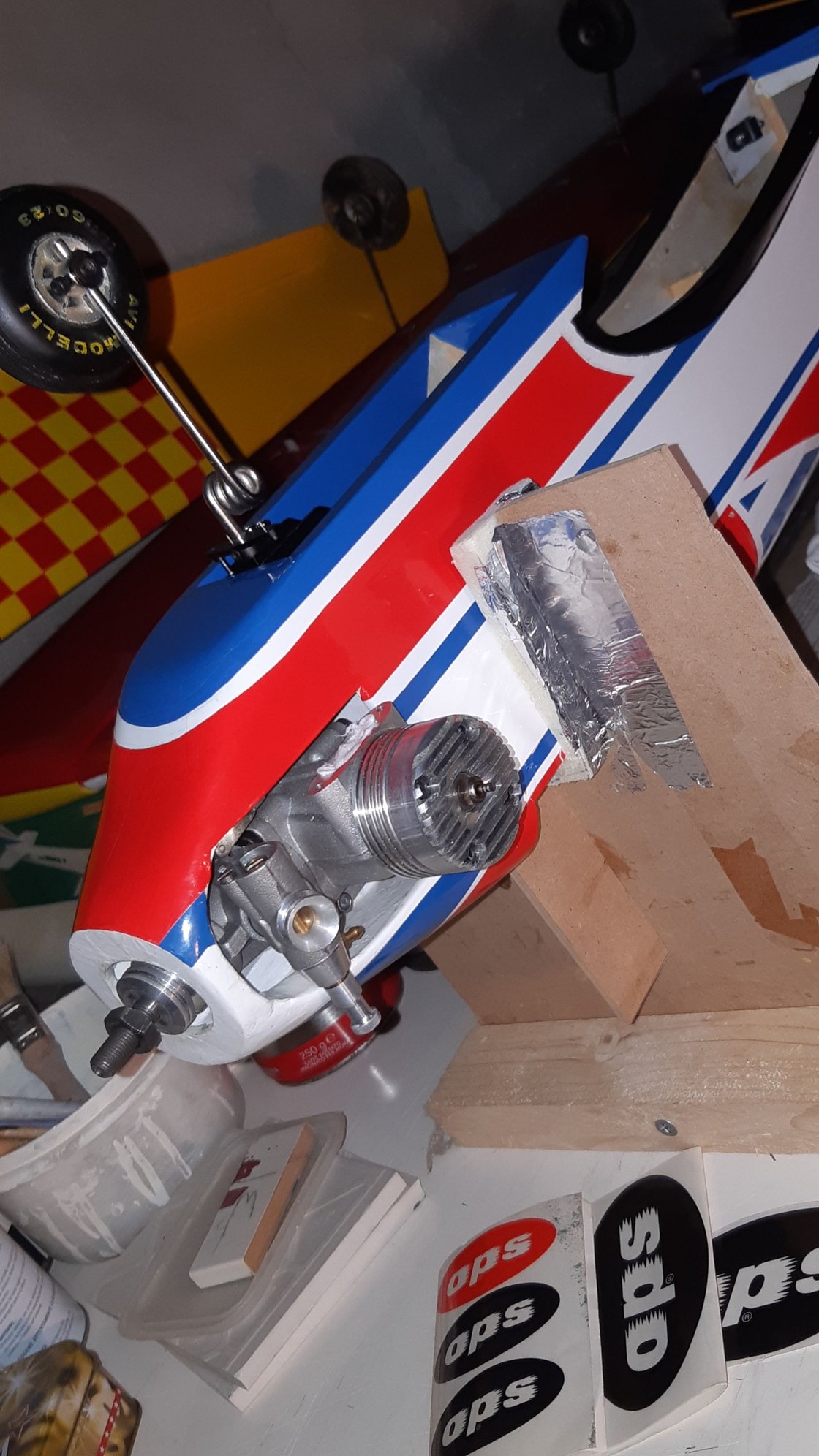

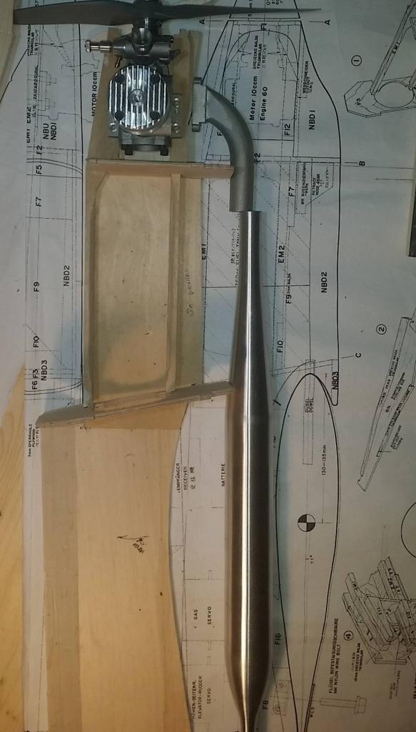

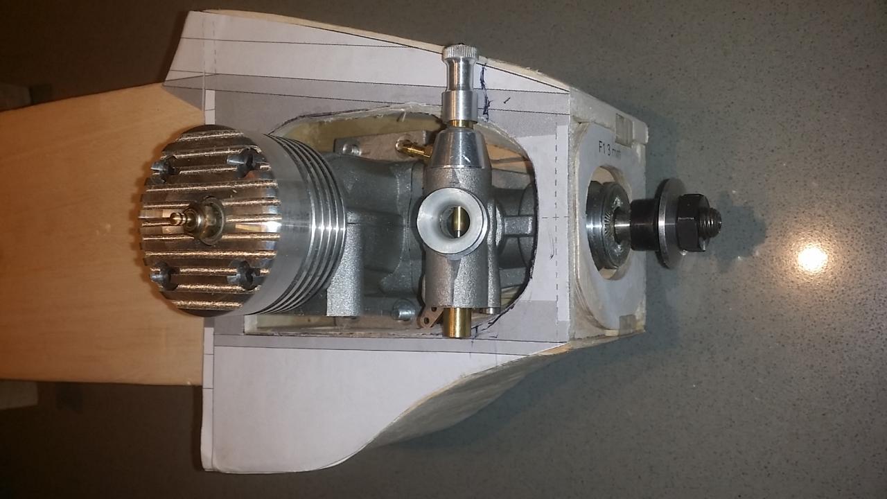

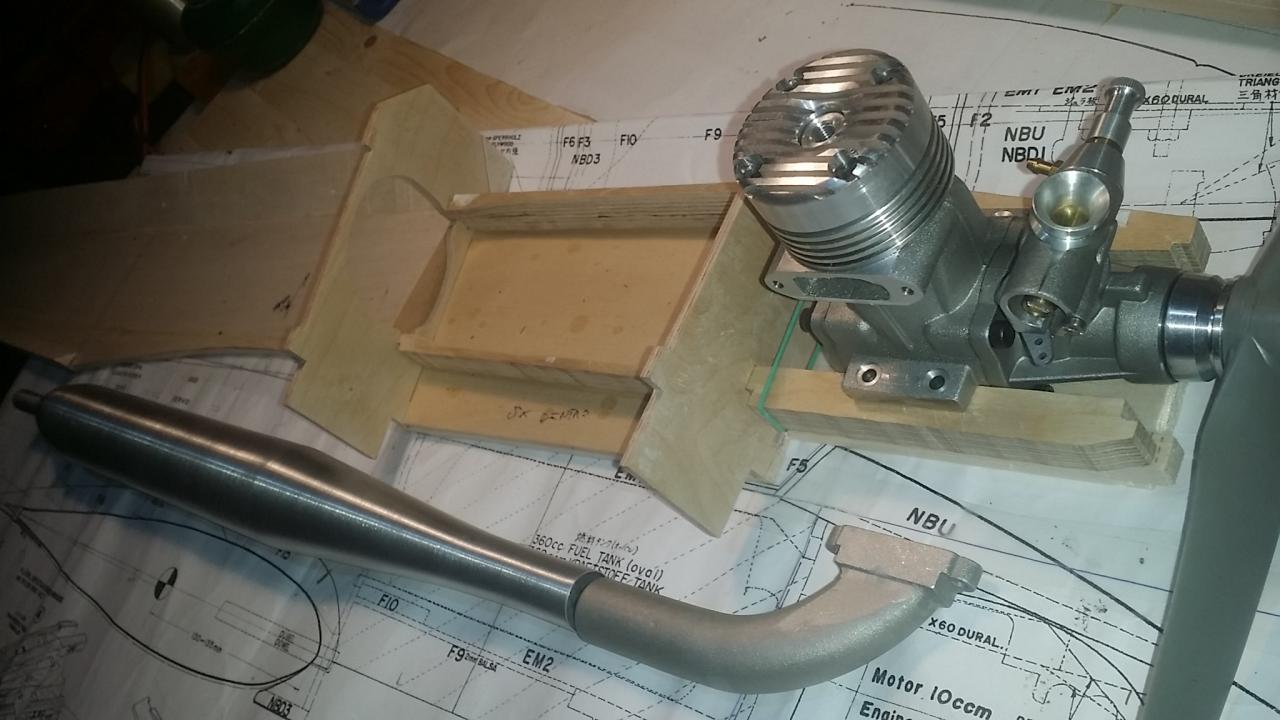

Originally Posted by MarkDaniel
I have a kit from Eureka that I would like to start soon.
Any recommendations on powerplant?
My choice is an italian OPS60 with a pipe. It will need a bit of extra exhaust to bring the pipe underneath the wing. See pics at this forum

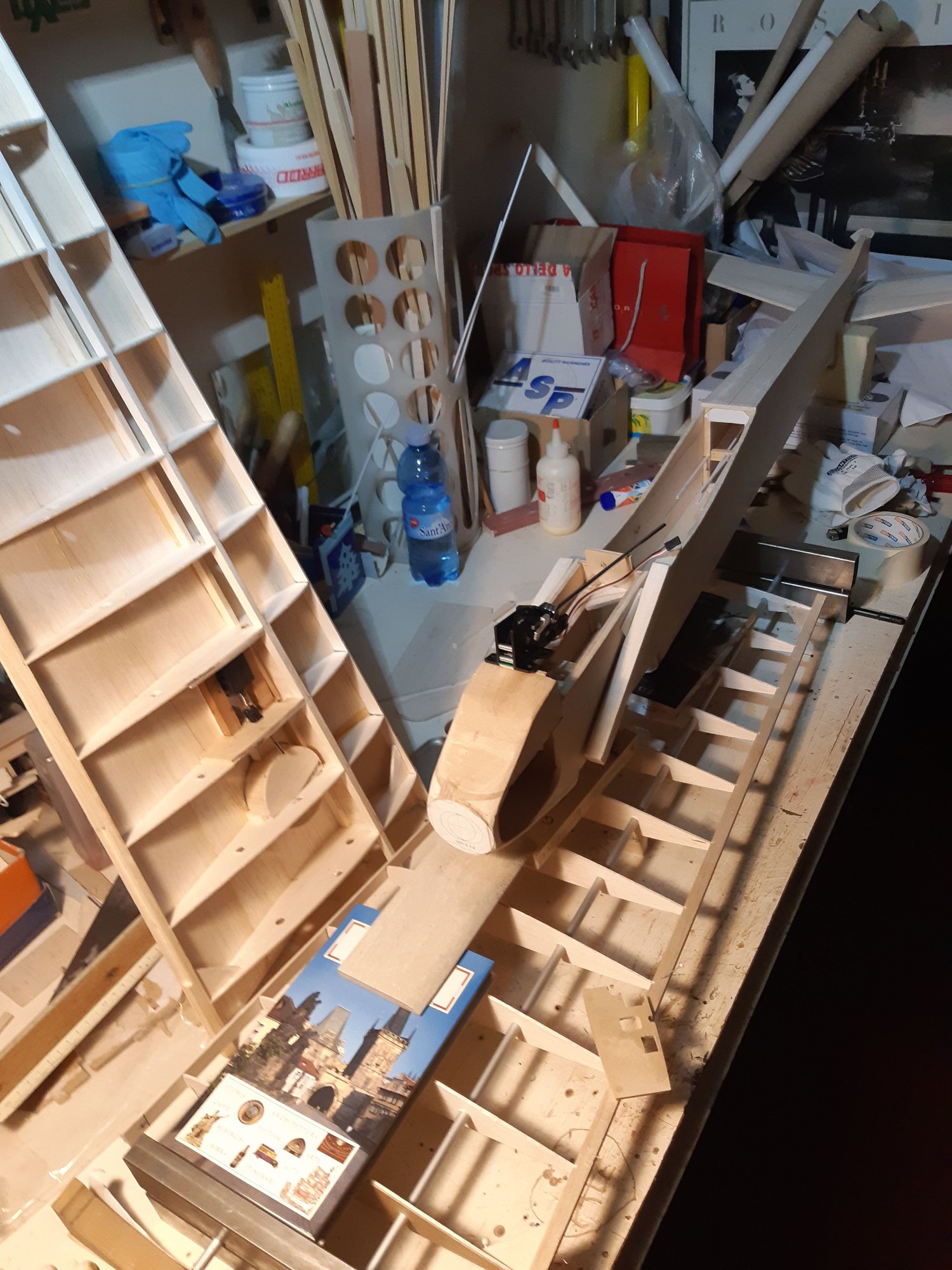

some work on my Curare. Right wing now.

Here is the final servo setup arramgement on my curare
