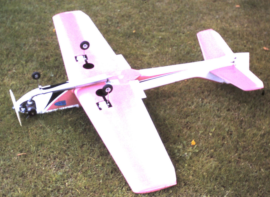

Default RE: Curare 60 - Build
Hi
Thanx for the complements guys.
Apparently Hanno prettner revised his curare by scrapping the combined flap/spoiler to the separate flap and spoiler design as per the photo of the prettners below.
When I first built it I had the combined flap/spoiler but I trashed the wing in a crash so I built a new wing with the revised design also detailed on the plan (I now had enough channels on my new radio to drive it).
The original combined flap/spoiler worked well but I find the flap alone really does help with a glide on a dead stick without too much slowing down. It also acts as a combined elevator whereas the original couldnt. I believe the original flap/spoiler arrangement was only to counter the pitching up tendancy as the flap deployed. Modern radios can get round this problem by mixing in a bit of down.
Hanno used to deploy the spoiler when the flap reached full extent. Ive found this to be a liability on landing. As soon as the spoiler came up, the model just fell from the sky. I also tried to use them only for vertical downs but couldnt see any difference with or without. I tend to now just use the flaps and ignore the spoilers (the magic only uses flaps and no spoilers!).

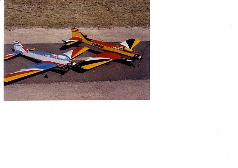

Here are two Curare 60's we used to fly circa 1986. From left to right - Curare60, Arrow40, Curare60 and 2 ships designed by Greg Casson, second from left (South African Champion 1986)

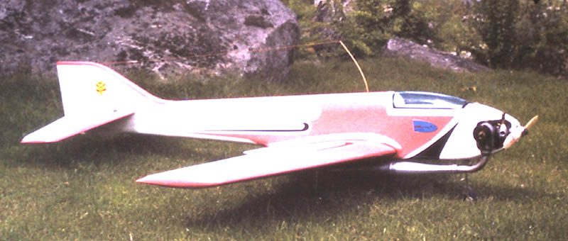

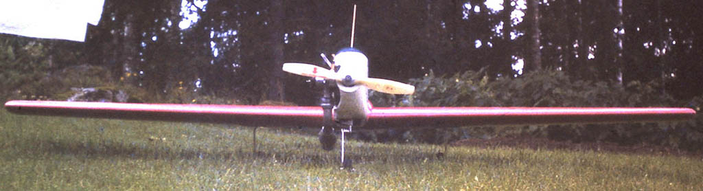

Eureka has also foam wing+stab for Curare http://www.eurekaaircraft.com/pattern.htm

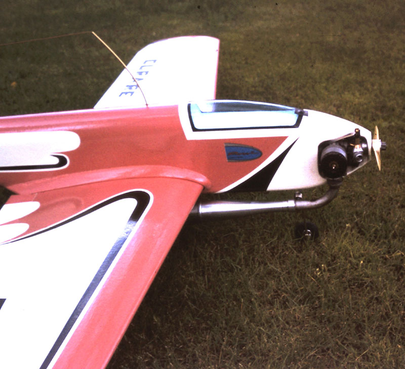

Pictures below of my Curare I had back in 1978-1981. Rossi 60 FI RC with original Rossi pipe, Carl Goldberg retracts, 7 servos, EK logictrol super pro 7 ch radio. Built from Model Airplane News plan.

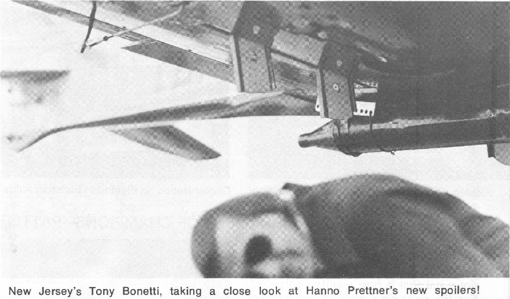

About spoiler on Curare:
I used not the spoiler itself (the part that extended upwards behind the "flaps"). I used mine as on control line plane: elevator up and flap down, elevator down and flap up.
In 1977 TOC Hanno Prettner used another type of spoiler on his Curare, see pictures below.
I remember one top flier in my country (Benny Kjellgren) back in 1978 had a short build article about his Curare (built from Model Airplane News plan) in our national model flying federation magazine (number 4 1978) and he had contacted Hanno Prettner about engine right thrust and down thrust and got answer 1.5 degree right and 1.0 degree down,because it is not samevalue on allpublished plans of Curare. In the article it was also mentioned some other valuable things like elevator throw of 5-6 millimeter up and same downis enough, rudder throw 40 mm left, same right. V-shape on wing same as on drawing, 75 mm. Weight of his plane 3475 gram with 7 servos, building time about 200 hours.
/Bo
