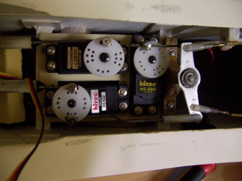

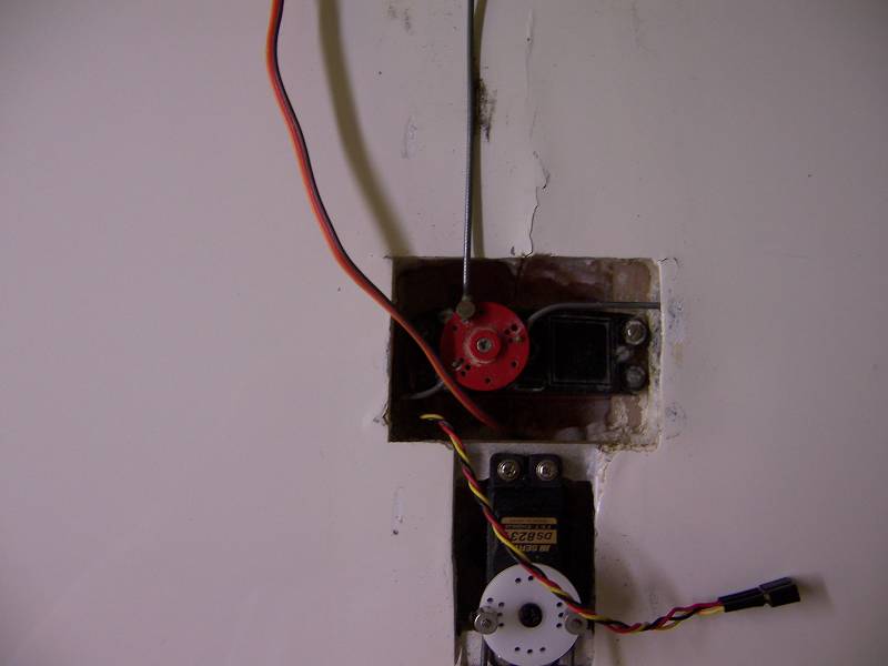

eness76-RCU, Are you running 1 or 2 servos on your Tiporares for the mechanical retracts? I will be building another one with Dave Brown retracts. I have been looking at the MK retract linkage to operate all 3 off one servo.... but it seems like this linkage favors mid-wing planes.
Can some of you guys who have all 3 retracts working off one servo post some pictures of the linkage you have?

ORIGINAL: impactiq
Ours are all one servo. I'll get some pictures this evening after work. Also for you old schoolers, you'll see something you haven't seen in quite a while....a Chevron retract servo.

yeah sorry about the delay. My wife had our first baby on the 8th so it's been hectic around here. Here's some pics of the Tipo setup. Remember this plane is 19 years old, so it's got some blemishes here and there.

This pushrod setup for the nose gear would be about exact for a Curare, as the Tipo has the same exact wing placement in the fuse.
