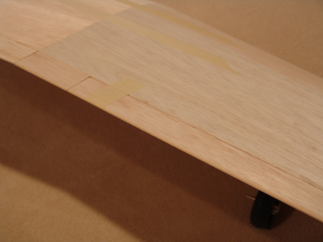

View of the right and left wing panels with the aileron stock on both wings sanded to shape. The trailing edge strip is 3/32” square bass wood. Due to the airfoil shape of the wing, the sanding of the aileron surface works the back edge of the bass wood down to less than 1/16” making a nice sharp edge. When the sanding is done the surface of the bass wood has a seamless flow into the balsa aileron.
I’m having so much fun building the Blue Angel I feel like I do not want the process to end!

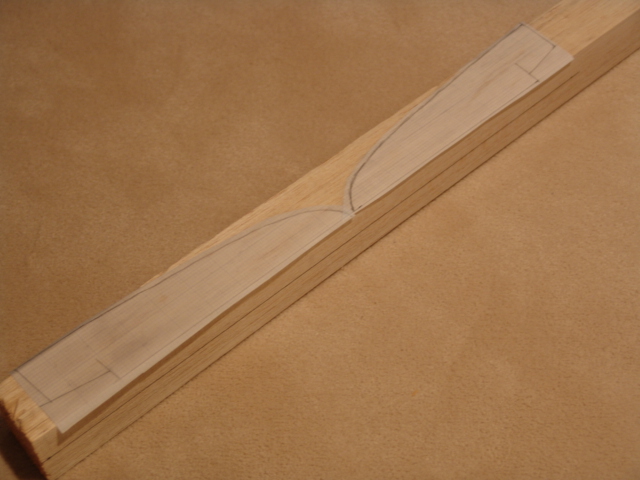

View of the wing tip block and templates ready to be cut.
To be continued…

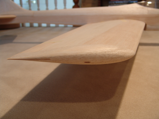

Default RE: Blue Angel - Build

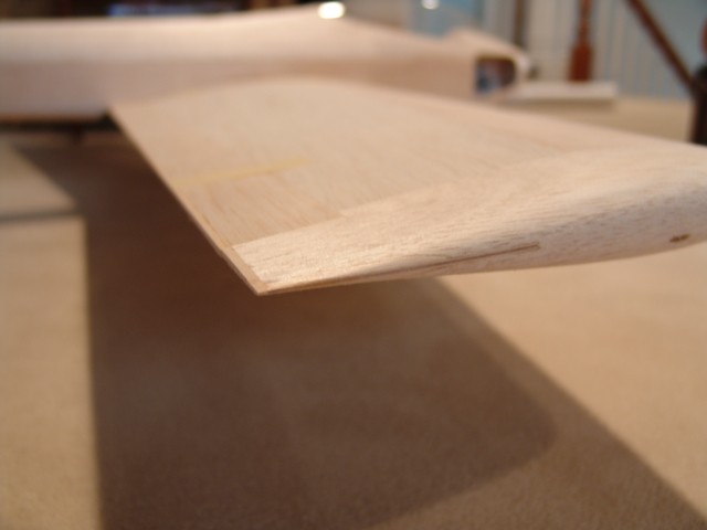

I finished the rough shaping and sanding of the leading edge and wing tips. I discovered that because of the grain direction of the angle cut in the wing tip that I had to add a small piece of balsa to the inside of the wing tip keep a straight line for the aileron cut out.
To be continued…

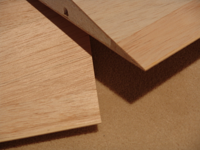

Because the aileron has a constant cord for its full length and the wing has a double taper plus sweep back there is a very slight angle change in the top and bottom of airfoil at the wing tip where the aileron connects to the tailing edge of the wing. I’ve checked and re-checked the plans and wing template and everything is the size shown on the plan and the kit wing tip tracing. The trailing edge of the wing tip template would need to be about 1/32” thicker on the top and bottom to make the airfoil not have an angle change. I can’t tell from the Blue Angel kit pictures for sure but from the change of angle of the red wing stripes it looks like it might have the angle change at the tip. It is equal on both sides of the airfoil and wings so it is not a problem.
To be continued…

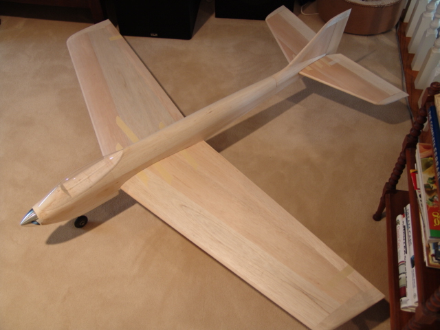

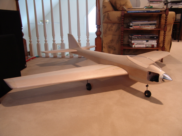

Started work on the wing fitment to the fuselage by making the angle cut opening in the fuselage for the trailing edge of the wing.
It is great to have the wing completed enough to be able to see the wing platform and fuselage together.
To be continued…

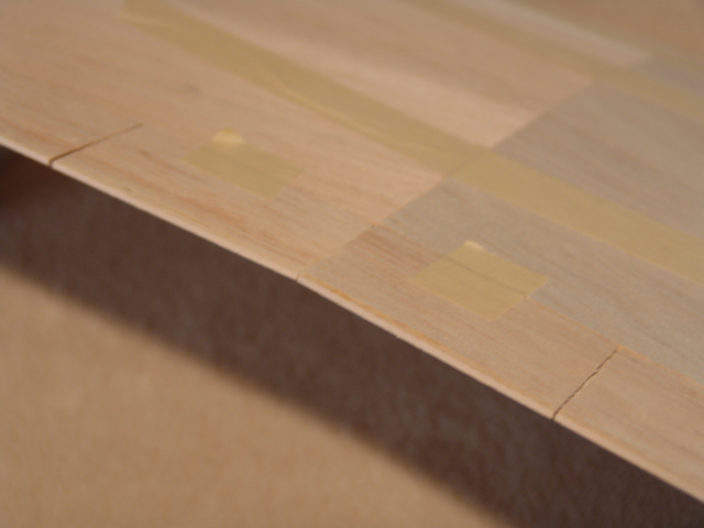

After the wing tip sanding was completed I marked the aileron cut at the wing root. The cuts run parallel with the aircraft center line. I removed the ailerons that were held with rubber glue and made the cuts. View of the root parts that will be glued to the wing trailing edge before the wing panels are joined.
To be continued…
