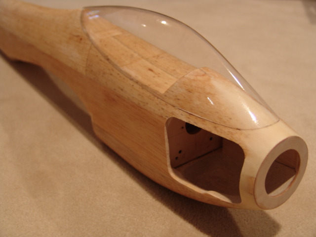

Old 09-23-2006 | 01:27 PM
  #432
8178's Avatar
My Feedback: (17)
Joined: May 2004
Posts: 4,351
Received 15 Likes on 7 Posts
From: Atlanta, GA
Default RE: Blue Angel - Build
View of the right side of the fuselage with the fiberglass cloth on and resin applied with a squeegee to minimize the resin left in the cloth.
Before glassing I went over the fuselage very carefully to make sure everything was shaped and sanded that way I wanted it. This was my last chance to make the shapes flowed correctly especially the area behind the canopy. I found a few small dents in the balsa and I popped them out with a spot of water and my MonoKote iron. A couple had to be filled with light spackle and sanded out.
I started by cutting one piece of cloth that covered the complete right side. I laid the cloth on the fuselage and mixed up a very small batch of resin (about 1/4” in the bottom of the cup) and started working the resin on the side near the wing opening and worked to the top and bottom and front and back. When that batch in the cup started to jell, I made sure that I had the current batch of resin on the fuselage worked out all directions. The resin in the cup kicks off well before what is on the fuselage because of the larger volume and the heat created. I then mixed the next batch and moved on toward the front and then the back of the fuselage. It took three very small batches to complete the fuselage.
It is easer to handle the fuselage using small hot batches of resin because the resin jells fast and the cloth says stuck down well, e.g. the front of the fuselage can be handled while you are working on the back area. How fast the batch gels and hardens is controlled by how much catalyst is used. I’m using about 10 to 15 drops per batch.
To be continued…

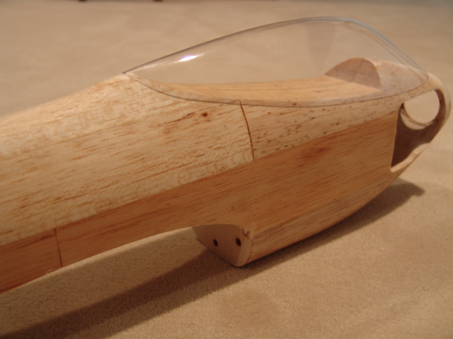

Old 09-23-2006 | 02:19 PM
  #433
8178's Avatar
My Feedback: (17)
Joined: May 2004
Posts: 4,351
From: Atlanta, GA
One of the many things I like about using polyester resin is that the fuselage can be handled so soon after the resin is applied. While the resin was still curing I took a razor and trimmed the overhang off by cutting a line from tail to nose on the center line and then trimmed the other areas.
So far the fiber glassing has added about 1 oz total to the fuselage and vertical stab assembly but no sanding has been done yet.
To be continued…

Old 09-23-2006 | 04:02 PM
  #434
8178's Avatar
My Feedback: (17)
Joined: May 2004
Posts: 4,351
From: Atlanta, GA
Now that the glass surface is on one side of the fuselage it is much easer to see how the shapes flow on the fuselage and around the canopy. It’s hard to see the flow of the shapes with the non-reflective bare balsa to see if you’ve got it right. Of course at this point it’s a little late if it isn’t! So far so good!
To be continued…
