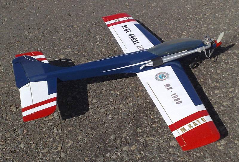

I follow with interest, as your Blue Angel build. I am impressed with how clean and exactly this model is build.
I have in 1980 even built the Blue Angel and flown over 3 years, and was on the flight characteristics enthusiastic.
I do at the time model airplanes for the AEROFLY-Professional-Deluxe, and have the Blue Angel for the simulator completed last week.
Have fun and continue with the success.
Many greetings
Karl-Heinz

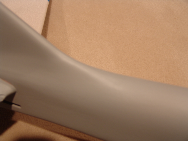

Default RE: Blue Angel - Build

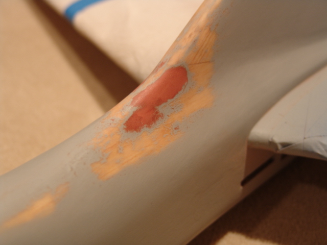

Much better!
To be continued…

ORIGINAL: HighPlains
Are you planning on shooting clear coat after all the color?
I got some clear coat but after reading on RCU about problems with it discoloring I’m not sure if I’ll use it.

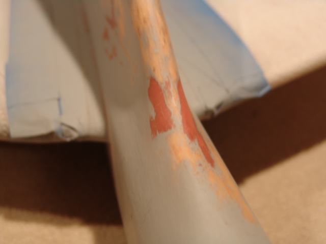

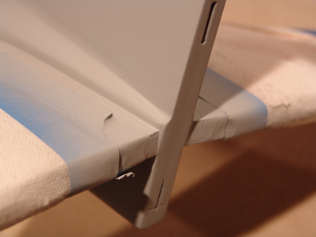

OK, screw up fixed!
To be continued…

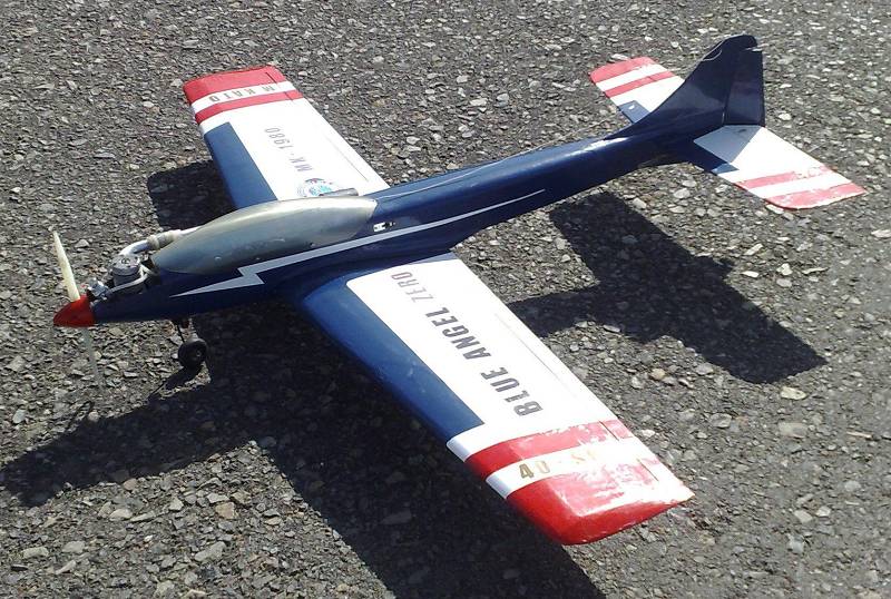

I can't wait to see this plane finished! Everything seems to be moving smoothly, but unfortunately slowly . Here is a picture of my plane I took last Frieday, just don't get confused, it's not what you think it is, and to be honest I don't know the plane's name, maybe some of you could identify it, Anyways enjoy!

mob_z, it's a Bridi Dirty Birdy with a different style canopy. It's a very nice looking plane.
8178, your fuselage looks like one of those computer generated 3D models, it's so smooth and even. Flawless.

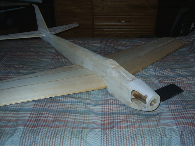

Thanks 8178, i am building this plane without a set of plans.
I picked it up from another modeler.The fuse was 80% built,the canopy is missing(one on order from Carolina Aircraft,thanks Dan)and i have to cut a new set of wings.The one that came with the plane were bowed.
Anyone would have a tip and root rib tracing for the BA.
Thanks.Phil

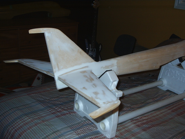

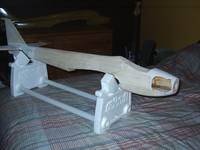

A few pics.

ORIGINAL: rabbid fly
A few pics.
Thanks very much for posting the images of your Blue Angel. It’s really interesting for me to see a real kit built Blue Angel and see how the kit parts look when they are assembled. I’ve had to study the plans and pictures a lot and hope I got it right! I mostly tried to think how a meticulous builder like Yoshioka would have done it.
From your pictures it looks like I’m pretty close. Your vertical stab front edge intersects the fuselage differently and someone has added a lot of fillet work around the tail that I did not see on the plans. The area around the front lower part of the stab where it intersects with the fuselage shows a very complex shape that is not reflected on your build. Yours is built more like the first kit in the series but with the full rudder like the second series.
Just a thought, you might be able to straighten the wing using heat. Moving the wing slowly over a hot electric stove burner (up from the burner about 12”) sometimes lets you bend the wing back in shape. You will be surprised how much flex the wing has.
