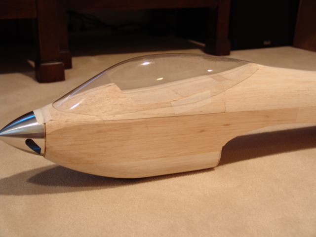

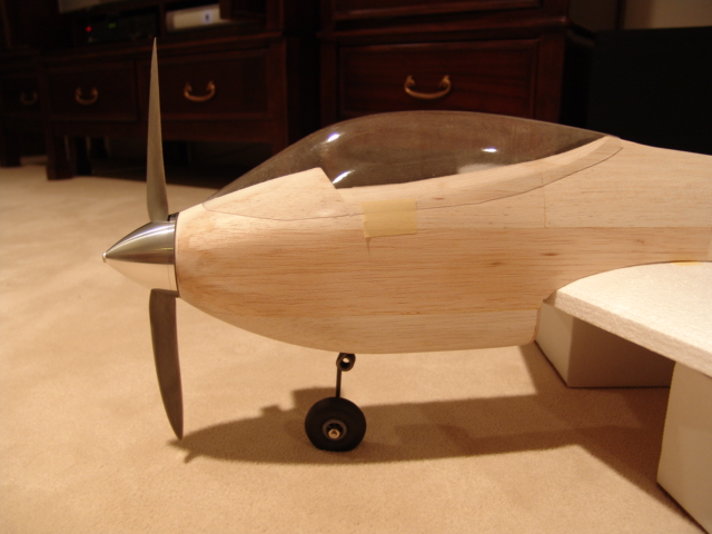

I could hardly wait to do some rough cutting of the canopy and trial fitting. I somehow avoided cutting my fingers in my excitement! It is really looking like a Blue Angel now!
The canopy started out as a flat .030 sheet of special high impact strength PET-G made by Vivak. It is tough as nails! I put some 15% nitro fuel in the cupped area of a scrap piece and it has absolutely no affect on the plastic.
To be continued…

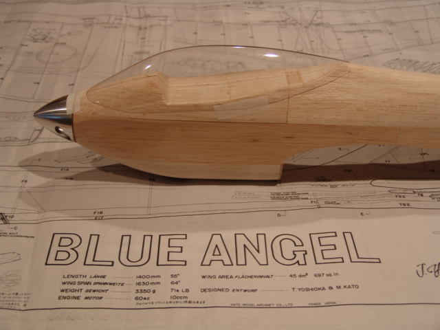

More checking the shape of the nose pieces under the canopy before gluing.
To be continued…

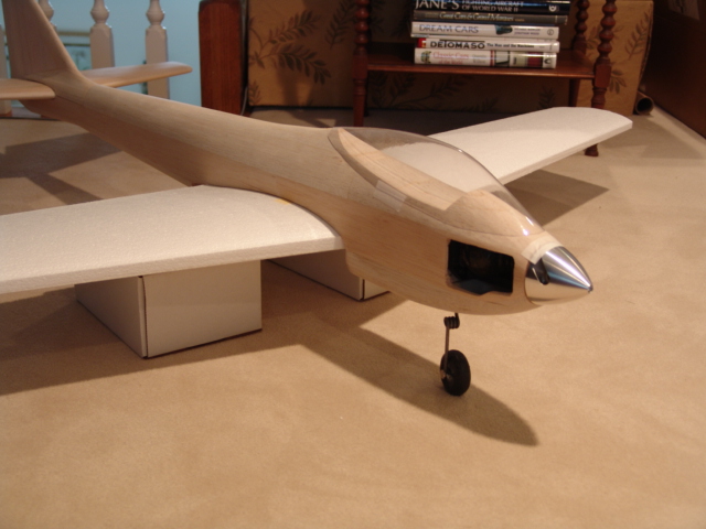

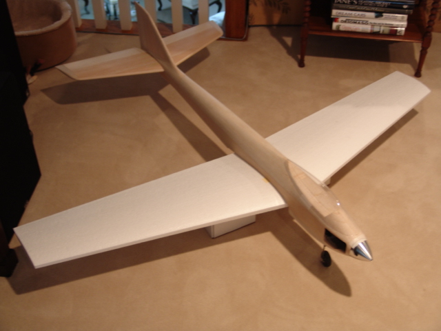

Old 05-06-2006 | 04:56 PM
  #211
8178's Avatar
My Feedback: (17)
Joined: May 2004
Posts: 4,351
Received 15 Likes on 7 Posts
From: Atlanta, GA

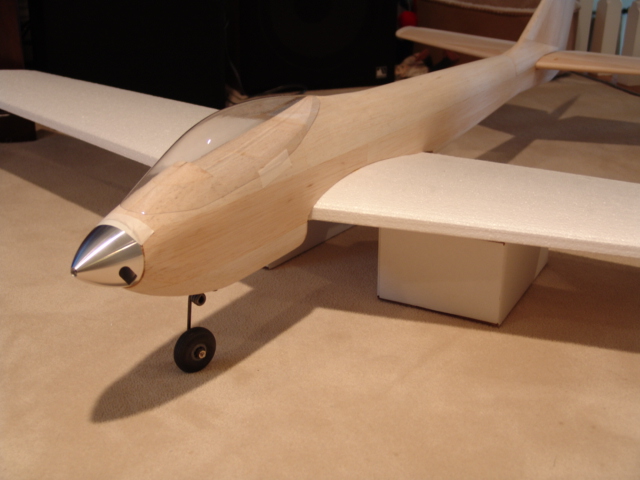

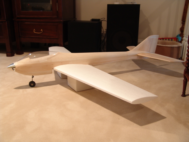

Default RE: Blue Angel - Build

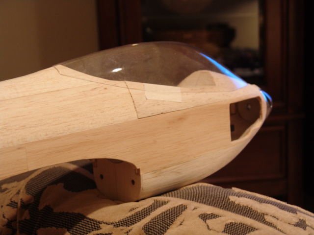

After the glue was set I did a lot of sanding to shape the nose and the area under the canopy. I need to do more trimming on the canopy now that the wood is taking shape.
In these views the fuselage is just sitting on the uncovered wing cores and they are missing 1 ¾” on the trailing edge, ¼” on the leading edge, and of course the wing tips.
To be continued…

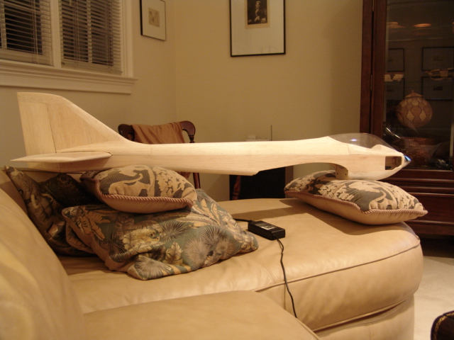

Old 05-06-2006 | 04:59 PM
  #212
8178's Avatar
My Feedback: (17)
Joined: May 2004
Posts: 4,351
From: Atlanta, GA

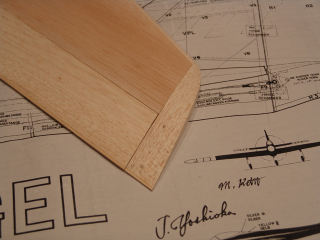

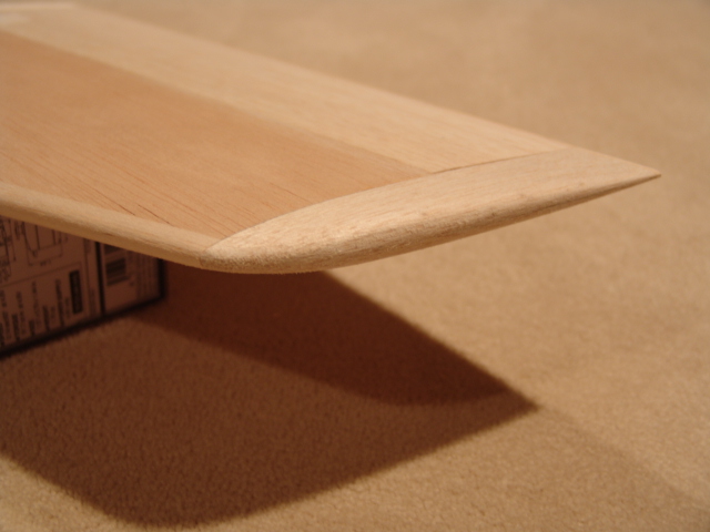

The horizontal stab tips were glued on, planed and sanded to shape.
To be continued…

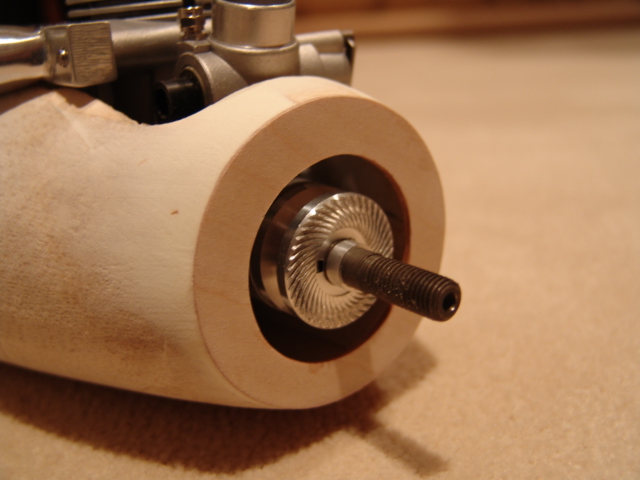

Old 05-07-2006 | 07:46 PM
  #218
8178's Avatar
My Feedback: (17)
Joined: May 2004
Posts: 4,351
From: Atlanta, GA

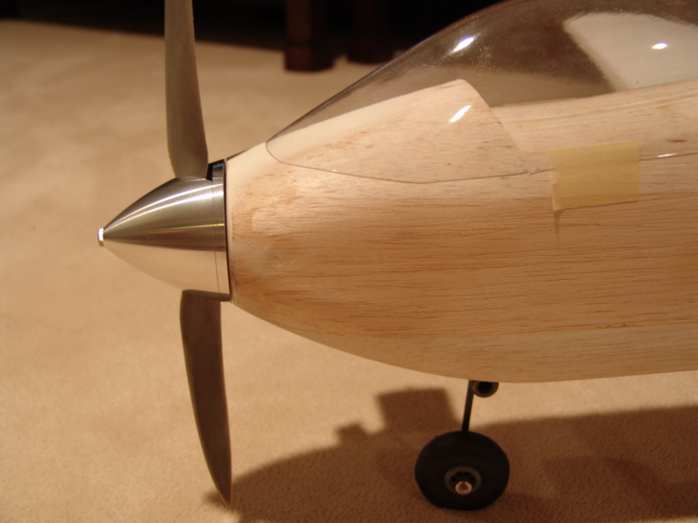

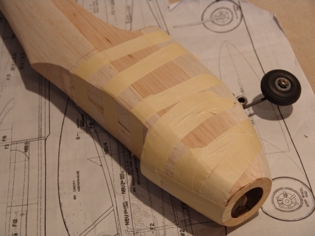

The original Blue Angel did not use a completely round plywood nose ring because it had to be thick to support the front of the original wood beams for the engine mount. The thickness of a round nose ring would have made it difficult to shape the fuselage to the ring and keep it round to match up with the spinner.
I elected to use a thinner round nose ring to pull and glue the front of the fuselage together and to give a rough guide the build up of the front of the fuselage. But because of the sharp angle of the fuselage line as it curves to the nose I added a second 1/32” thick nose ring that was slightly larger than the spinner back plate. I cutout the fuselage so I could install the engine on the mount and put the 1/32” nose ring on behind the spinner. I then moved the 1/32 nose ring around behind the spinner until it was exactly centered, and then spot glued it from behind to the thicker nose ring. I then removed the engine and glued the ring all the way around on the outside and on the inside of the ring. This process left a small gap between the balsa and the nose ring that needed a little filler. I’m going to be glassing the fuselage with fiberglass cloth and polyester resin so I mixed up a small amount of resin with micro-balloons and filled in the gap. After it setup I sanded it smooth.
There is not much prop clearance with the 12 -10 prop but I only fly off tarmac.
To be continued…

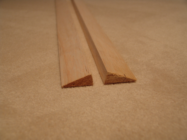

My aileron stock arrived from Dynamic Balsa today and it looks good!
After giving more thought to the single aileron servo used in the original Blue Angel, I decided to add a second servo and move them out in the wing to reduce aileron flexing. I’m using Futaba digital S9252 servos so the second servo added $75.00 to the project. I really didn’t want to spend more money on the project but with the piped OS 61 SF ABC-P engine this Blue Angel will be flying much faster than the original and I don’t want to take a chance on aileron flutter.
To be continued…

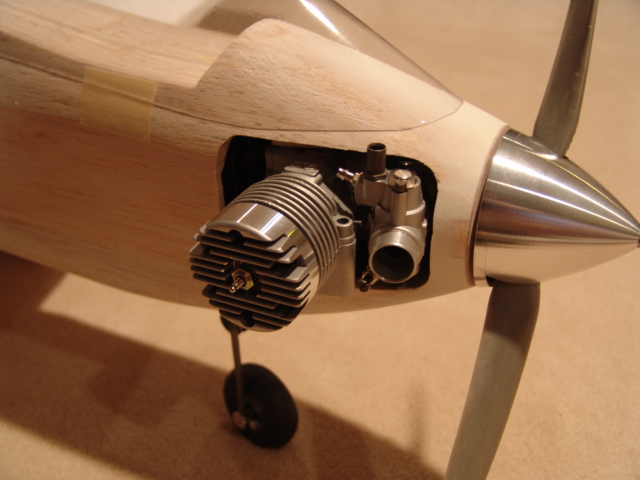

Old 05-10-2006 | 07:08 PM
  #225
8178's Avatar
My Feedback: (17)
Joined: May 2004
Posts: 4,351
From: Atlanta, GA
The engine was positioned on the mount with the required spinner back plate clearance and the mount scribed for the engine mounting holes. The engine mount was drilled and taped with a 6 - 32 tap.
The clearance for the pump lines on the back of the engine are pretty close so I added a little more gap between the front of the nose and the spinner back plate. The clearance is a little over 1/16” and I usually like to have it less than 1/16”.
I laid the fuselage over the plans to check the header and tuned pipe fit and it looks great. Macs must have made this pipe header for the Blue Angel. The pipe will fit neatly and tightly up under the wing and fuselage perfectly.
View of the engine bolted to the mount, the pipe header and the view of the nose without the spinner.
To be continued…
