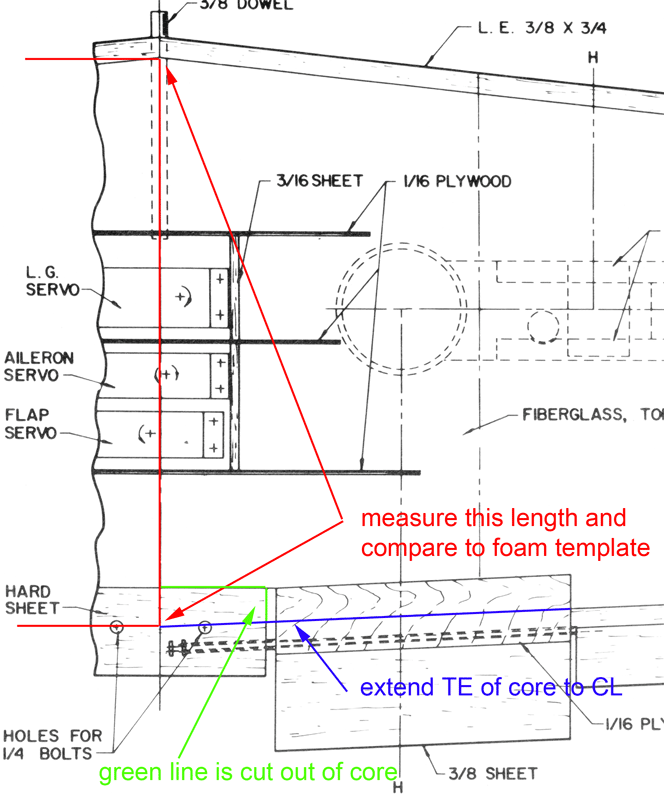

did you hold in mind that you cut the cord about an 1/2 inch shorter when u put the hardwood wing mount in?Red line is the foam wing cord green line is the wing cord when the wing is finished. The cord off the wing gets shorter so it fits in the fuse.
I`m building a curare from MAN plans and so far everything looks good.
Erik
Erik
I had to cut the cores as you suggested, so it's going to work out. Good thing I measured everything before finishing the wings up! Somehow my built-up wing ended up w/ 2 degrees of washin (not good) at each tip so I had to get a foam replacement. I still don't know how I got the twist, as everything measured out great before applying the sheeting. The wing was built on a jig, so I'm still scratching my head...
Tim

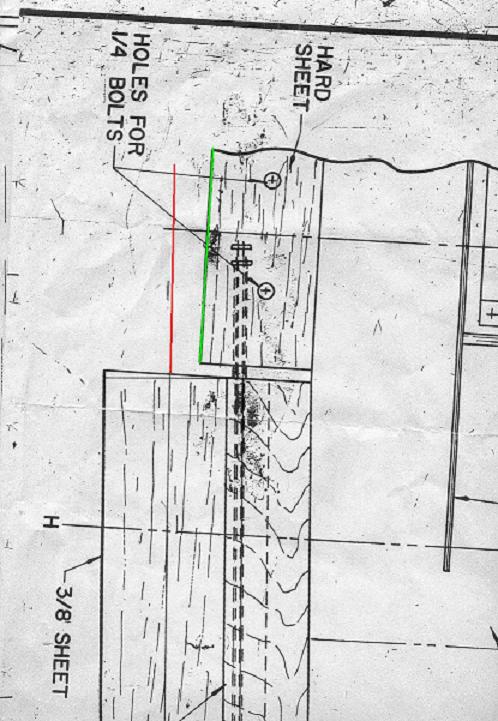

See the attached jpeg.
I'm not sure of the 11-12 mm difference which the note referes to, I measured the two sets of airfoils on the German plans. The German plans show a foam root and tip airfoil sketch and a built up sketch. Both roots measure approximately 315mm, and the tips 217 mm. The wing planform in which the note refers to measures 324 mm at the root, and 217 at the tip. Canada went metric over twenty years ago. It makes for more precise measurements.
I don't measure a 12 mm difference, but only 9 mm.
So do you split the difference between the root and tip widths for the plan layout or do you take the angle at the trailing edege on the planform. Which in this case is 2 degrees taper on this set of plans.
Does make things any clearer?
