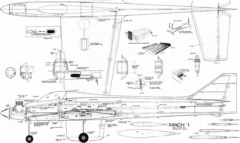

I have decided to design my own pattern ship. I am a big fan of the classic 60 size birds, so I have decided to follow the retro route.
I have decided to use features from a lot of my all time favorites and incorporate them into one design.
Can anyone name the plane I started with. I will let you guess for a while before I lay out where the ideas came from and what my intent is.

a Patriot?
Old 08-29-2006 | 09:26 PM
rainedave's Avatar
Joined: Jul 2005
Posts: 6,346
From: Richmond, VA
Default RE: Name that plane LOL
If you leave off the additional belly section it reminds me of a Mach 1.
Posts: 746
From: Fort Mitchell, AL
No think 70's desings. It was one of the big names.

Yes I started with the Mach 1. I always loved the way it flew.
1. I gave it more side area because I wanted better knife edge flight. That's also why I enlarged the rudder.
2. The Mach 1 always seemed to have some roll coupling. So I moved the rudder hinge line to a true vertical position.
3. I have had 2 Mach 1's over the years. One I built and one I bought already built. The one I built always seemed to run out of elevator at low speeds. So I have decided to give it an anhedral stab. Well I also think an anhedral stab will look cool too. LOL. Think Curare and UFO.
4. I also always liked that clean look of a pipe hidden in a belly pan. Like the old illusion.
5. I am planning on using one of my super tiger 90 engines and was concerned about the fuel tank area, so I elected to convert it to a tail draggers for simplicity and extra room in the nose. I also wanted to get 8178 fired up. LOL
6. I also wanted something quicker to build than the Mach 1 fuse. So I changed the way the fuse is built. I just don't feel like all of that carving of the top blocks. I built a Bridi Killer Chaos over the winter and loved the use of Triangular stock in the fuse top, I certainly made it easier to round off the corners. LOL.
Overall it should be a great flying bird. I haven't changed the wing and stab, or there locations.
And I think it will look pretty cool, when its done.
I hope you guy will agree.

Paternguy,
Looks to me like you have an EU1 A with Mach One wings !!!! Doesn't really matter as I think you have captured the "spirit" of the designs of that era where they need to fly ballistically and look great while doing it !!! Good luck w/your project...
Dan

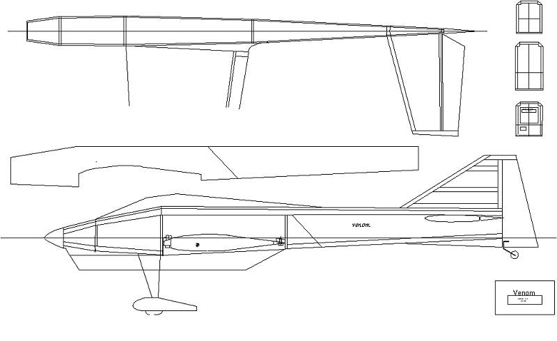

I have a little more work done on my new bird and I picked out a good name ( I think LOL).
I need to make notations on the plans and I will be done.

I actually think it ended up looking more like the LA 1 than the Eu-1.
Either way I think it looks cool and should fly great. Its not the picture I had in my head when I started, but I really like where my imagination took me.
With the Mach 1 dimensions and the wing and stab it should be fast but yet very stable.
I will post a build thread when I get started on it.

ORIGINAL: Paternguy
It is beautiful and it does capture the essence of the Seventies. The Mach 1 was my guess too.

These are the finalized version of the plans. Let me know if you see anything that I might have overlooked.
Old 08-31-2006 | 11:20 PM
rainedave's Avatar
Joined: Jul 2005
Posts: 6,346
From: Richmond, VA
Yes, I got the plans, they are excellent.

You could call this one the "Machorare". Nice looking plans!
