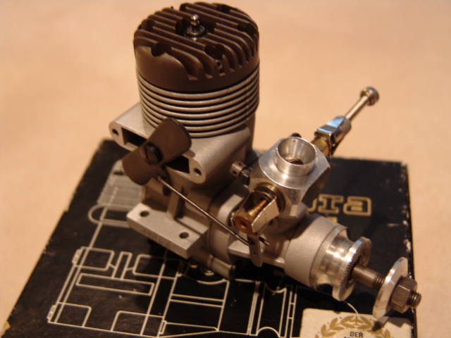

I'm looking at a couple of Webra 61 side exhaust engines but none have a muffler. Is ther a source for the muffler for these engines?

If it is this Webra the K&B 61 muffler fits. http://www.mecoa.com/kb/61/61-parts.htm part number 30-6102.

If it is the Speed #1024, some were drilled and tapped. They utilized the same hole spacing as the OS #744, Rossi 60, and Fox Eagle 3. I believe there is an Enya that shares that hole spacing as well. Others needed a Strap- on like the BCM Lou mentioned-- that one works fantastic. I have some of each version of the Speed .61
8178 is correct about the K&B muffler working on the Blackhead / Silverline .61's( 10cc). They also share common spacing with the HB 40-.61, ST 45-60BB, as well as the K&B .61 and .65 Sportster.

The K&B .61 muffler is also identical to the muffler used on the HB .40 thru .61 line of engines and bolts right up perfectly.
