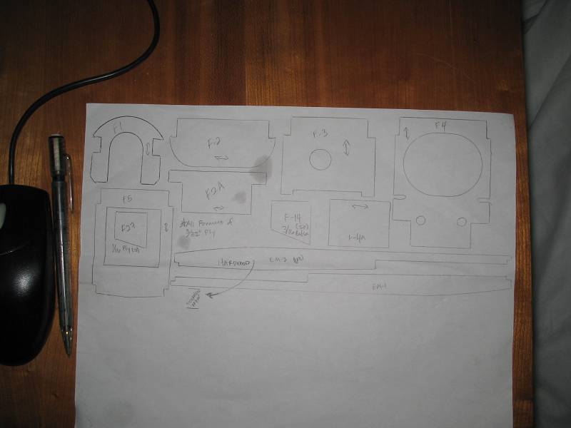

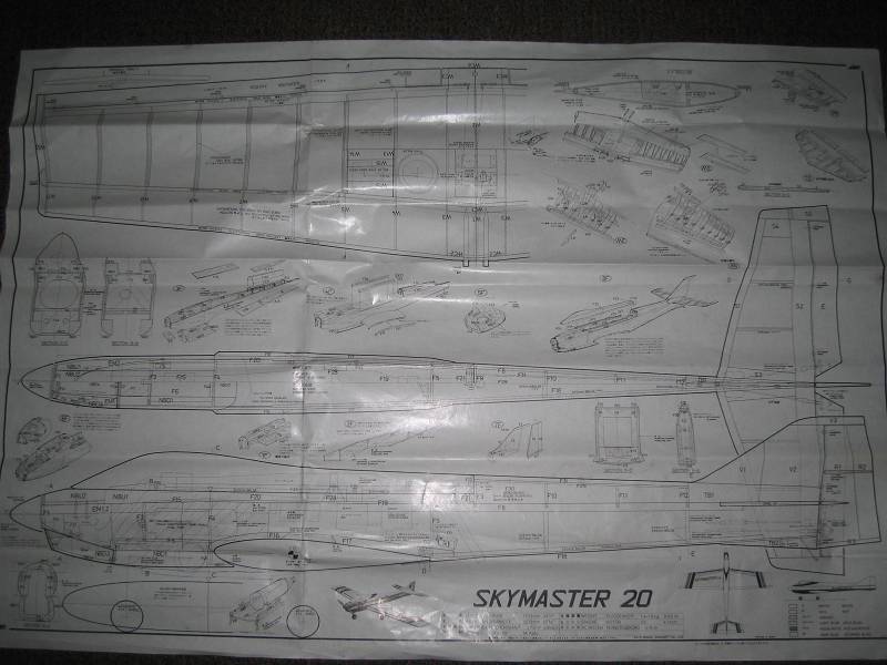

I'm starting a build thread for the 20 size MK Skymaster.
I tried this a couple months ago, but I was using a dail up ISP. Trying to upload pics just took too much time. Now I think I'm ready...
The plane is unbelievable. The build follows the same "Katoish" techniques as the larger kits, just a whole lot smaller.
I plan to use a OS 25 VF and 20 size MK retracts for the plane.
Here's the plans

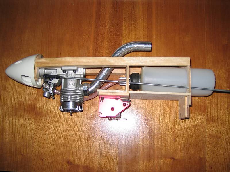

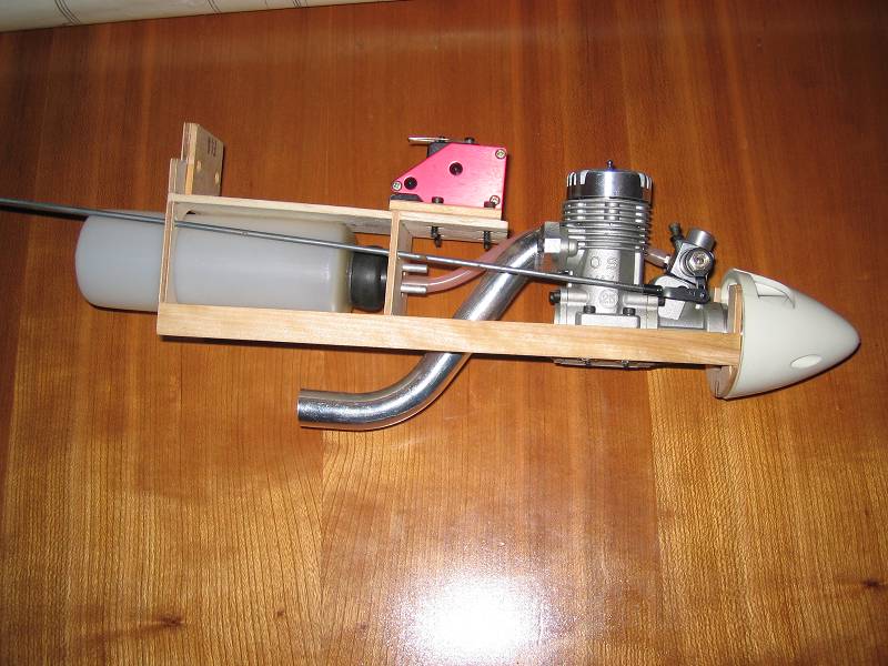

The engine craddle...
The first pic is just a dryfit. Then I glued everything with slow epoxy, drilled the rails for the engine, fit the tank, and mounted the nose gear. The header is a hatori.

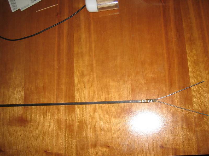

I ran down to our only hobby shop on the island for a C/F pushrod. wouldn't you know, they were all out.
I put one together using graphite and 1/16 balsa, 1/4" wide.
I laminated the balsa together with the graphite sandwiched between each peice. Then I wraped all 4 sides of the "stick" with more graphite.
Turned out nice and stiff, and quite light too. Just square and not round.
I staggered the points where the threaded rod join the square rod so I don't lose too much strength, and wrapped it with kevlar wicked with epoxy... Just as they did it back in the 80's. [8D]

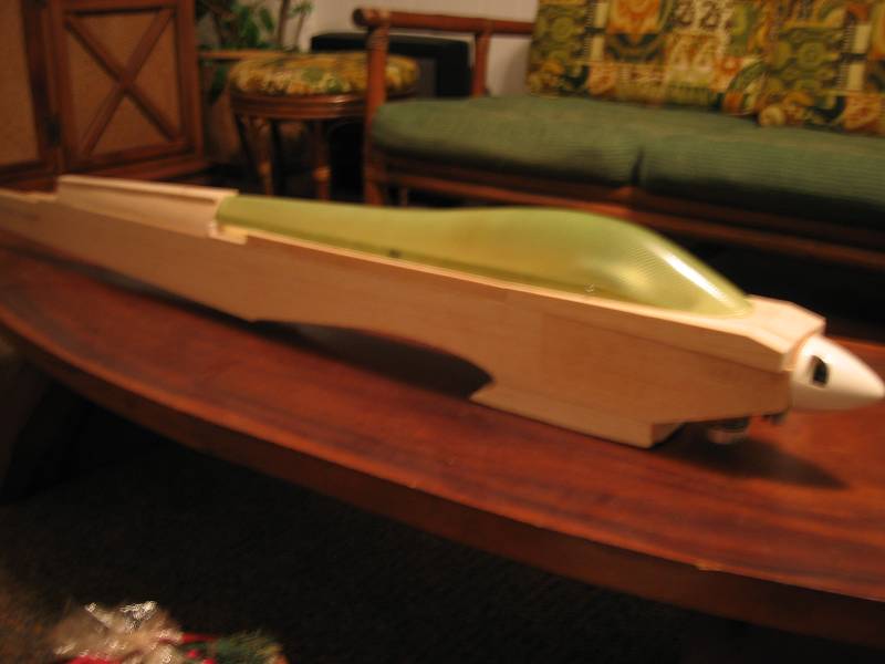

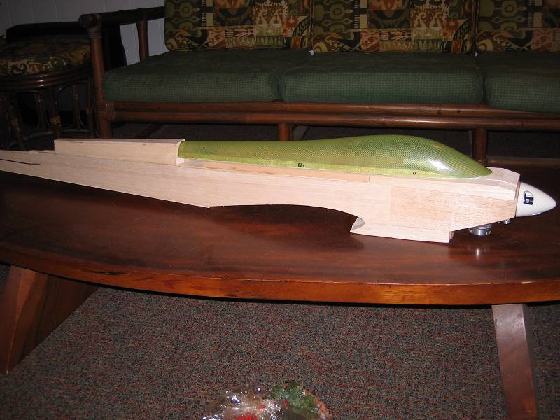

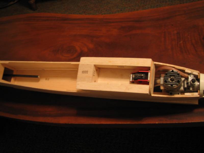

When I built the fuse. Everything just fell right into place. I was having so much fun that I didn't take too many pics. It took just over an hour and I built it on my computer desk in my bedroom. I love these little airplanes!
I used Med Zap on everything, then I glued in the front craddle with slow epoxy. After that, the bocks get tacked on. The top turttle deck needs to set into place and I need to get a correct sized spinner ( the one on is just a little too big). Lookin like a plane!!
I'm going to start on the tail next so I can mount it up and start sanding!

Roguedog
Thanks for the praises.
your copy for the plans sould be pretty reasonable. Theres only the one sheet, and the sheet is only one sided! I also have been copying the parts as I've been going along, so reproducing the parts would be as easy as possible. Here's a pic of the fuse parts.
The graphite I used came in 1/2" wide strips and I cut them as needed. I don't remember the thickness or gauge it is. It was the thinnest my LHS had, and it's supplied by Aerospace Composites. Mind you, I only did this because I didn't have a regular carbon fiber pushrod around. If I did, or if I could buy one, I surely would have gone in that direction.

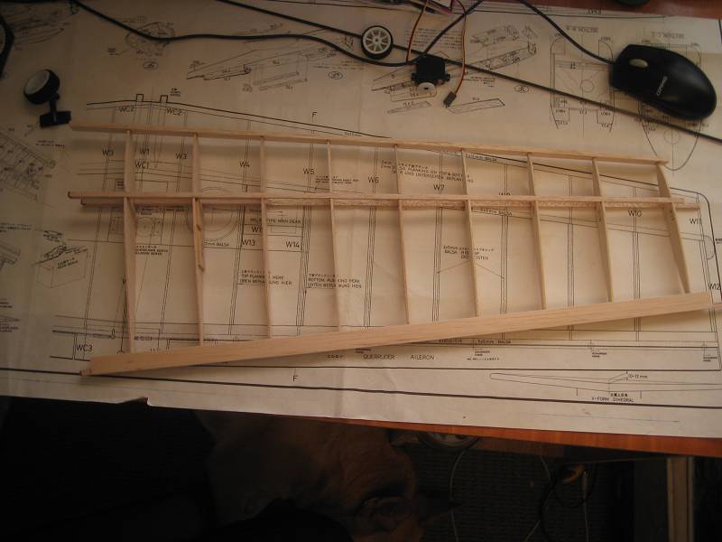

OK After a long time away from building, I have got to get on with kit, so I have started a wing half today. Here it is framed up. I plan to add the retracts and servo(s) later today. I'll post more pics tonight.
I've also been thinking maybe a fixed gear taildragger version w/ a 30 4stroke and enlarged surfaces to do 3D???[X(] I can't even believe I made a joke like that
