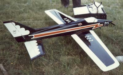

Hi All!
Just spent about an hour on the phone with Don Turnock of Eureka Aircraft discussing the short kits he sells. I told him my goals for a vintage pattern ship and he told me the Troublemaker EXT (extended version) would be the ticket. I have some experience with foam wings so I opted for the taildragger/foam wing/foam stab kit. My intention is to put retracts and a piped .61 on it, but haven't ruled out SPA since I'm moving to Florida next year... so the retracts and pipes may get nixed. Or I could hook up with the BPA guys and....GAME ON!
I should have the kit in about a week, and progress won't begin right away, but I wanted to start the thread so anyone with Troublemaker pictures or experience could chime in while we wait for me to get started.
Should be a fun build by the sounds of it. I've got quite a lot of IMAC kit building experience, but this will be my first small pattern ship and I'm really looking forward to a fun build.
Please post any pictures you may have of the Troublemaker or bestow your knowledge!

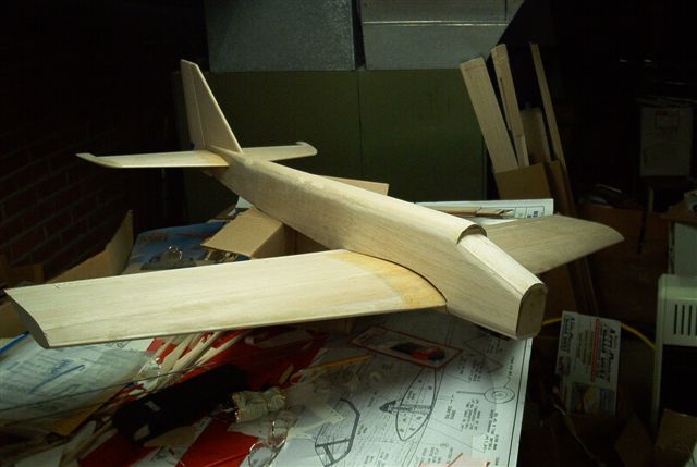

OK, if we are posting our partially completed Eureka Troublemakers, here's mine:

Awesome! How are you doing your canopy?

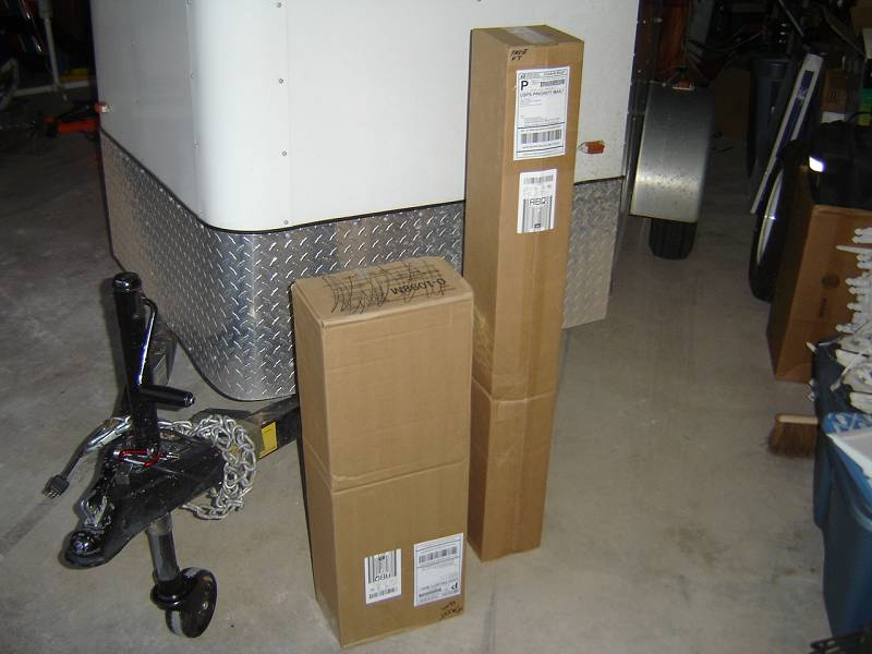

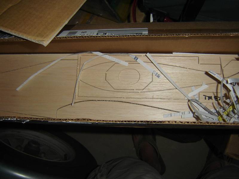

Got the kit today. Here's a few pictures. Had to hurry.
First the boxes, next the small parts bag, then the kit showing fuse sides, then stab foam cores. Real blueprints with this one! Can't wait to start!
Dave

I notice that the tail section of your plane is mounted high. The Troublemaker kit I purchased from Eureka has the horizontal stablizer mounted low in relation to the Vertical stablizer. Is your kit a newer version of the plane? If so they have not changed the picture on the website where they are selling the kits.

I noticed that about "stripes" plane as well.
As for mine. It looks like a box. The un-glamorous beginnings of a classic pattern fuselage. When I can get a good pic I'll post it.
You guys have very sharp eyes. I would hate to be playing three card monte with you. Yes, I confess, the stab is mounted higher than stock. As long as I am at it I confess the fuse is stretched just like the "extended"version Eureka sells. I bought the original length but wanted some changes so I did it. I hope Ed Moorman doesn't see this post. (He is against modifying classic designs and I would hate to offend him.)
