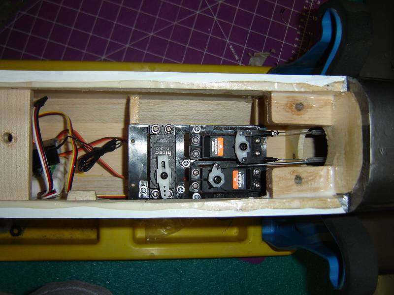

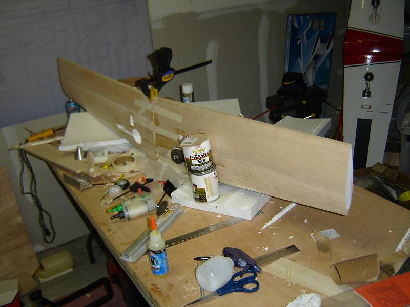

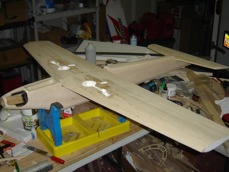

Got both gear wells done and joined the wing halves. Now I have to wait for the glue to set. I chose to use Gorilla Glue (Elmer's Ultimate Glue, same stuff) to join the wing halves. This may not be that standard, but I've had excellent luck with this stuff. As it dries, it expands into every gap and crevice. It's totally sandable and I have used it extensively on 40% airplanes. I will however, use epoxy to glass the center wing.
Going to go back to working on the fuselage. Going to work on the tank mount and servo tray mount. Maybe make a push rod for the elevators.

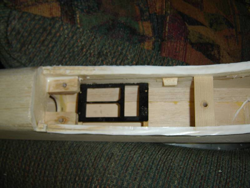

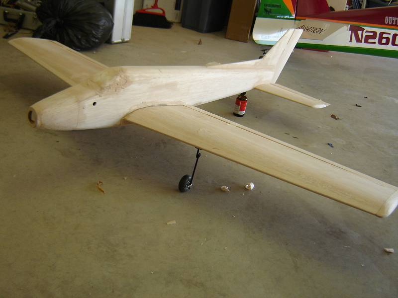

Here's where I ended up today.
Most of the wing work is completed. The retracts are straight (I was worried I'd get them crooked). Next I will sand the center wing, cut out an opening for the retract servo, install training edge, install front dowels and glass it.

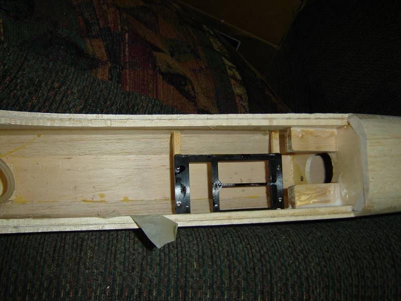

Did some work on the interior. Installed at pre-fab servo tray. I offset it so I can install a pull=pull rudder setup. Throttle cable sheath is installer.
This thing seems heavy, but I could just be worrying.
I have a lot of final sanding in my future.

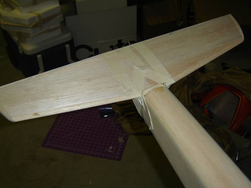

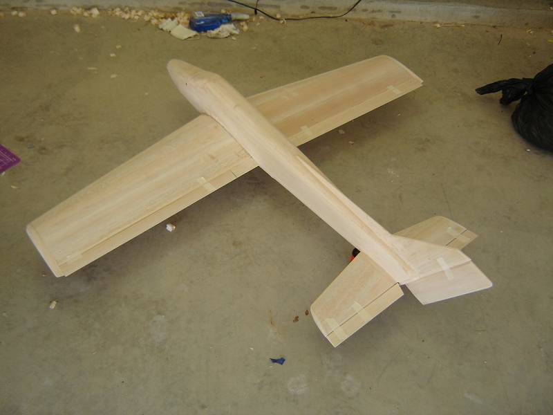

Just spent some time doing some wing sanding and checking the alignment of the wing to the fuse. I don't know how I did it, but it's right on.
I'll tell you. I have a new found respect for you guys who built these planes back in the 80's. This is a lot of work... and a lot of feel it out as you go. I'm sure this is making me a better builder.
Anyway. The next few sessions are going to be fitting the wing and building a belley pan.
SAND SAND AND MORE SAND....YIKES!!!

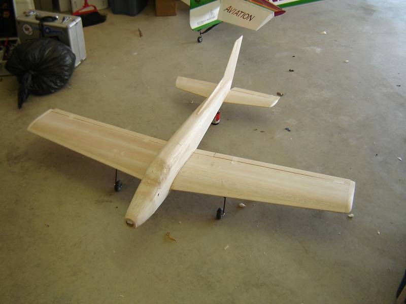

Big progress today. Got the entire retract system working, monted the wings and stabs. Last thing I was doing before I tired out was building up the belly pan. The incedence came out less that 1/4 degree different, wing to stab.
WILL SOMEONE REASSURE ME THESE PLANES ARE HEAVY? I'M WORRIED i'M BUILDING A BRICK!!! FEELS LIKE THE PLANE AS IT SITS NOW IS 3-4 POUNDS.

Ready to fly weight should be 6~7 lb, so you are only half way there...no need to worry, couple of lb of engine and radio still leaves a lb for tank and covering, easy.
Evan, WB#12.

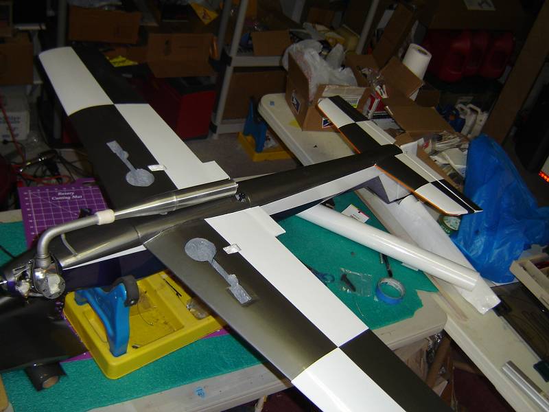

Well alright... here's where the project sits. I only have a little work to do on the ailerons, then a final sanding (hence the filler). Tomorrow I will clean up the garage from all the woodworking (messy) and get ready to cover this bad boy. I'm pretty happy with the way she turned out.
Dave

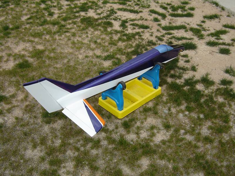

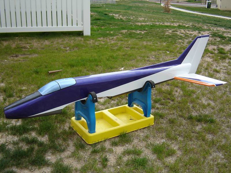

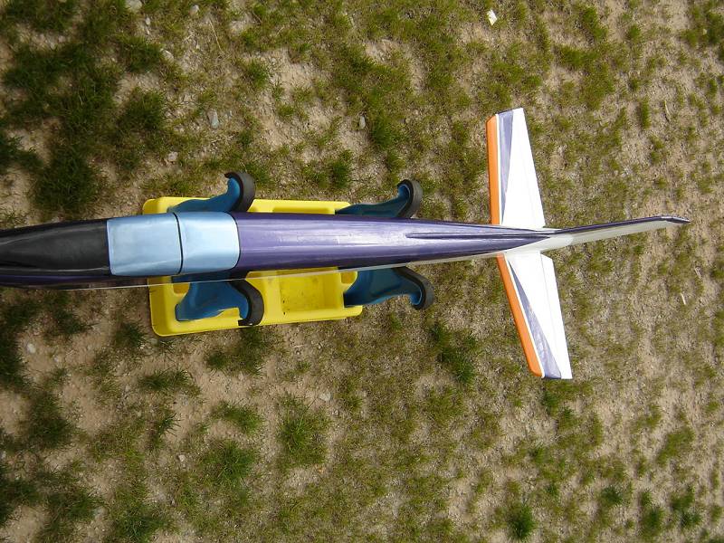

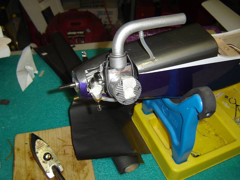

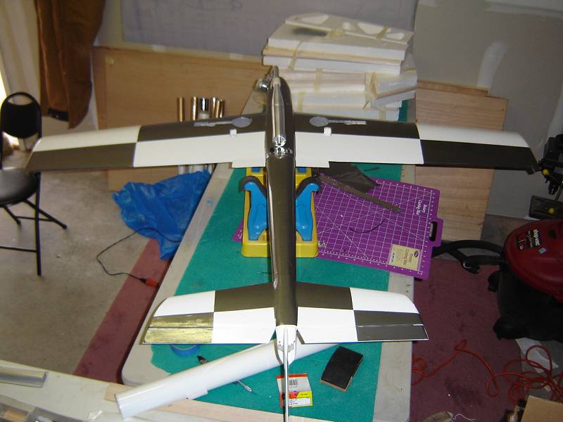

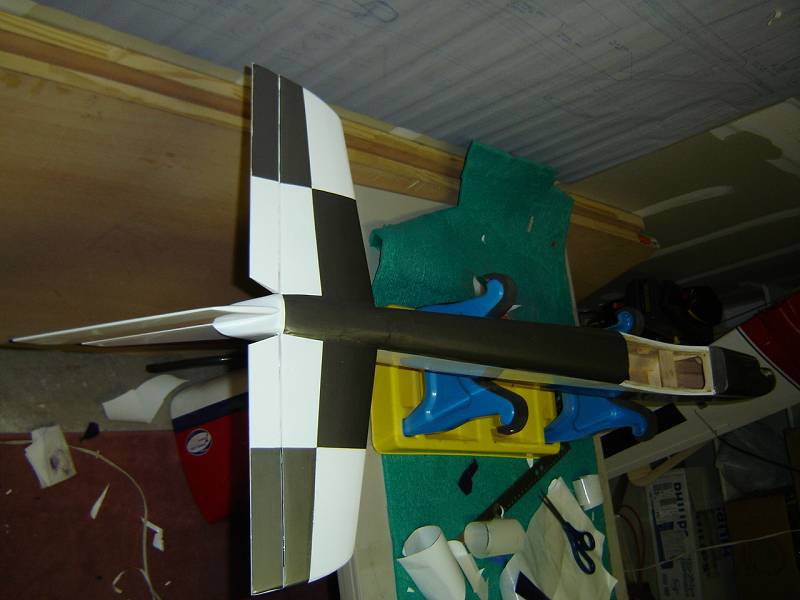

Worked for 6 hours today and got the entire fuselage covered. Not the best job I've done, but for a fun ballistic ship with a questionable life span, I'm satisfied.
Colors are Metallic Plum Monokote, Orange Monokote, Platinum Monokote and White Ultracote. The canopy is Pearl Blue Monokote. That canopy area was like covering a football!!! Next I'll cover the wing and proceed with the home stretch!

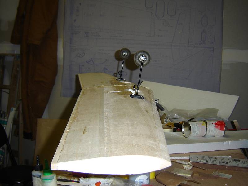

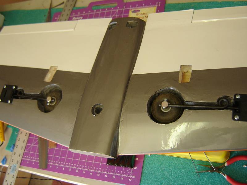

Got the wing covering finished and put the retracts back in. Also did the throttle hookup. All that's left are the aileron servos and a few small things. Getting close!

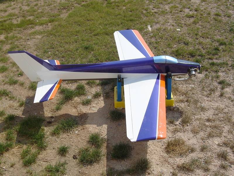

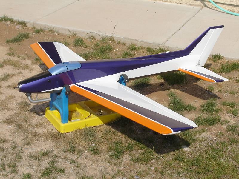

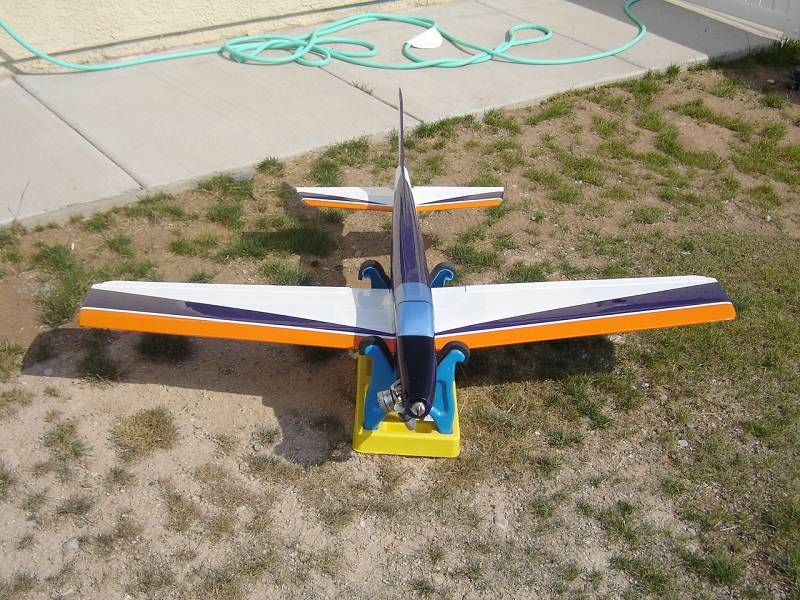

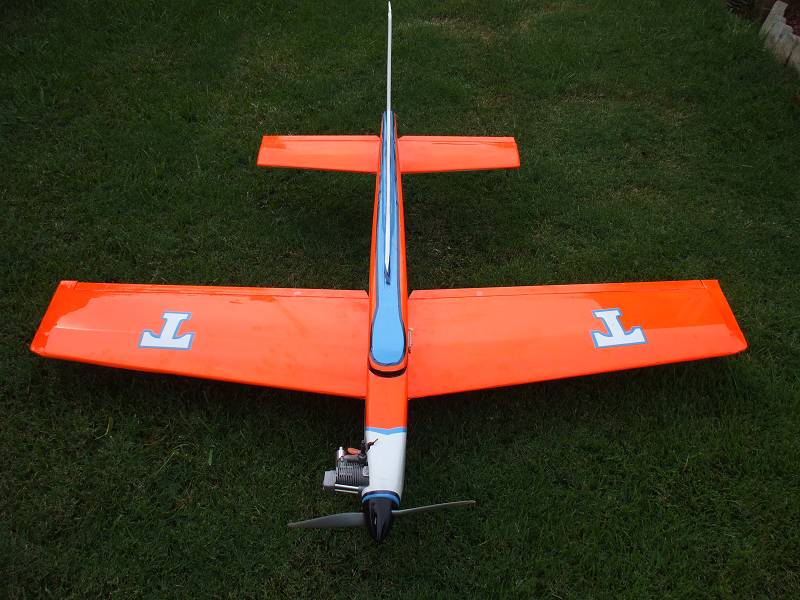

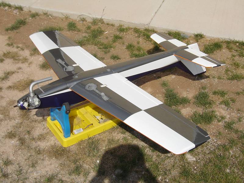

Thought I would share with you the results of my efforts on a Troublemaker also. Decided to make mine with tricycle gear and fixed since I am in SPA and will be competeing there. A lot of them were not pqarticularly impressed that the Intruder ARF was orange but since I am a Tennessee fan you can understand the trim scheme. I would like to say it came in at 7 pounds 9 onces with a Magnum 91 as the engine of choice.
Jack
SPA 306
