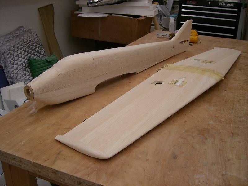

I've mentioned several times in others posts I was working on a Curare from MAN plans so I decided I should give you all a look.
I thinned the airfoil to a 13%. I want it to go fast. I also widen the fuse to accomdate a Kraft 16 oz. tank since I have a Jett Fire 90 for it.
Has flaps per the MAN plans. Worked great on my last one in the 70's!
Doing the landing gear currently.
I plan to fiberglass the whole thing. I made it from contest balsa so it is very light.
I will post a few more pictures soon.
I am really looking forward to flying it. I loved my first one back in the 70's.
Jeff

Looks great!
Are you using an MK bellcrank?

Nice work and keep the post coming. What is that below and in front of the horizontal stab opening?

As mentioned above...That looks like you are using the MK Bell Crank assy(or similar)?? If so I'd like to defiantly hear how that works out...

was wondering if you built in a bit of a tunnel on the other side of the fuselage to partially accomodate the pipe .... or if you were going to just run the pipe along the fuselage side (stock shape)

Yes, I am using an MK bell crank. I did not want to run individual pushrods. The MK may be messier aero wise, but I will have enough power to overcome that for sure.
I did not create a tunnel. I didn't use one on my last one and it was a fine flyer, so felt no need for the extra work.

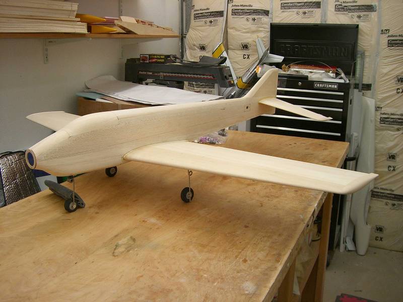

Here are the additional pictures I promised.
Note the unique steering solution. Small strong servos make this possible.
You can also see the plywood insert in the fuse for the MK bellcrank.
Have mounted the stab and the retracts.
All the block in the nose and elsewhere fully hogged out for lightness.
Jeff

You do know that you have the nose gear in backwards don't you? The coil should close when deflected backward. Beautiful work. Dwayne

the retracts that you are using are spring air?? what series are they ??
are they 90 degree angle?
