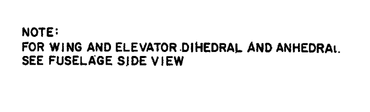

The XLT plans aren't of much help. There's this one little note.
The DB and UFO definitely have dihedral to the top surface of the wings. The Kaos series was flat on the top with dihedral created by the airfoil taper on the bottom.
Looking at the XLT plans again, the bottom of the wing tip is even with the center line of the wing root. The top of the stab tip is even with the bottom of the stab root. See my pics above and that much will be clear.
