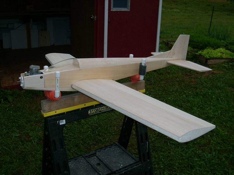

Pics of the styrofoam fuselage with the 1/8" plywood covering. It looks like the Evolution .61 will fit if I change the 1/2" balsa nose cheek blocks to 1/4" material to gain the 1/2" needed for clearance. Looks like I'll have to lenghten the nose some also.

That's a unique model. It's interesting that foam fuselages never caught on back then. Today there are hundreds of lekkies made entirely of molded foam.

The fuselage is very strong and seems fairly light too. It is a tight fit, but I've got the .61 mounted. I ended up modifying an adjustable nylon mount and am making the nose 5/8" longer to meet the back of the spinner.

The the bottom nose block extended 5/8",formers and sringers installed for the turtle deck, and the vertical stab assembled and installed. This is turning out to be a nice quick build!

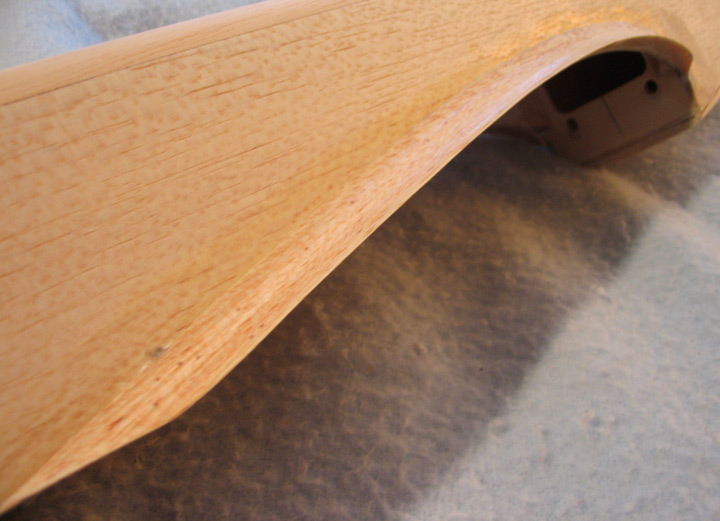

rainedave's Avatar
Joined: Jul 2005
Posts: 6,344
From: Richmond, VA
Default RE: Styrocraft Challenger#2 Build thread
Tim, the key is an X-Acto "router" blade. Cut the fairings out of 3/4" soft balsa sheet using the wing saddle as the template, making the pieces about 1/2" to 3/4" wide. Glue them onto the fuselage sides flush with the saddle. Then, use the router bit to carve out the fairings to create a concave shape. Put some masking tape on the fuselage sides so you don't gouge them and sand the fairings smooth. Then, paint on some finishing resin to harden them.

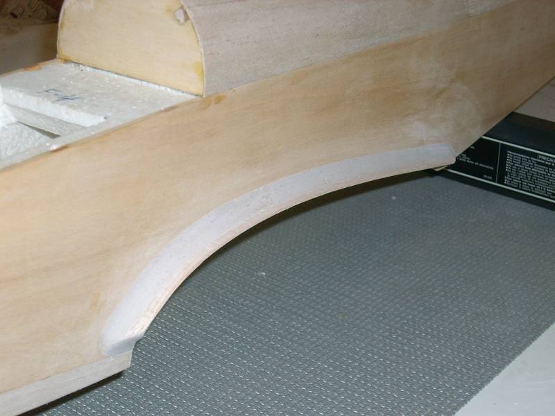

Old 06-22-2007 | 01:21 PM
propbuster's Avatar
Joined: Oct 2003
Posts: 1,116
From: Black Mtn, NC
Wing halves epoxied together with two plywood spars inside and landing gear mounted. Need to final fill and sand with 220 and dry fit the ailerons and hinges. I decided to just use Monokote for a finish as it'll be faster and I want to complete this bird in time for the SPA event here in Asheville next month. Need to pick up some more hinges and also a 2 3/4" spinner from the LHS as it seems the biggest one I have is 2 1/2" and it's too small. Also, some balsa stock for the fairings and look for a router blade

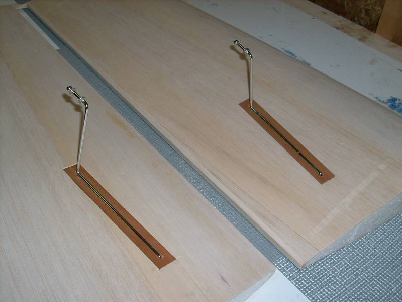

Old 07-06-2007 | 11:06 PM
propbuster's Avatar
Joined: Oct 2003
Posts: 1,116
From: Black Mtn, NC
Well, House guest gone, and I have my shop back! I've been unsuccessful in my search for a router blade to carve wood wing fillets. I've looked everywhere around town and there just isn't one to be had. Speaking with my Dad, he mentioned he's used plumber's epoxy putty in the past with good results and I found this similar product at Home Depot and will give it a try. There was a large gap between the wing and the precut bottom fuselage block and I originally thought I'd take care of it with the fillets. Turns out, that you need that clearance to get the wing on and off ( I should have seen that before!) Bad design in my opinion! I decided to fix that by cutting the fuselage bottom block off and shaping it to attach to the wing itself. I re-shaped the bottom of the fuse a little and now it's a better fit and the fillets will work out nicer. I'll attach the horz stab in the morning and see how the epoxy putty fillets work out for both the wing and the stab.

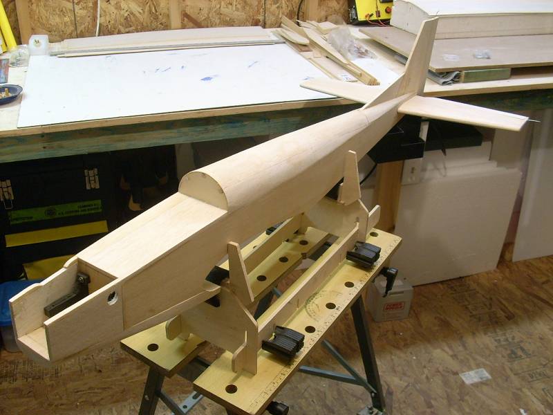

Old 07-09-2007 | 11:07 AM
propbuster's Avatar
Joined: Oct 2003
Posts: 1,116
From: Black Mtn, NC

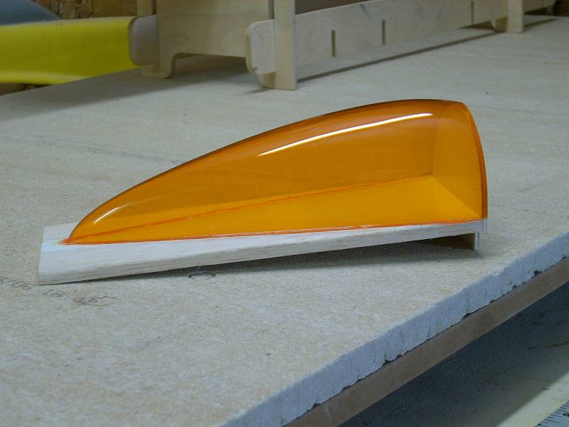

I installed the horz stab and while waiting on the epoxy to set up I worked on the Canopy/hatch. I cut a slightly smaller diameter turtle deck former with a tab on the bottom and attached that to the fuse top that covers the fuel tank. Cut and trimmed the canopy to fit and epoxied it to the "hatch" after painting the inside of it white to highlight the orange tint. A nylon bolt and blind nut will hold it secure from inside of the fuse.
