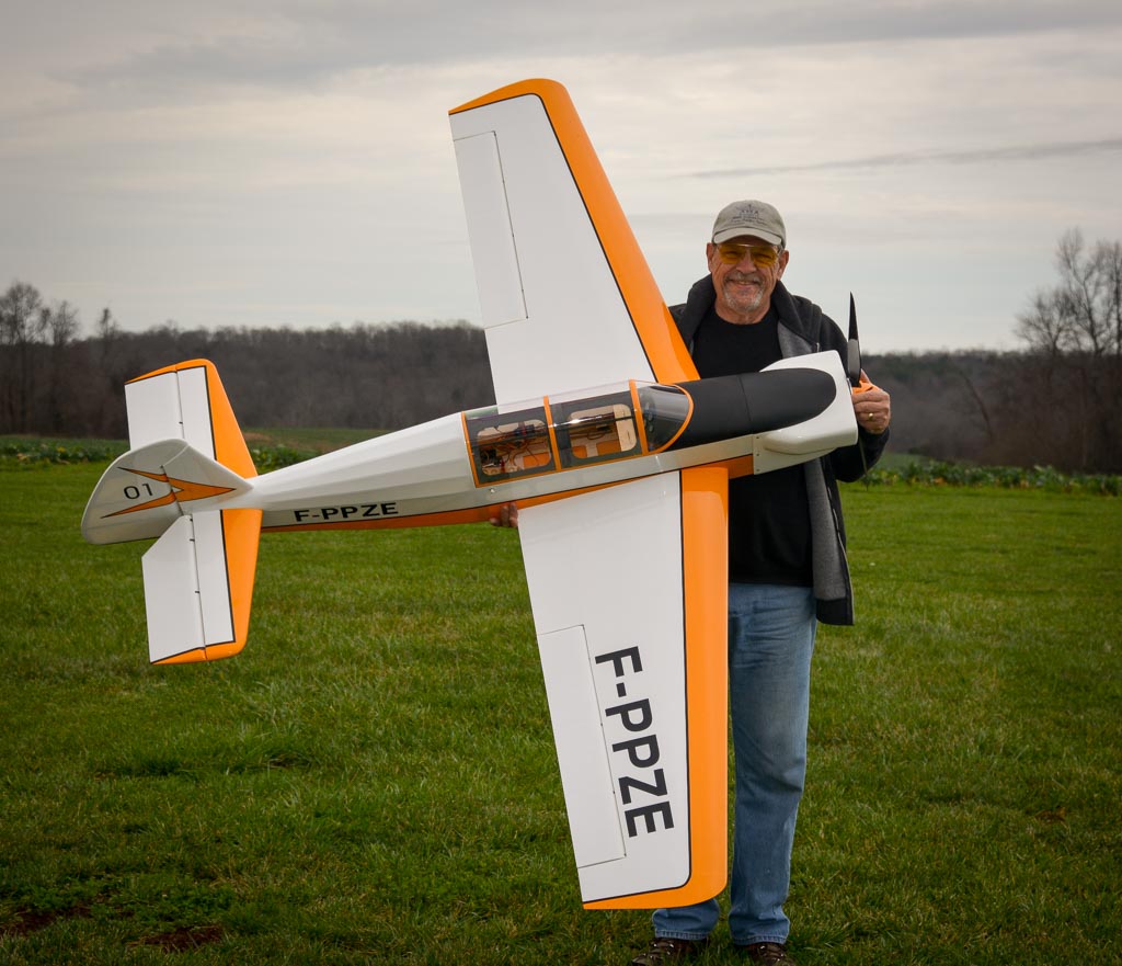

Here is a quick shot of my 91" electric Dalotel. Did my own plans, parts were laser cut by J-Tec. Everything is built-up and the cowl is glass. HK retracts and GA6000.8 motor on 12 cells. It flies FANTASTIC! Love it when the wheels go up just like the old days of pattern

Very nice! I like the idea of a glass cowl.Did you use the lost foam method?

I actually made a wood cowl with laser-cut parts and turned that into a plug, made a mold from that and then the actual cowl. The canopy is actually petg sheet and easy to do. This airplane is SO much fun to fly and it looks GREAT in the air.

Looks great! How about more photos and details. Thanks
