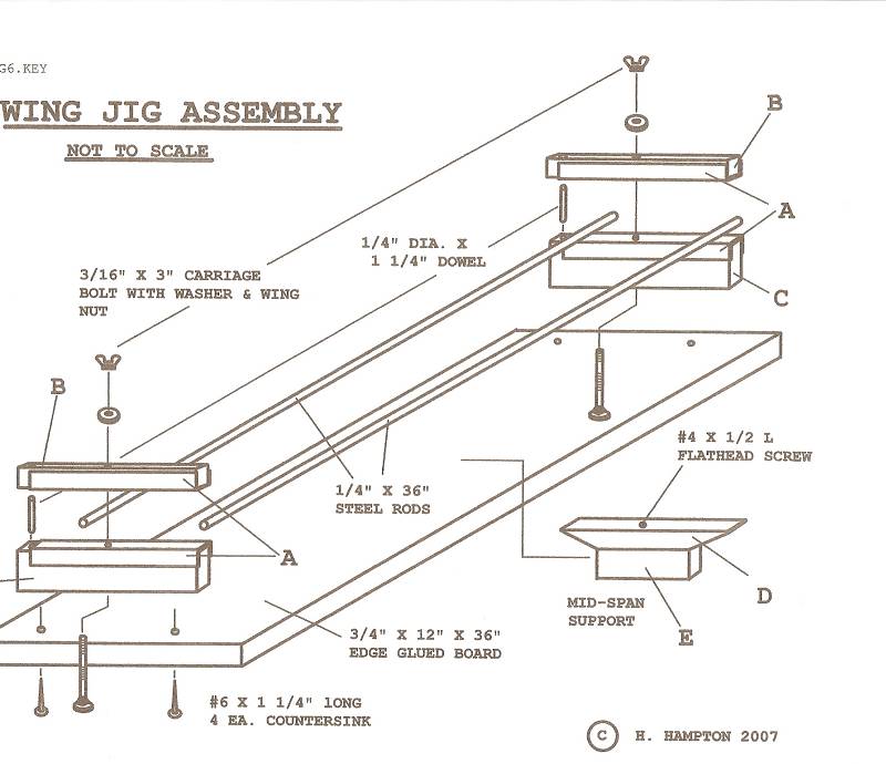

Tim, I've been wanting to use some arrow shafts, not only for push rods, but to make a simple wing jig (based on the RCM/Great Planes type). The problem is that even at discount places like Dick's Sporting Goods they are very expensive. So, I have used the Dave Brown fiberglass ones instead.
David
