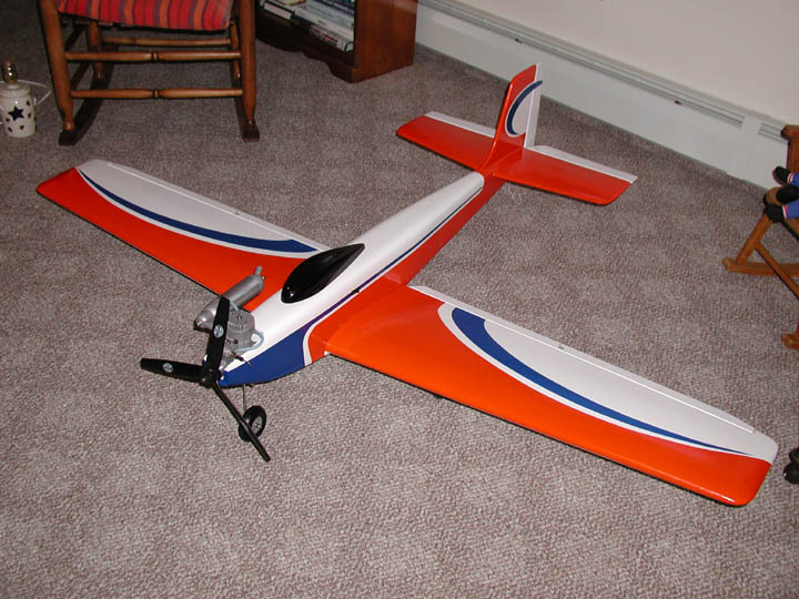

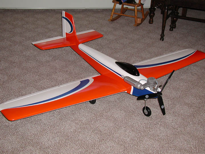

I started building this 6 months ago from a set of the 1968 plans and just finished it today. It's glassed and then painted with Klass-Kote paints. Can't wait to fly it!

Wow, that's beautiful! It's great to see a well executed painted finish. I understand the SK's are timed to turn big props at low rpms. What prop do you have on it?

I broke it in with the recommended 15x6 but that prop had about a half inch of ground clearance so I went with a 14x7 3 -blade. I haven't run it with that prop yet but I'm hoping it works out. Always open for suggestions though!

It flies great! I took it out this afternoon for its maiden flight and it flew like it was on rails. I had what I think is a fuel draw problem that caused the engine to cut out for a second or two, 2 or 3 times every circuit but the SK never quit on me and made lots of power when it got fuel. Can anybody tell me how an engine would run if the fuel tank was too low in relation to the carb? Would it show up as an intermittant problem or would it be a constant symptom? I'm wondering if that's my problem or if it's a problem with foaming in the tank due to vibration, there's no padding between the tank and the wood engine bearers that run through the tank compartment.
Another problem was that the plane would pitch up every time the engine lost power, is that an indication of too much down thrust in the engine setup or is it an incidence thing?
I think it will be a real winner once the problems are figured out, I'm really happy with the SK .90 and I was surprised how fast the plane was.

I'm not sure if foaming was my problem anymore, I made room for 1/4" of foam around the tank and put a felt clunk in it and those changes made absolutely no difference at all. I'm thinking now that it may be some type of interference or radio problem within the plane. Whatever is happening affects both the throttle and elevator channels at the same time and only lasts for a few seconds. Aileron and rudder channels never seem to be affected. I did another range check last night with the engine running and had no problems and the engine runs great on the ground, no bubbles in the lines or anything like that. I guess my first move will be to try a different receiver even though the one in it is a brand new Futaba. Frustrating!

I found my problem- it was a bad receiver. It had a brand-new Futaba but after replacing it with an Airtronics receiver last night, I flew it this morning with no problems at all.
