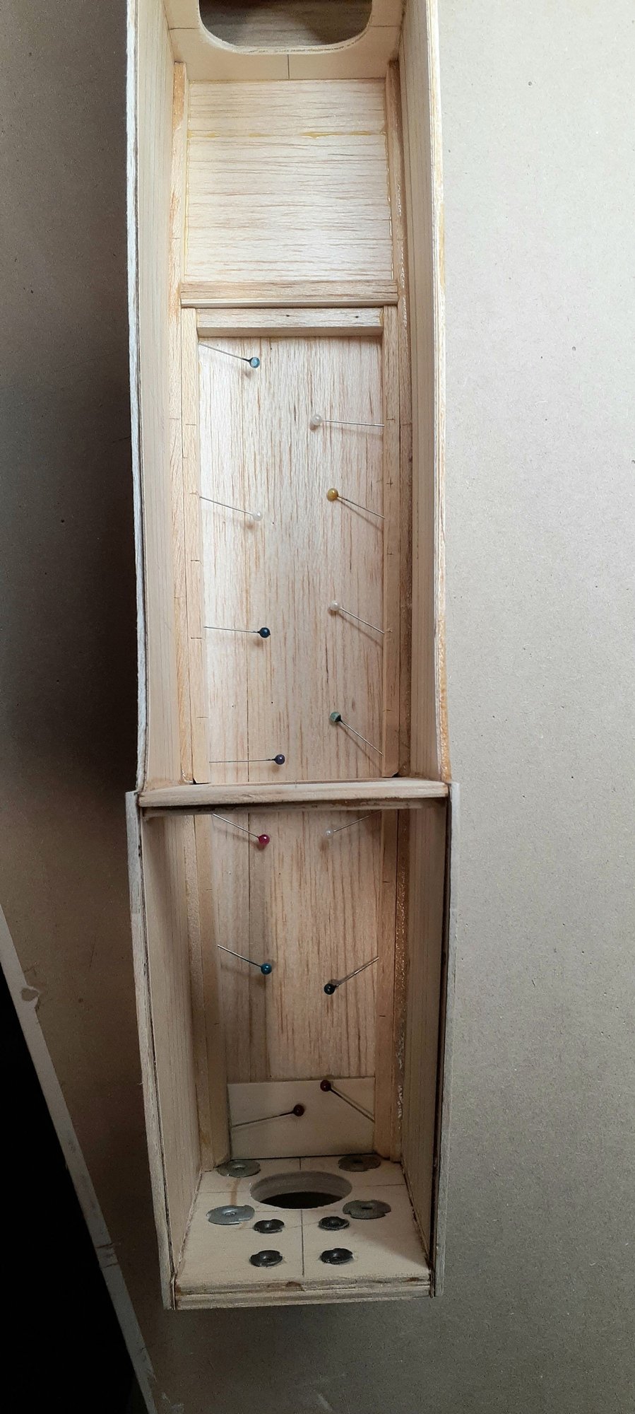

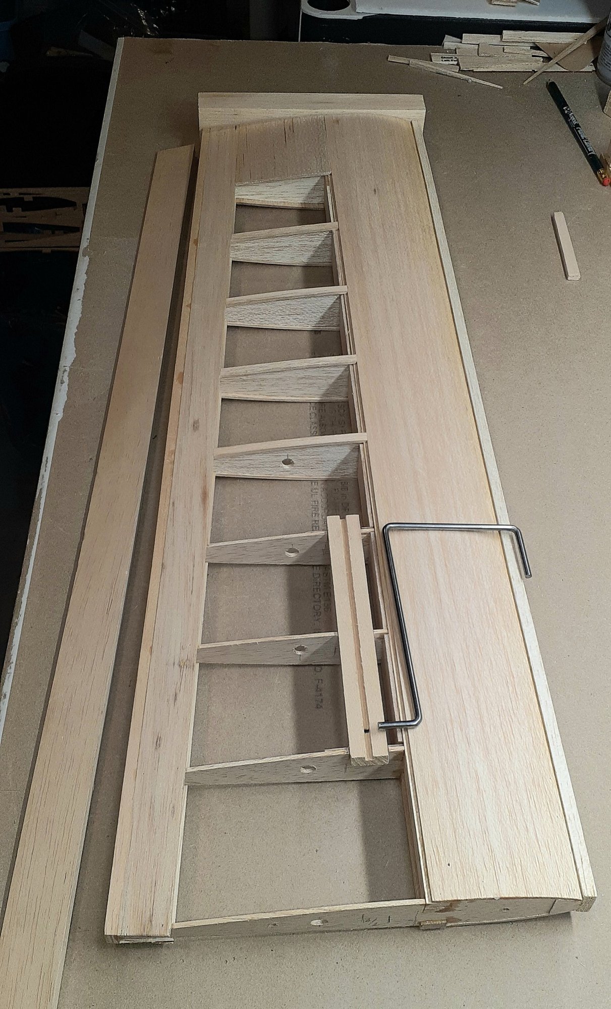

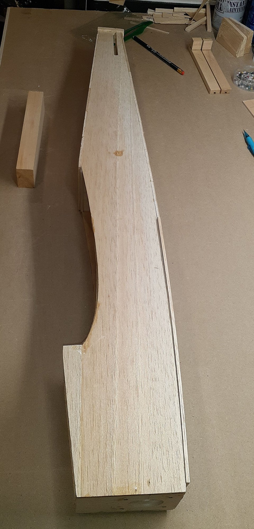

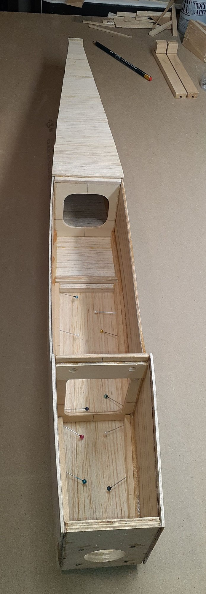

I am finally having a clubmate build my Kiwi and it will have electric power. Interestingly, it will have a top hatch extending from the firewall to almost the beginning of the dorsal fin and a 3D printed cowl.
The planned setup to keep the plane light will be a Power 32, 3700 4s, 65 amp ESC. Using HS-225MG Mighty Mini. It is being build so that it can be upgraded to a Power 46 motor on 5000 5s or Rimfire 46 motor if I am tempted later. But I suspect, I will stay with the P32.
A few photos here.
