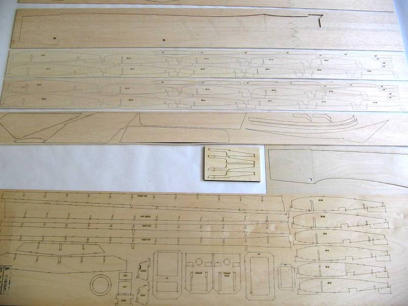

OK Guys, I've been contacted by several people about when Tom Brett's Perigee kit will be available from Early RC and how will it compare to the original. Well just received the prototype laser cutting today and as promised will start this build thread showing how it compares to the original. I must confess that I have an original DeBolt kit and am quite surprised with the poor quality of wood and die-cutting. It must have been one of the last kits made because most of the Demeco kits were quite good.
Now Dan at Early RC Models does not have any kits yet because I will build this kit, make any changes observed to plans and laser cutting, comprise an assembly manual, finalize the plans then turn it over to him. He is comprising a waiting list for a run as soon as I finish this build so if you want one or may be interested in a full kit give him a call and get on the list. I am not sure if he will be keeping kits in stock or will make small production runs as needed.
Anyway, here are some pictures of the laser parts as I got them out of the box. NOTE: The fuselage sides on this prototype show a zig-zag joint at the rear. This was requested by me to get a kit in house and started sooner instead of waiting on a balsa order. The final kit will have a one piece fuselage. Now note the 2 piece shown below is from the original kit. Look closely and you can see the saw marks in the balsa!!
The large plywood sheet show has the main wing ribs for the wing at landing gear location, and the 3/32 plywood wing spars. The original had 3/32 BALSA spars. The only crash I witnessed on a Perigee was a wing folding at the bottom of a loop!.
Keep tuned in as I hope to post build pictures of this model. Please let me know if you have any questions as we go along.

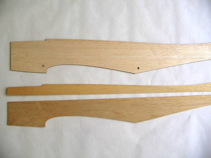

Well, William the zig-zag joint I mentioned shows up only on my prototype fuselage sides pictured. Instead of waiting for a full sheet I just pieced one up for the prototype build. As for being tail heavy that is a good possibility as many of the older models had the heavier gear. I do share your thoughts on the airfoil design. The original kit, if built per the die-cutting can put positive ( as much as 2 degrees below rib centerline at rear) washout on the wing. This may account for some of the notorious snaps mentioned on landings.
I am leaning toward a OS 32 for power on this prototype but have a K&B Greenhead 45 stored away for my personal model for the VRCS. Much too fast for my reed system (my thumbs!!) but may put one of my older systems in it for nostalgic purposes!
I too have redesigned quite a bit on this model mostly to be easier for the average modeler to build as well as to decrease the overall weight of the finished model. The spars on my design are 3/32 plywood. Unfortunately Hal used balsa spars in many of his designs back then. This brought on the reputation of his designs having weak wings. When I redesigned the Champ for early RC a few years before his death I also went with plywood spars. Hal thought this was a good idea. Even though he had never experienced a wing failure on any of his prototypes.
I agree the original nose gear arrangement was a bit strange and cumbersome. Show in this picture is the modification made to use a standard Sig nose gear assembly but located in the original position. The mounting block is laser cut for quick assembly. Not show here but on the final plans is just mounting the nose gear conventionally. Easier and less time consuming. I also placed the original nose gear from the kit. I believe it was a Tatone product.
Again I welcome any comments on this build. I am not sure how well the Perigee will sell for Early RC. I just enjoy doing the design work on some of the vintage models for them. I agree it was not the most popular design for that era and had a bad reputation for slow speed handling. I personally liked the overall looks and hopefully have tamed some of her wild habits for todays fliers!

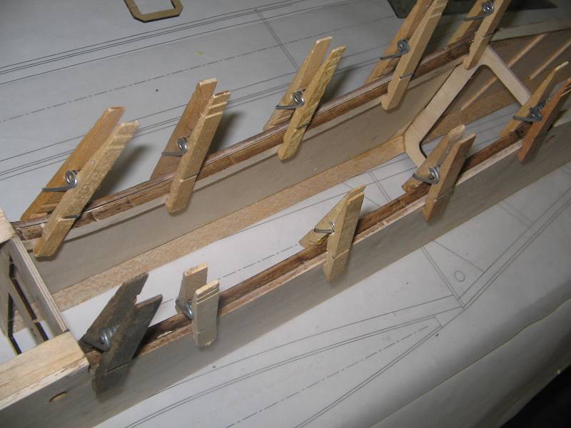

OK, added all the top and bottom sheeting as well as the nose blocks. Now it is time for some carving and sanding. NOTE: I added the 1/16 plywood nose ring to insure that I get the taper for the spinner correct. I place my dummy engine in this case an old OS .32 crankcase with spinner mounted. I space out 1/16 from back of spinner and glued into place.
I included the 2 degrees of right thrust as per the original. The kit is supplied with 2 each 1/4 hard plywood engine beams that are glued toghether to make a 1/2 inch engine beam. These are designed to give 0 degree offsett but can be adjusted for the 2 degrees I installed.
Top fuselage sheeting is 1/4 balsa run perpendicular to the fuselage sides for strength. The bottom sheeting 3/32. Feels a little heavy but I have a lot of balsa to remove. I still like the fiberglass cowl idea. I will tell you how much more I like it after all this shaping!!!!

OK guys, I've kind of backed off the Perigee build because its been over 100 degrees in the shop lately. Us fat boys tend to sweat!! Well, I got out this morning and did some rough sanding on the fuselage. Here are the pics. Notice the nose gear is at the original location as per the original.
I have not finished carving our the engine area as I've not quite decided on a power plant. I had been leaning toward the OS 32 but have a older OS 40FSR that I may use. Boy there is a lot of sanding to get her to this point and some more needed to get her to final stages. I elected not to use the vacumn formed cowl top and filled it with balsa. Most likely Dan will offer it with the cover as he will pull from my original. Now to the tail......
Bob Harris

I thought Toms original had a F/glass engine - tank cowl top piece? The AAM photos show one so it wouldn't be out of place to make one...
Evan.
Old 08-20-2007, 04:20 AM
RFJ
RFJ's Avatar
Join Date: Apr 2005
Location: Belfast, IRELAND
Posts: 1,136
Default RE: PERIGEE Prototype Kit Build
The tank hatch was balsa but the little hatch around the engine itself was f/glass. These scans from the Perigee plan/article in January/February 1963 American Modeler hopefully show Tom's original set up.
Ray
