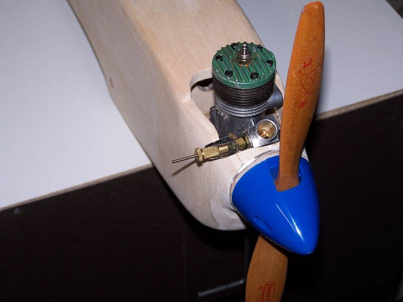

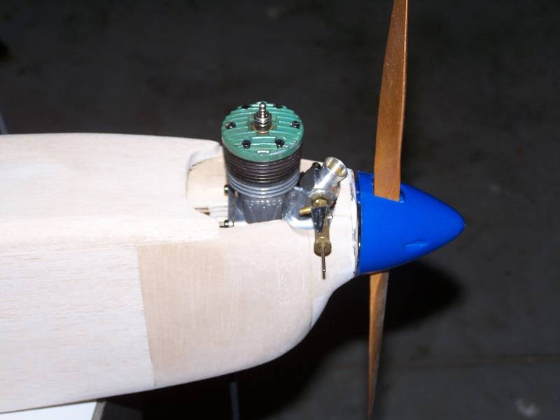

OK, I've finished up the plans and laser cut parts list and will be sending Dan everything in the next few weeks. I was thinking about how to finish up the nose as to the hatch and such. I've been watching Nic's (WEDJ) build and had decided to use the dowel design like the original even though his ply blade alternative is great!! (I may change my mind!).
I had planned and had fitted the OS .32 in the nose because my K&B GreenHead .45 was just too worn out to be reliable. (Bad E-Bay purchase you know it was listed: Great compression, like new.... DUH!!) Anyway just in time for Christmas an unmarked packaged arrived from a very kind soul!! Look!! a NEW IN BOX K&B Greenhead!!!! Yes Virginia there is a Santa Claus!!!
Now I need to do some more finish work to the hatch and nose before starting prep for painting but I am tickled to death that I will be able to have a period engine for it. I have an old peace pipe muffler I will modify for the K&B. Next is the 2 inch Veco spinner. I may have a lead on one NIB also!!
