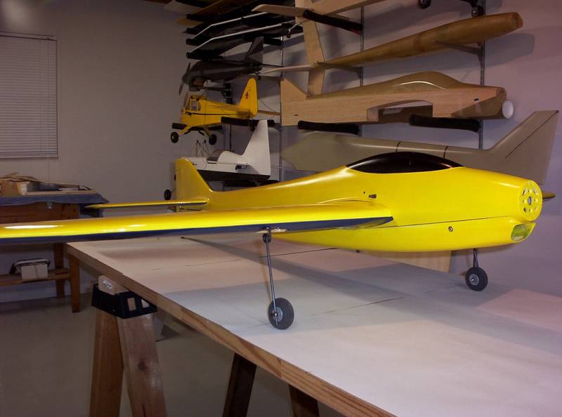

Alright!!!! Here we go...I'm very excited to have acquired a Super Nice example of an Atlanta!!!! Wow...One of my two dream Aircraft!! I'm sooo stoked!! Thanks smw for taking such good care of her!!
I'm not going to be able to fly her anytime soon though... [sm=cry_smile.gif]
Gotta make some Good Use of her first...
Those of you who are interested in the Atlanta...Just sit tight a bit...OK... [sm=confused.gif]
Have Fun...
Chuck
You're making molds aren't you?
There's a few hot looking planes in the background there... looks like a Desire and something else up on those racks.

ORIGINAL: stiletto660
Yes Sir...
Thank You!! Good Eye!!
Top to bottom: Calypso, Conquest IV, Desire, Prophecy
Only problem: They are all sooo close...But still on that "To Do" rack...he he
Have Fun...
Chuck

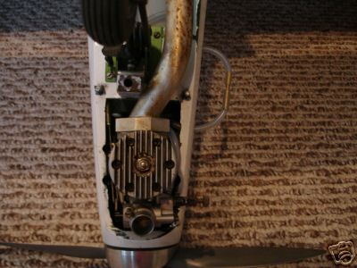

Will actually use a Rear Exhaust engine mounted inverted so the pipe will run down the tunnel...When setting up as a Tricycle gear(as it should be..he he)...I think the nose retract will be slightly scooted off center just a tad and you will use a header which will hook around it...(see photos below) (note: These are just pics I've collected...I think some are of Nathans airplane...I'm not sure who's that Blue and yellow one is)
It is indeed an Atlanta 60..."Back in the day" I have read the engine of choice was the YS 60...That was apparently a sweet set-up as I understand...I'll more than likely be running an OS 61 RF-P or a YS 61LS in mine...Not sure just yet...

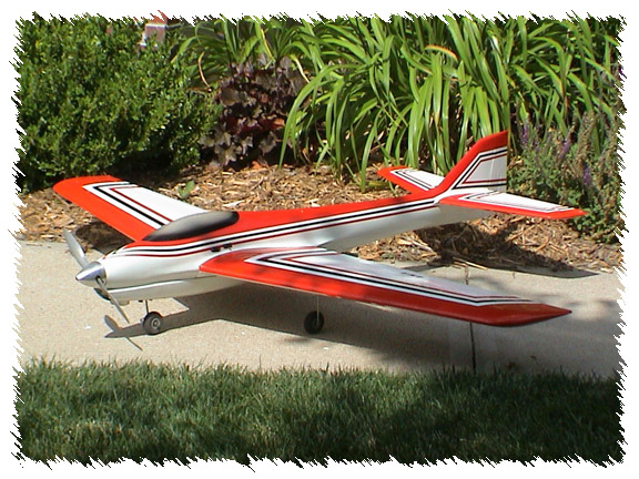

Take your time, I'm a patient guy. It's wise of you to do the extra work to get the molds AND the airplane.
Yeah, I was going to mention, a rear exhaust mounted inverted with the pipe down the tunnel is the way to go. That way the engine doesn't spoil her good looks. There's a fiberglass piece that runs down the top center of the wing making the top of the pipe tunnel. A "clip" is then installed so that the pipe can be secured to the wing once the wing is screwed into the fuselage.
EDIT: LMAO, those pictures in the above post look remarkably like my airplane!! Anyway, you can see what I'm talking about.
PS: She's kept a lot cleaner now!! (still has the same engine). Shame on you! I'll have to get you some more recent pics. Showing her all filthy like that, no excuse! You should be ashamed! [sm=spinnyeyes.gif]

That sure is a pretty Airplane Nathan...
I think the "Stance" is Awesome on the tricycle gear...That is the way it should be!! I've already done away with the tail wheel assy on that one I got...I will defiantly be moving the gear in the wings before she goes back together...
Actually...Could you take some good detail shots of the nose area of your airplane for me?? The engine compartment of this one has been modified and I'd like see yours so I can restore this one accurately...I think I have a pretty good idea...But seeing some decent pics would defiantly help...I cant get too much off the drawing....No Hurry...Just whenever...Thanks...

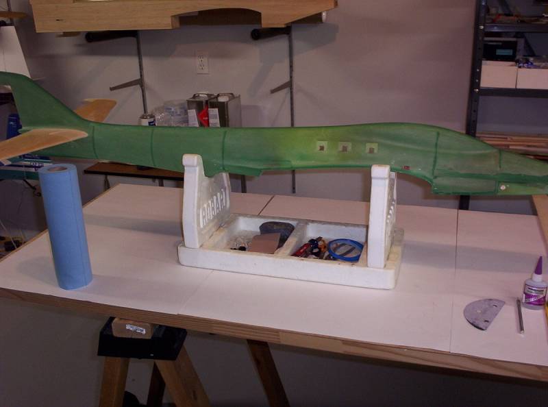

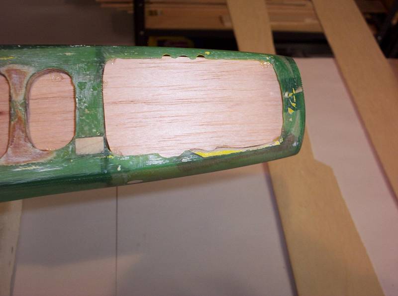

Well..As usual...Going a little slower than I had hoped...But...At least there is progress...
Still hope to have some tools complete and shipped out by X-Mas... [sm=tongue_smile.gif]
Anyhow..Here are some shots of the ole girl in all her glory (neked..he he)...Filling in the open holes...Then some of starting to set up the split lines...
Hope to be laying up soon...I'll post more pics when there is better progress...
Have Fun...
Chuck
