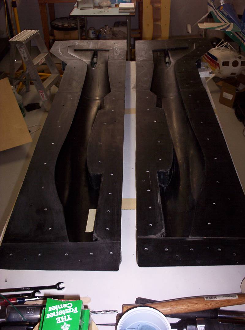

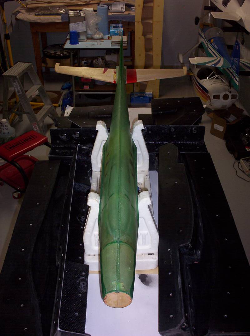

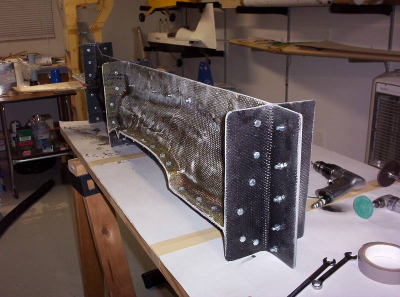

Well it's been a little long time coming...But the Atlanta project reached a semi significant milestone yesterday and I thought I'd revive this thread...
Three reasons it's taken so long:
1) Moldmaking takes a long time...
2) I'm slow...
3) I was slow to get started...
My Atlanta has been encased in fiberglass for quite a while now...Finally it's free from those constraints and ready to make it's way to the sky...
I'm pleased My Baby made it through the process unscathed!! I'm Very Happy about that!!
Here are a few highlight photos and I'll add a few more later...There is more information in this composites forum thread for those interested in seeing the process to date:
http://www.rcuniverse.com/forum/m_6827800/tm.htm
There is still a lot of work to be done...This is just the first step (a transfer)...But it's a pretty big one so I'm pleased... [8D]

Thanks for the Comments Guys!!
These are really not the real "molds" in the pictures...They are just a temporary version which I made in several pieces so I could reduce some stress while de-molding from my Atlanta...I feared if I did them in two pieces I was really going to risk damaging or destroying my original airplane...By splitting them up in several sections I was able to work around some tight spots which would have probably hung due to "backdraft"...I also made them pretty light weight so they would "give a little" to reduce some stress as well...Technically these are called a "Splash" or a "Transfer"...
Using this transfer I will make a dummy Atlanta (Master Model)...It will be a thick, heavy, sturdy mock-up of the Atlanta fuselage...Then I will do some finish type work to that master model to clean it up a little...I wanna clean up the belly pan/fuselage fit as the factory airplane is sorta crude looking...Then there are some other little details I wanna clean up too...Once I get the Master Model slicked up I'll move on to making the "Real Molds"...
Dave..I'm making a set of molds (for me) that I will design for vacuum bagging...I will join my halves separately after they have cured...I'm also making a second set of molds which will be designed for joining the halves while wet...Those will have some cutouts and access to the inside of the fuse so a guy can work on the seem with some special long reach tools and lots of patience...
No reason you couldn't vacuum bag with the other tools if you were to use an "envelope bag" which will only require a little more bagging material... [8D]
Hey Dave..Thanks for mentioning the Strega...I looked up that thread and was amazed!! Super clean and neat stuff that guy is doing...What a craftsman that fellow is!!
Seems he's using allot of CNC stuff which is Really Neat!! Boy..I'd like to check into that some day...He's got it goin' on!! Very Fast too!!
I'm all slow, crude and Old School...
