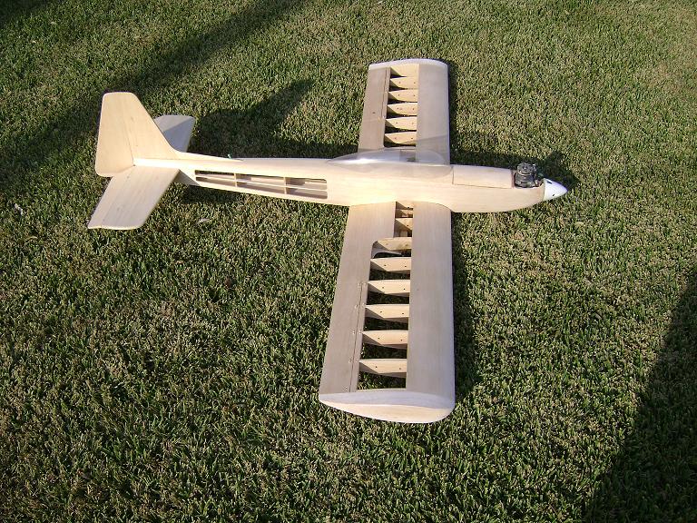

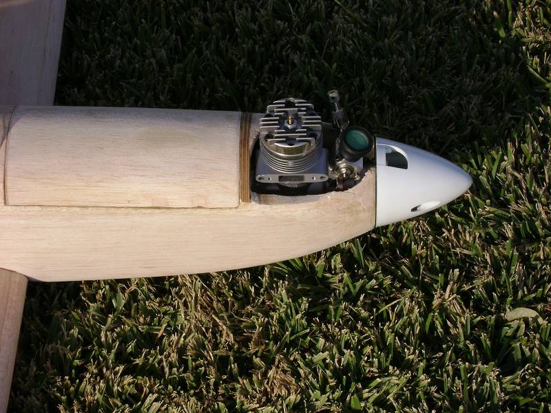

A few years ago when recovering from major back surgery, I drew up some cad plans for Phil Kraft’s Kwik Fli III, based on the plans published in MAN. I started construction at that time but got sidetracked by other projects. An e-mail from a gentleman from Holland, who has started a build thread on a Dutch site. [link]http://www.modelbouwforum.nl/phpBB2/viewtopic.php?t=65978[/link] Has rekindled my interest, and I have re-started construction. I had mounted a Enya SS50 but then I heard good things about the Enya 61CX, very light and powerful, and the size of a 45-50. [link]http://www.enya-engine.com/61CX%20TN_E0.html[/link]

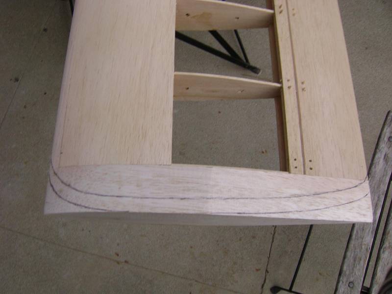

The MAN plans show a span of 58 ½” and that is how I drew the wing in CAD format, but the Grupner kit had a span of about 59 ½” and the Top Flite kit was advertised as 60” I think that they both had thicker tip blocks that made up for the difference. I incorporated the thicker tip blocks on my model 1 ½” as opposed to the 1” shown on the plans. I still need to decide on weather to install wheel brakes, or not and weather to use duel aileron servos, or a bellcrank setup. I need to carve and hollow the tip blocks, and decide on hatch hold down method. I have already gone with a bolt on wing. I am leaning to covering with orange silk with blue trim to match the MAN cover and maybe Klass-Kote clear over all.
Richard Browning
I will post photos soon I just need to shrink them they are to large

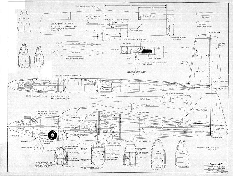

I have seen a photo of Phil Kraft at I think the 1971 world championships, and he was still flying a streight wing Kwik Fli III. If I remember correctly the plane had small wing fillets. I think it also had retracts, I beleve he placed 21st does anyone have a photo of the plane he flew that year? Also in 1970 a much more advanced model the Dragon Fli was published in AAM. It says something that in 1971 he was still compeating with his 1967 design.

The Dragon Fli was published in American Aircraft Modeler in 1970 (Not sure what month) I'll try to find the article but I think he did fly it in contests.

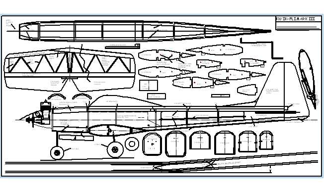

I case anyone is interisted the plans I drew can be downloaded at:
http://plans.rcmodell.hu/plansport.html
Richard

ORIGINAL: tweedy
Richard Browning
Interesting to note the side elevation of the fuse. I think Phil was on to something here . .
Look at the Integral, Osmose, Oxalys, etc. and there is a similarity in the forward canopy, large area on the fuse between the canopy and the stab. just add a chin cowl and thicken up the fuse width through the wing saddle area, and you're pretty much there ! !
I expect it would have been a very nice flying plane . . wing's a bit thick in the tip cord, however reasonably competitive in P07 / F07 perhaps ??
