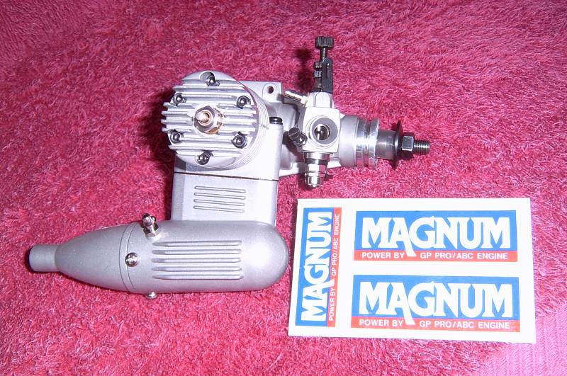

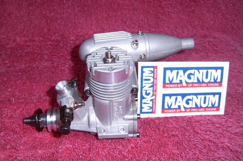

Hi guys, i have this Magnum 25 PRO ABC, and i wonder if it will be a nice engine for a small pattern plane, like a Curare .20, a small tiger tail or another hot plane?. Also i have a 20 size tuned pipe for it...
thanks for the advice

stg61abc,
It should work VERY well. The .25/.28 was the ticket before the .32's hit the market. I still have my OS .25F abc from the 80's. It pulled my Sun-Fli 4-20 around very well with just a muffler. The pipe should be even better.

stg61abc,
I used 8x8, 9x5, or 9x6 props on my 25. I used 10% nitro and stock muffler and liked the 9 x 5 the best. I later found a muffler that had slightly more volume and allowed 900 rpm increase using the same fuel as above. I liked the 9 x 6 after that. The 8 x 8 was for speed applications. It (8x8)would take a little longer to get off the runway, but was noticeable faster in flight and very quiet. I hope you enjoy the 25 as much as I did/do..

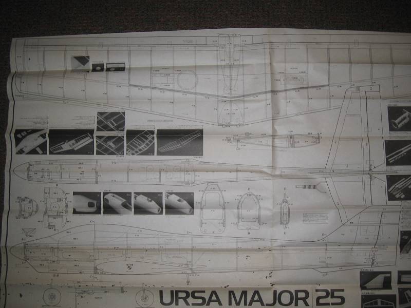

ORIGINAL: stg61abc
That is a very nice motor. I have plans for a sweet looking Ursa Major that runs with a side mounted, side exhaust motor.
